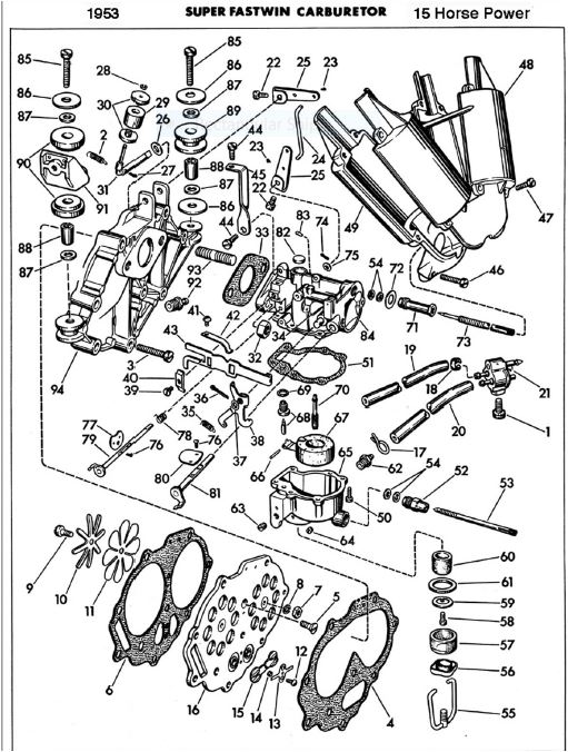

I am having a brain cramp with my 1953 Super Fastwin carb linkage. No matter what I do, I cannot make the throttle butterfly achieve WOT position with the cam follower fully advanced on the cam. The best I can do is about 3/4 throttle.
Can someone who has a Super Fastwin possibly take a pic of your throttle linkage at WOT position? A picture is worth a thousand words. I should have taken some pics of mine while I was messing with it, but got carried away.

November 22, 2016 at 6:16 pm #47824Not having one in front of me, I gotta ask this. The link between the cam follower and carburetor lever–do the two levers have more than one hole in each? I am thinking the link rod goes in the outermost hole in the cam follower lever and the innermost hole in the carburetor lever. At least that is the way I remember it without having one to look at.
November 22, 2016 at 7:53 pm #47827Yes, you are correct. There are two holes in the arm and both arms have the same part number. Having the link in the outer hole on top and the inner hole on the bottom multiplies the action of the throttle cam. If the holes are worn, switch arms. . . π
