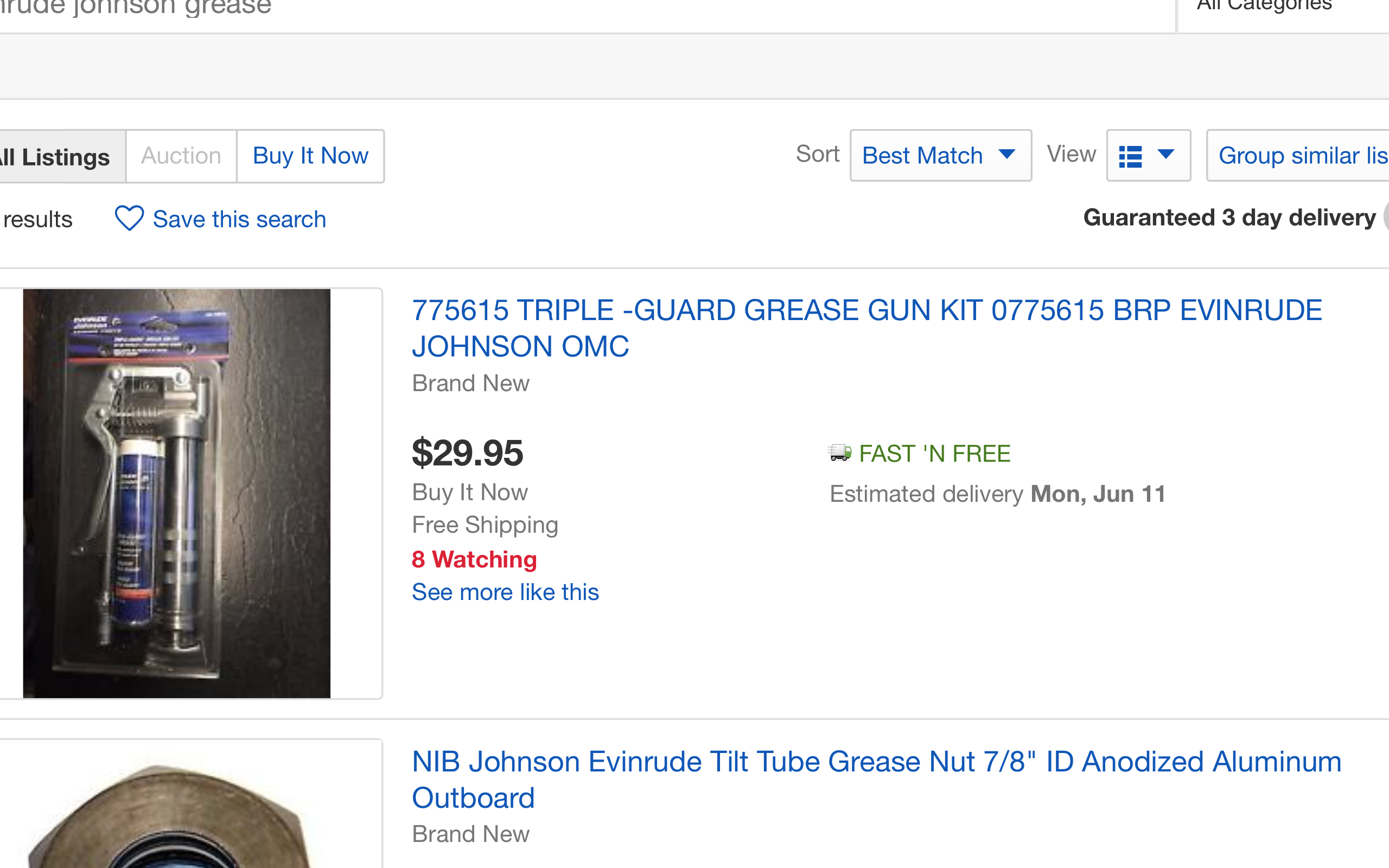

      I have a BRP grease gun that takes 3 oz. tubes of Triple Guard grease.

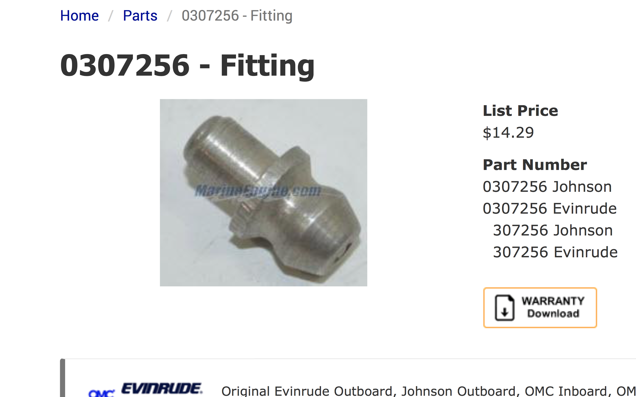

                  #77489
                  nj-boatbuilder57
                    $14.29 for a single zerk?
                    I’m in the wrong line of work!
                    #77511
                    PugetSoundBoater
                      quote NJ-boatbuilder57:
                      Yeah i was surprised when i saw that price. I was able to salvage one from a 9.5 junk motor .I’m glad i kept the remains of that motor. 😀
