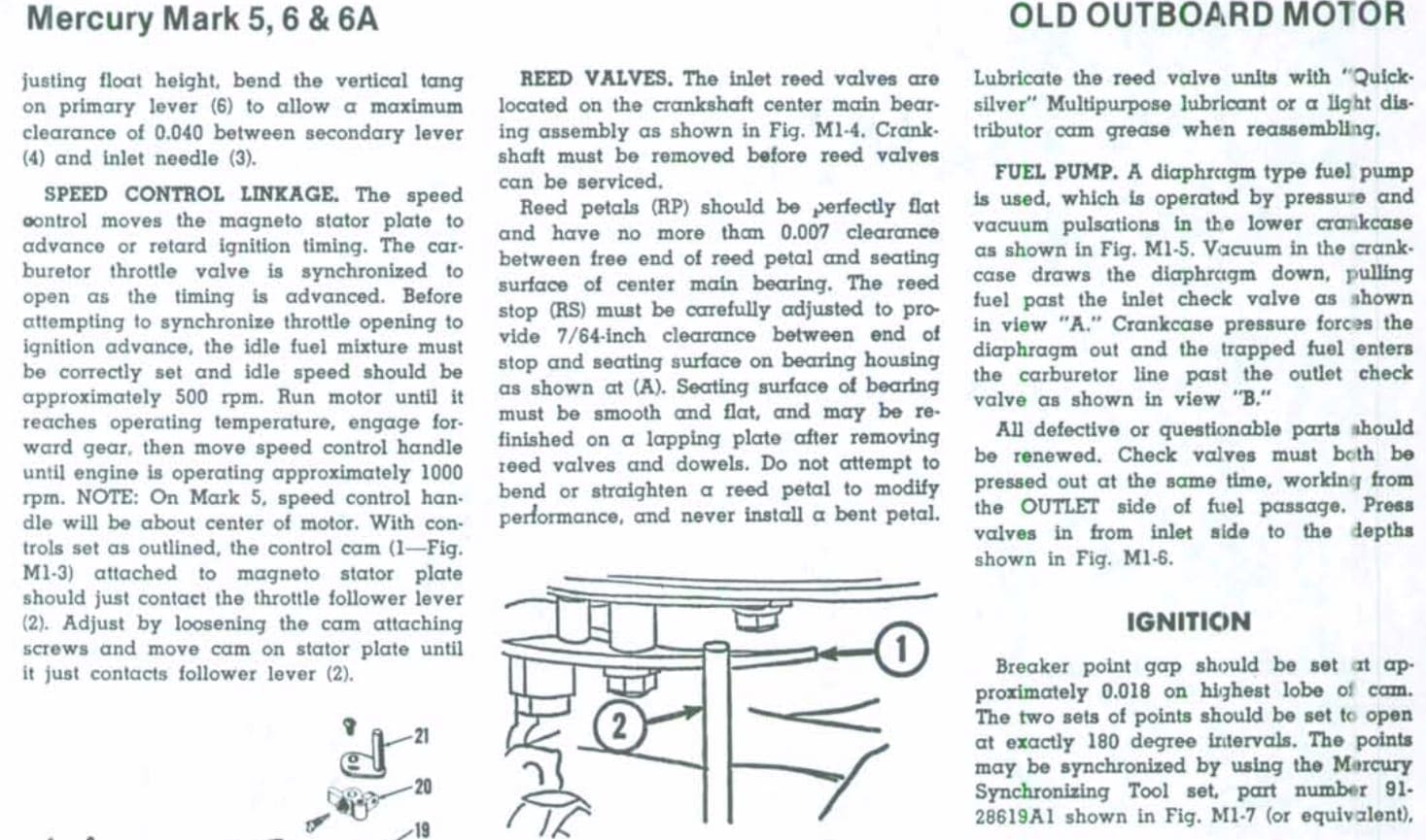

      Any tips to synchronize my Mark 6 would be appreciated. I don’t note any marks on the cam to throttle shaft. I note the small screw on the base of the throttle shaft plate for small adjustment, but just can’t figure out starting spot relationship to throttle setting,cam position and carb..
      Thanks for the help.
      Henry
      #169636
        Here’s some about it from a pdf manual,
        which it would let me upload….. say’s “Too Big”.
