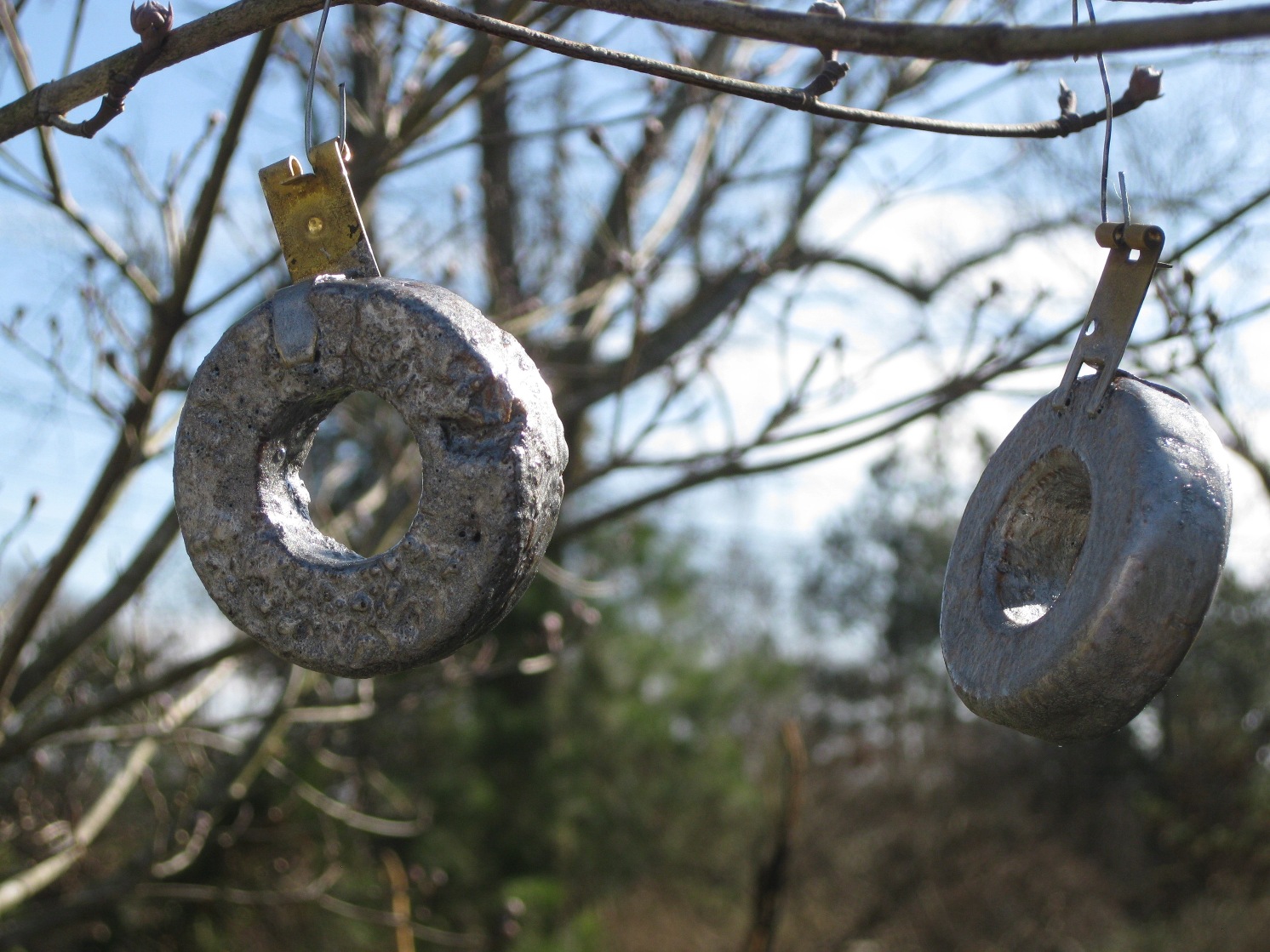

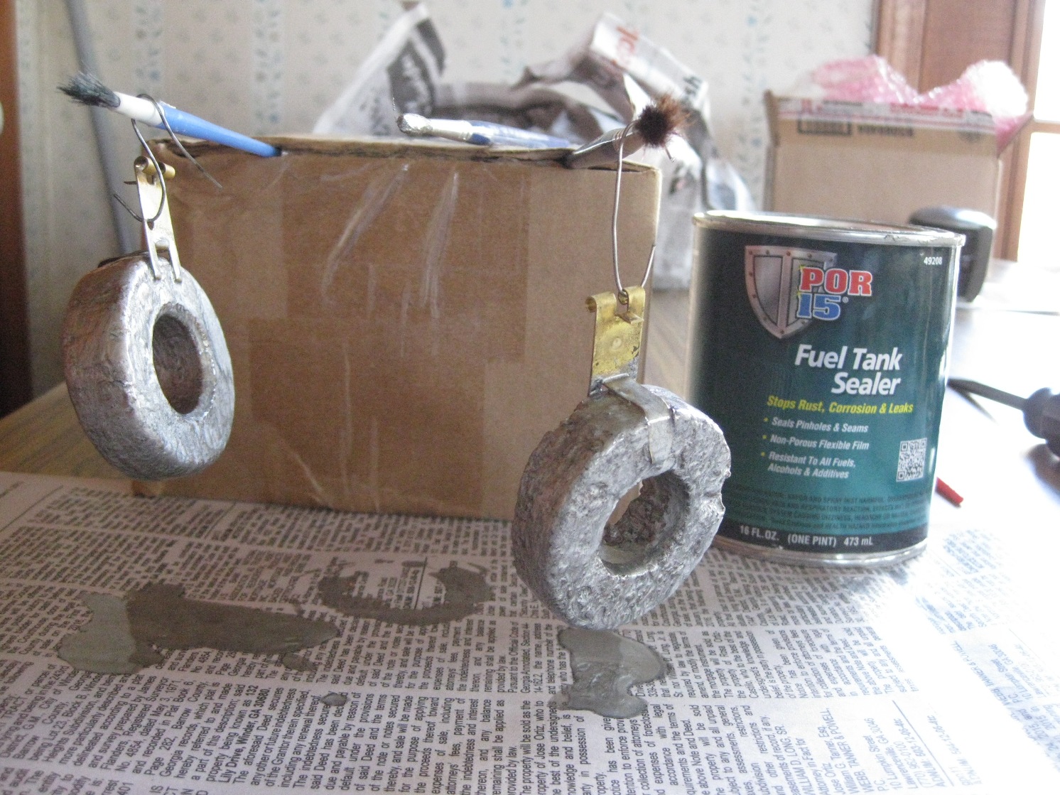

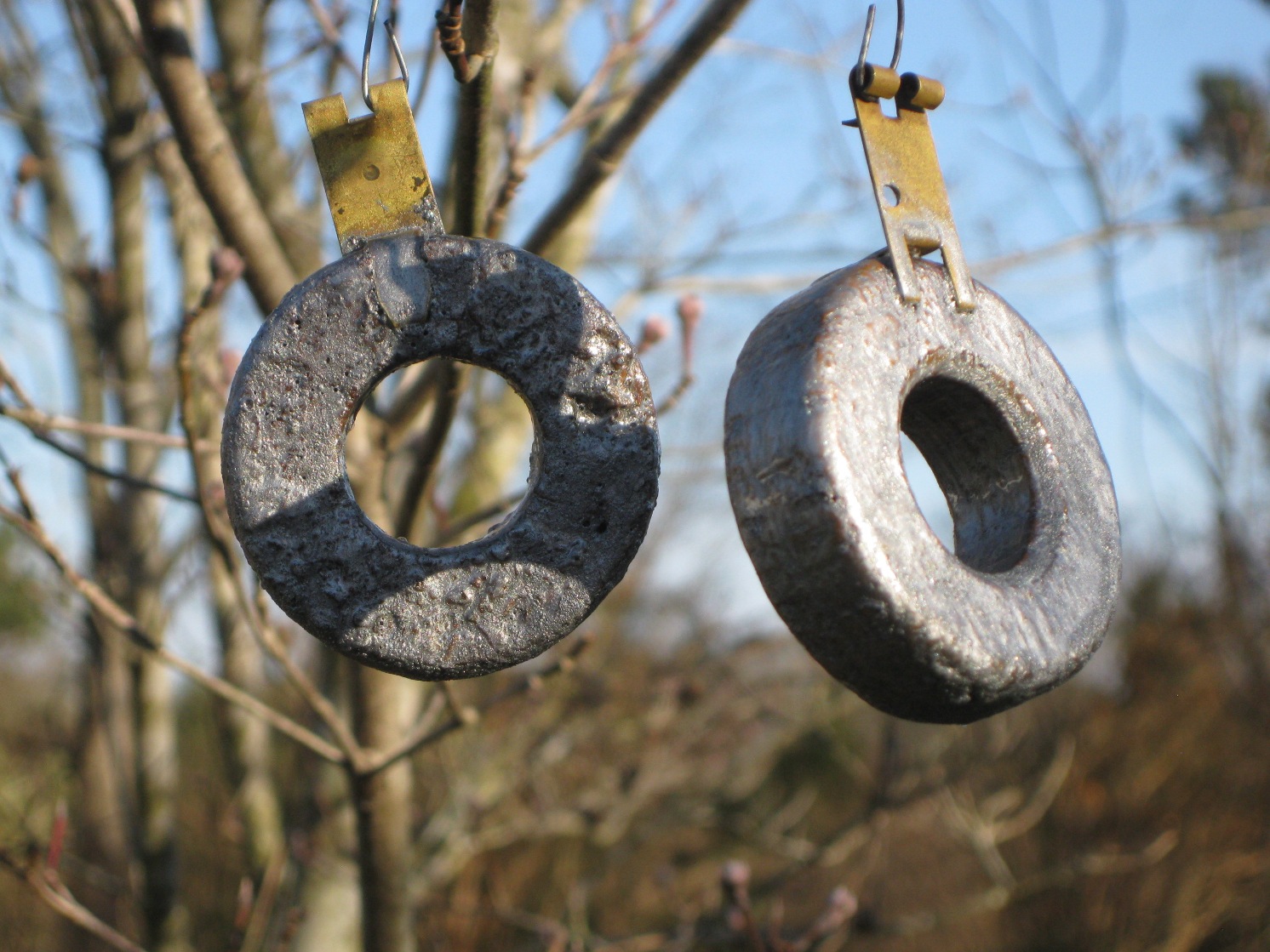

July 25, 2016 at 4:52 pm #40906I tried this and the stuff seems impressive. Also, The Carburetor Shop (Jon and Sue Hardgrove) use it on cork floats and these folks really seem to know their stuff. If it stays intact in contact with ethanol-laced fuel I think it will be a good answer.
Item: On my can the lid was so tight that the can sides buckled while working it open. So it doesn’t seal well and will probably harden in the can if not used up promptly. Never seen this before. Anybody else encountered this?
