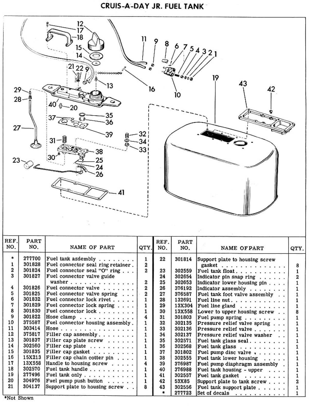

      I read where the tank pressure is supposed to be about 2-3 lbs. I checked mine and it gets to over 7-8 lbs. Of course the engine has problems running because of a rich fuel mixture, but I need some info
      on how I can fix the tank relief valve. I don’t even know where it’s located in the tank top.

      #187435
        Pressure relief valve is items 32, 33, 34. I don’t think I’ve ever seen one fail to release. Plenty of them fail to hold pressure though.
        9.-Fuel-Tank

          Thanks for the response frankr. I thought the pressure might have been my problem since I mistakenly measured 7-8 lbs, thinking it should be 2-3 lbs. I might try and take the tank top off and see the relief valve condition. Maybe I’ll just keep the pressure system and see if I can figure out why the motor is running rich.
