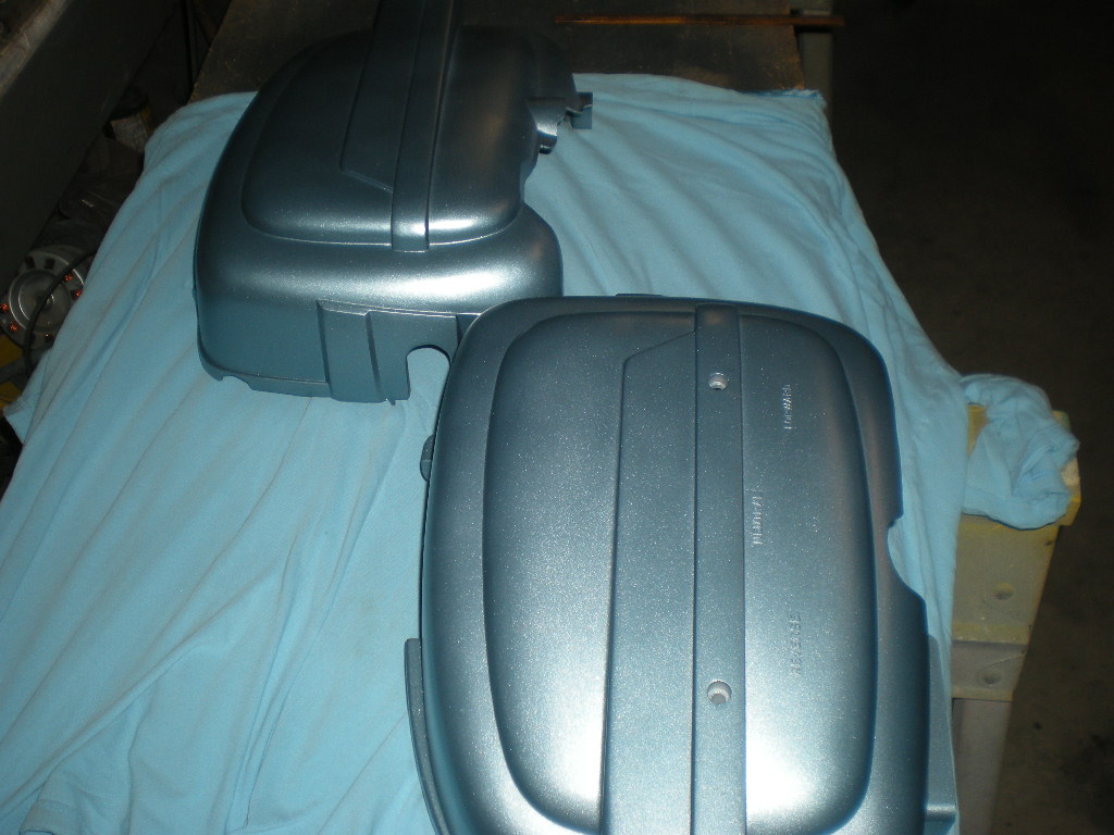

I painted my Fleetwin cowls last Saturday
(used rattle can polychromatic blue from Effanaco).

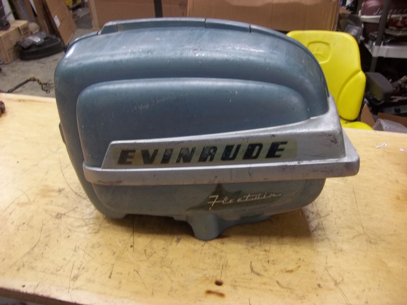

I need to mask off to paint the center "silver" as
in the photo of an original cowl, not mine.Q. How long till the danger of lifting my fresh blue

February 21, 2017 at 9:09 pm #53383Wannabe, Dust coat and two medium coats with the rattle can.
May have got a little run in the back of one cowl where I was
trying to get the paint down a deep pocket. (hand grab).
I’m mixing paint systems, so am taking a chance of something
not turning out, but there’s only one way to find out if I can
save a few bucks!
I used DupliColor Engine primer, then Effenaco Polychromatic Blue.
Seemed to be no issues with that mix match.. so far.
Hopefully the DupliColor Engine Clear isn’t a problem over the Blue.
Going to wait on that until I paint the silver on the hood and get
the decals!I’ve received no input on this previous paragraph……
