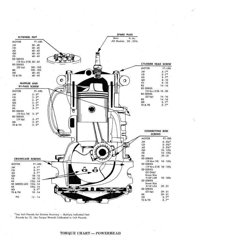

      I’ve had this head off a couple of times over the last 40 years and never knew exactually what the bolt torque was supposed to be. I just did it by "experience" as a mech.
      Anyone know where I could find the correct torque? I have originals of the owners manual and Parts manual but haven’t seen it in there if its in there.

        60 to 84 inch pounds going by this chart.

          WOW Nice chart I copied it to my Johnson file for reference Thanks!
