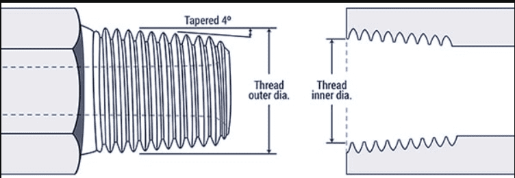

            In the first place, those are not 5/8 and 1/2 inch threads.  They are tapered pipe threads.  Pipe sizes harken back to the days of iron pipes and are sized according to the INSIDE diameter of the pipe.  Even that is not totally true, as iron pipes were made with over-size ID to allow for full flow in spite of clogging with rust buildup inside.   Since you think it is 1/2″, I assume it is really 1/4″ NPT (National Pipe Thread).  Next size down, 1/8″ NPT is often mistaken for 3/8 at first glance (not).

              Pipe threads have always confused me a bit, but I thought I was ‘safe’ when I measured the tank hole by testing a 1/2 x 20 tap so I could get a proper plug at the hardware store. How is it that the tap matches the threads, but you are calling it something entirely different?
              I called the threads 1/2″, is that incorrect? If it is, what size threaded plug would I go to Ace and look for? 🤔 please edumacate me?

                  Pipe threads are tapered (4 degrees) so the farther in you screw them, the tighter the treads jam together,  That is what creates the seal.  A 1/4″ NPT thread is 0.54″ major diameter, and 18 threads per inch.  That is why you can start a 1/2″-20 tap, close but no cigar.

                      When cleaning out Johnson “T” series tanks, I’ve been using a 1/2″ brass plug to temporarily replace the filter screen fitting for years now. This is done to save the delicate filter screen from damage when shaking the tank with fasteners inside. This plug has worked very well, and that is why it’s a bit confusing.
                      The brass plug was purchased from a local plumbing supply. Have I unwittingly been using a tapered thread plug all of this time?
                        Sometimes you don’t know what you don’t know…
                        You may not have known the technical what-fors and why-fors, but you must have known there was something different about that thread, which led you to a plumber for a plug.  Experience is a great teacher.
