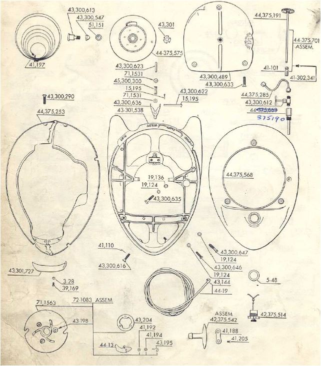

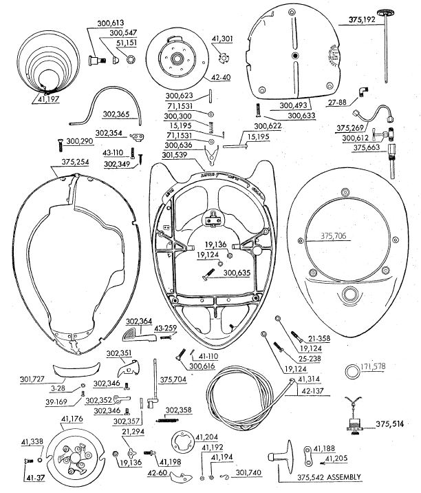

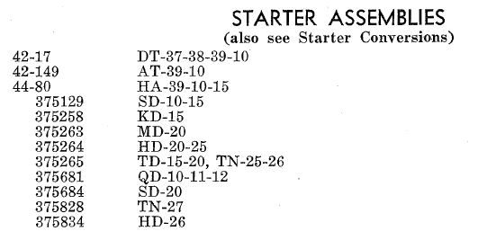

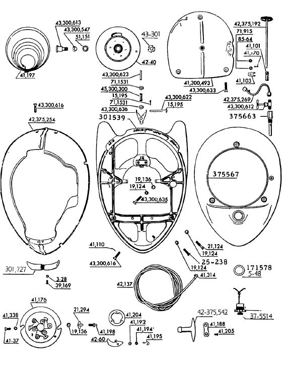

      First post here. I have tried searching but to no avail. I have a TD20 5HP. I need the starter pulley and prawls assembly. I’m having trouble finding one for this model. I have found a few for an HD25, TN26 etc. Does anyone know off hand if these will fit a TD20? Thanks for any input!
      #70564
        The HD-20 – 25 starter assemblies are different but one from a TN-26 should be the same as used on your TD-20.
        #70569
