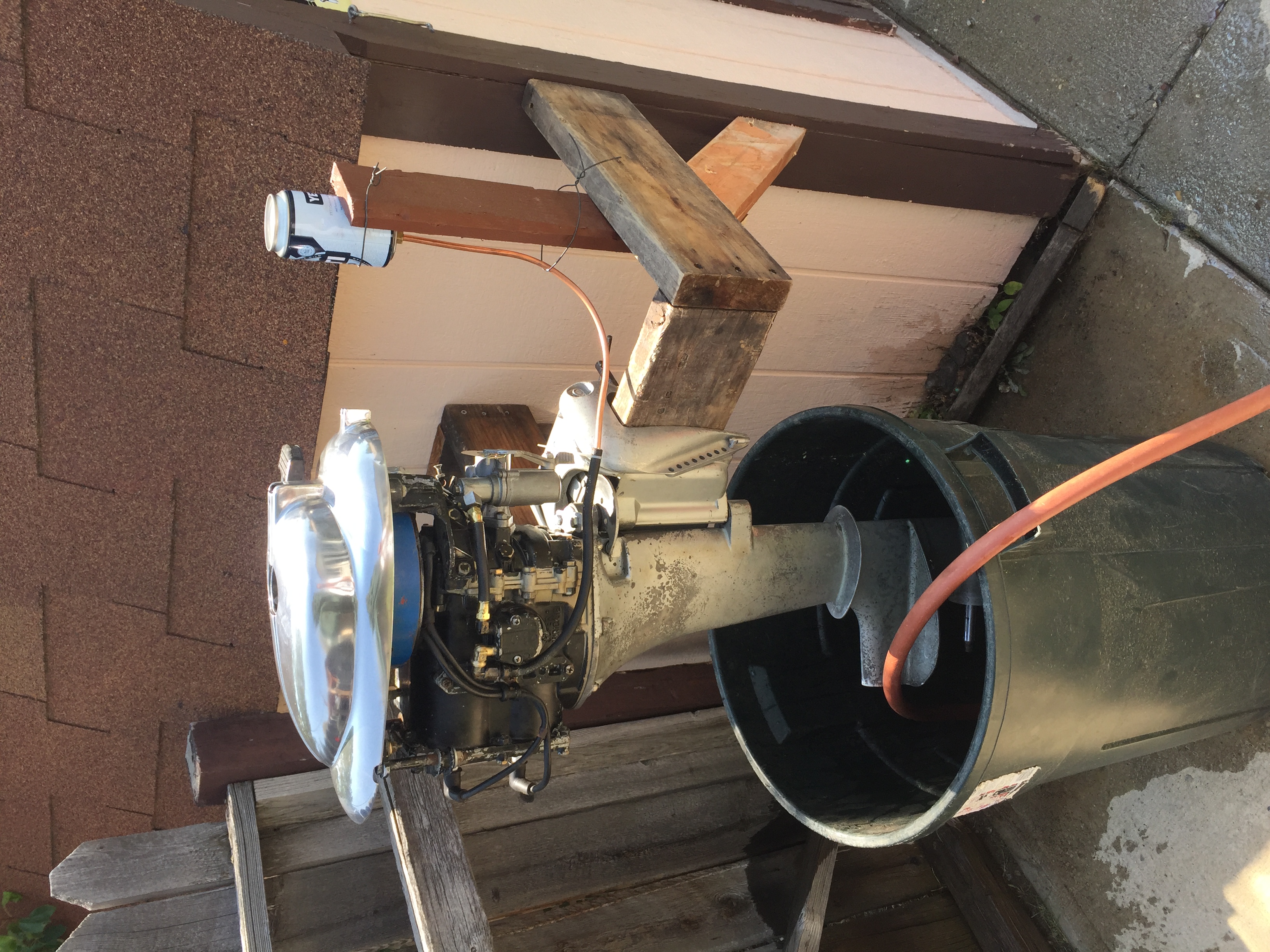

                Love the YETI can fuel tank! ๐Ÿ˜‰ ๐Ÿ˜†

                  Ben if it works it works haha. I just needed a small tank for testing motors in the bucket and that is what I had laying around. Works great!
                  #81649
                  fisherman6
                    It’s a slick idea with the way those come apart. I have 2 of those . I may have to do that myself for motors with gravity tanks. Hope you don’t mind if I steal your idea. ๐Ÿ˜‰
