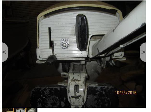

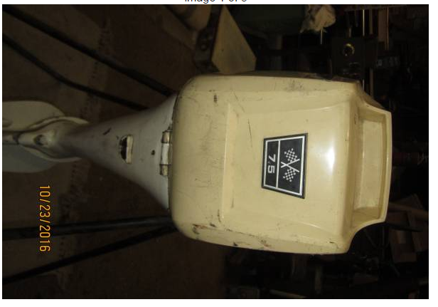

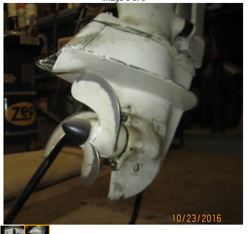

Hello to all;
This motor calls to me, even though I don’t like these, or need it.
It’s cheap, and not far away.What can y’all tell me about Ted Williams motors made by Sears?
I don’t know what I’d do with it; probably dump time and money into it and then hang it off the wall.
I won’t be relying on it to get me home, or anything.
It has one low cylinder; could be a gasket, or could be a hole in something important.Are these cheaply made junk, or no?
All opinions welcome.
Many thanks, and happy motoring to all!

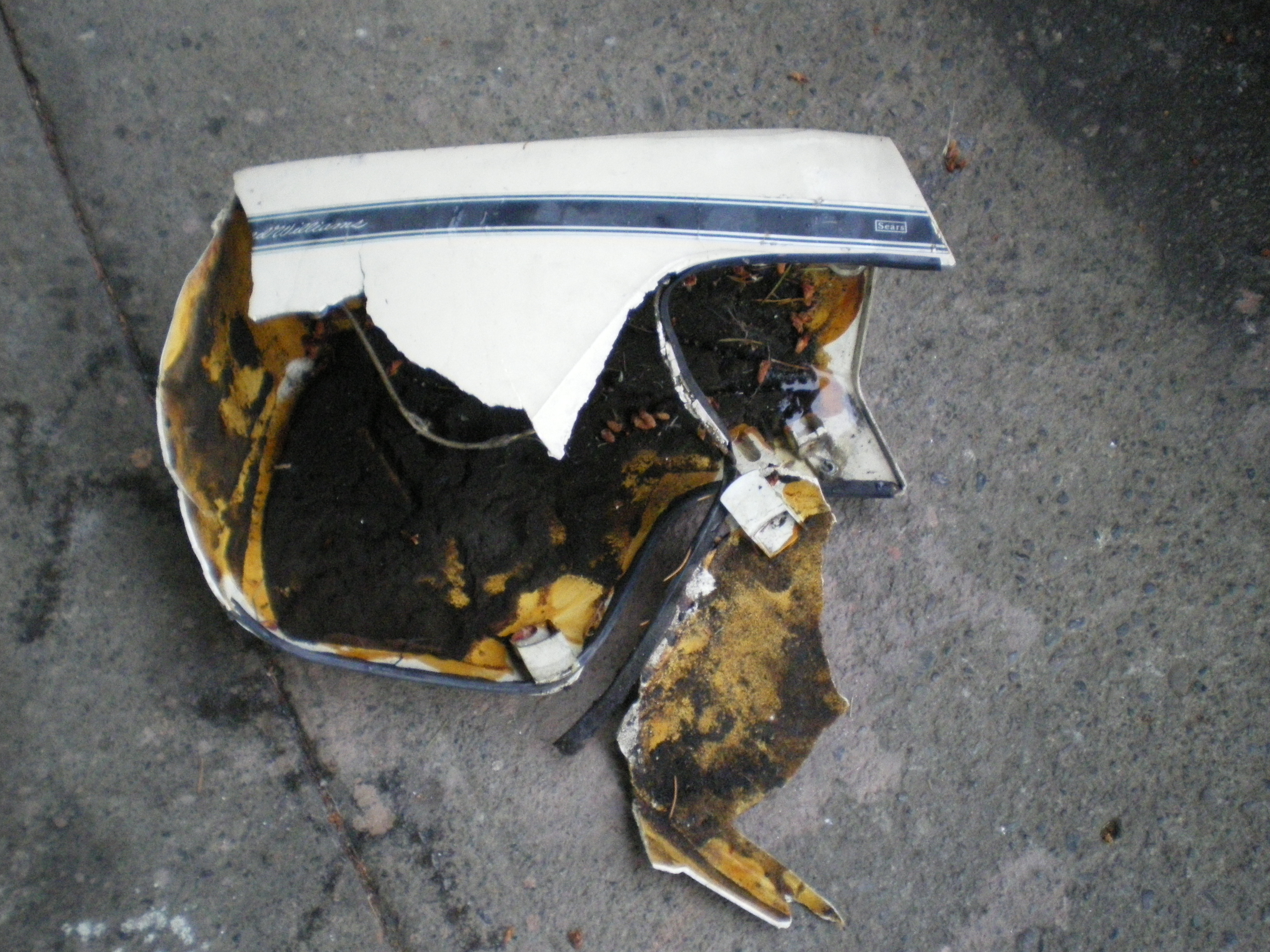

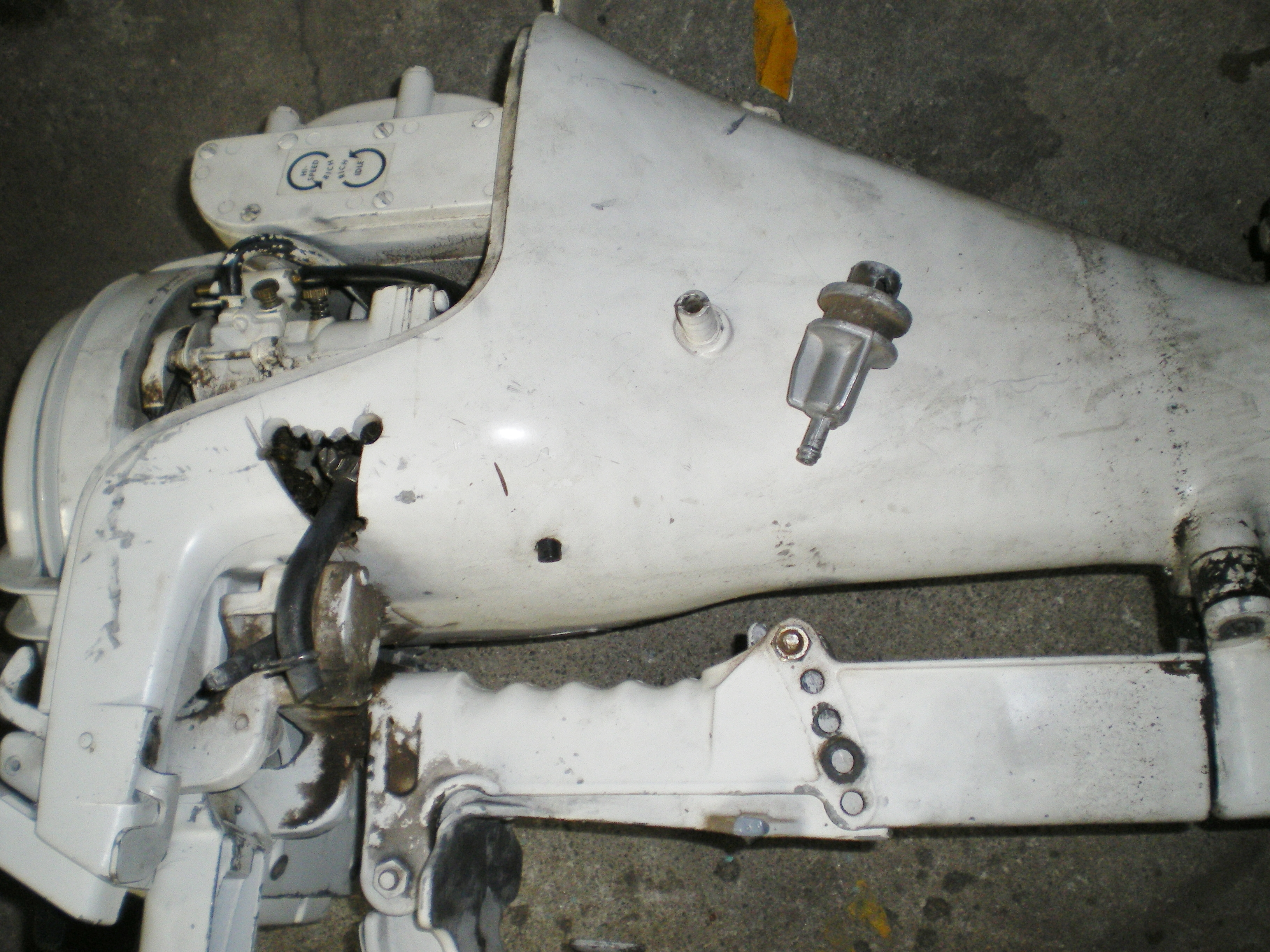

On this 9.5 I have, someone drilled a bunch of holes and knocked out a section of the casting. Why, I don’t know. Maybe to get at the carb adjusting needles easier or to install a new fuel line. One bad point about them is the hoods. They are made of thin plastic, not fiberglass, and get brittle with age. Picking up the motor by the cover could be enough to break it. The one in your pics looks intact. Guard it with your life!
October 30, 2016 at 2:49 am #46722Looks like you found one with a decent hood. That’s rare. You’ll have to pull the powerhead to do a carb. If you have a complete set of 1/4" sockets and small hands it won’t be hard. The 7.5 is a quick little motor at only 40 lbs. Make sure the anti-cav plate is submerged or it will overheat. (The one I had seemed too short for my Lund with a 15" transom). Both water pumps must work. Shift linkage changed between ’66 and ’67 with different exhaust housings. Look for a parts motor if you need any major parts. I saw one on an 8 foot dingy that looked like fun.

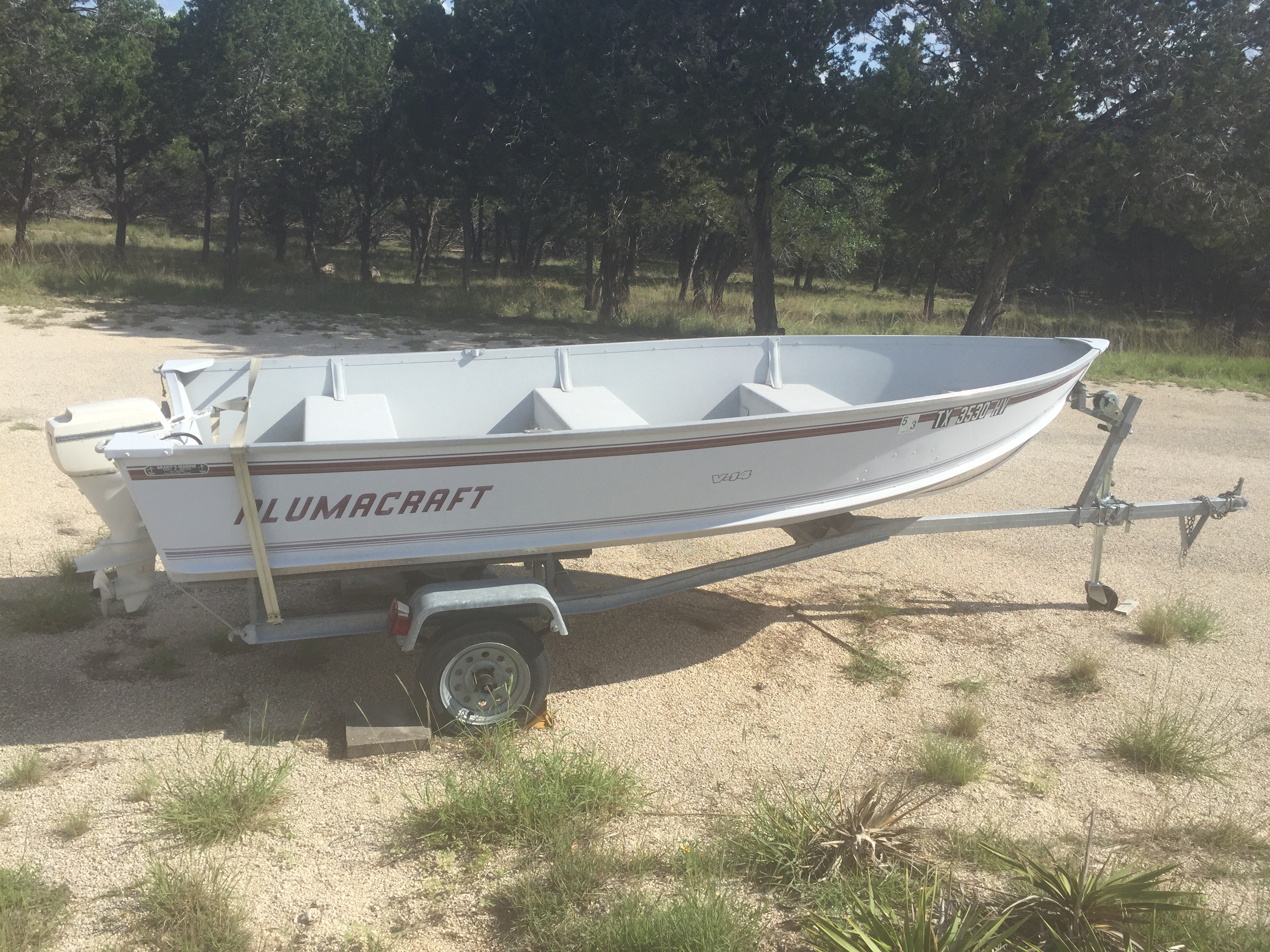

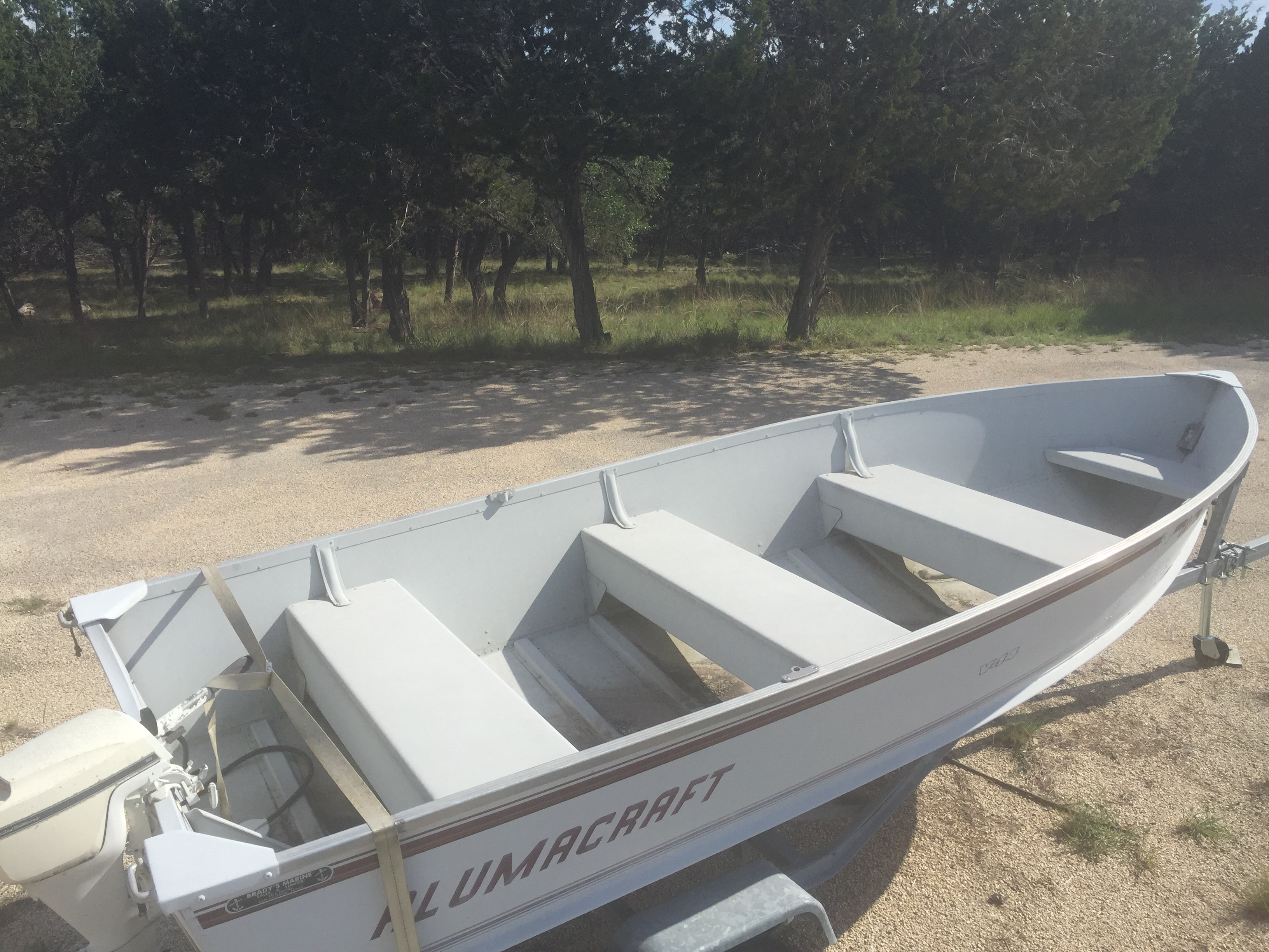

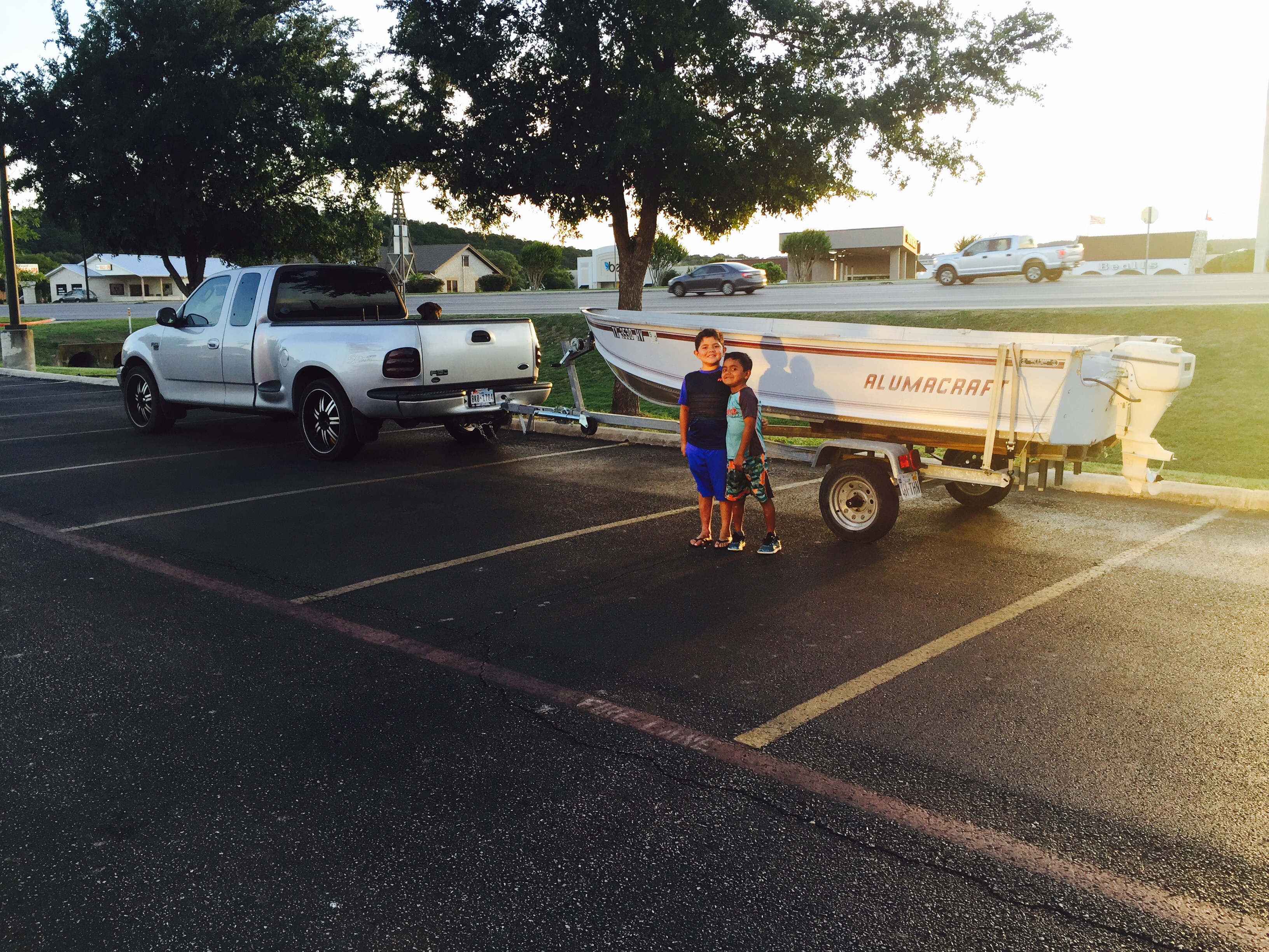

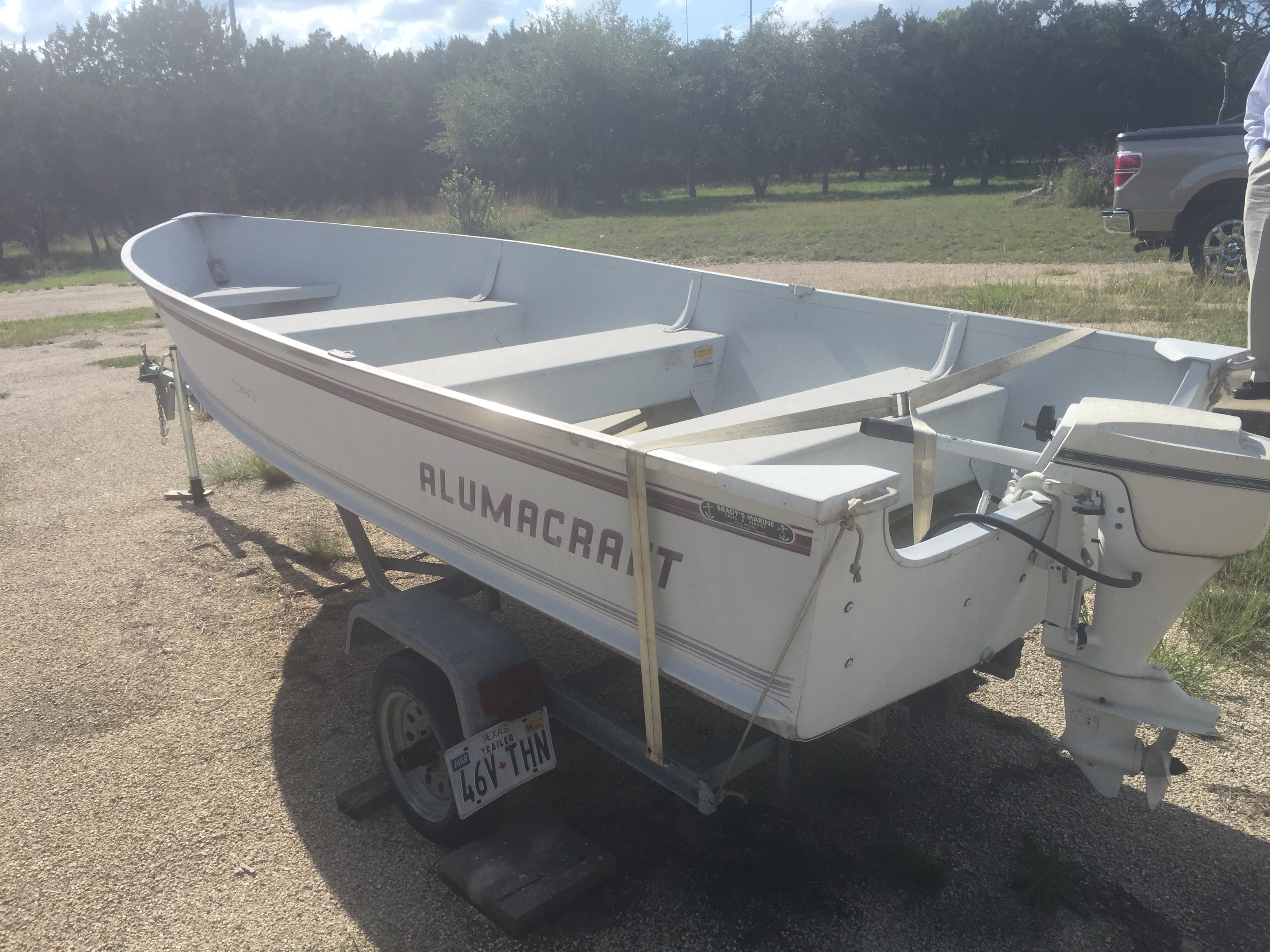

June 17, 2017 at 4:52 am #59820I’m in the "same boat" (no pun intended)…
I just acquired a cute and pristine 1968 Ted Williams, I like it a lot, just no luck getting it to crank over.
So, I’m scouring these forums for all kinds of ideas. Y’all keep up the good information please. It’s helpful to find considering how old these outwards are.
I’m excited and so are my boys!!
( why is there a hose coming from that side? Or, what is that port for originally?)
June 18, 2017 at 1:49 am #59851The port with the hose is for bailing the boat.
