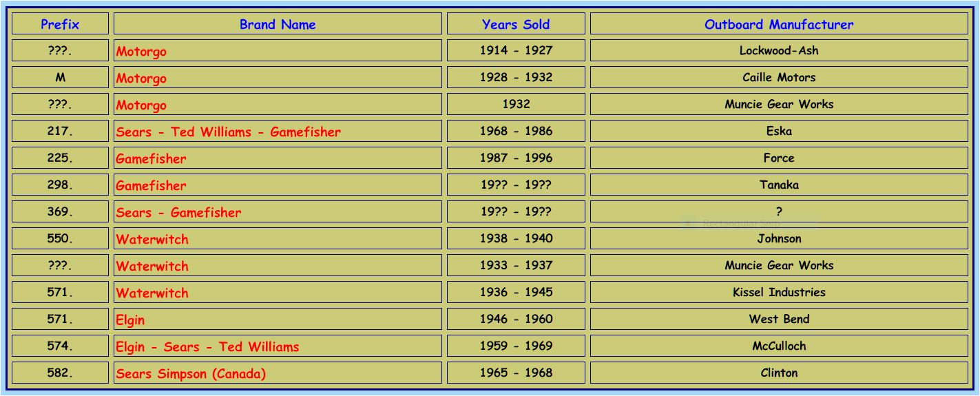

john@scent-sei.comMay 18, 2017 at 10:53 pm #57935Look for a model number that goes something like this: 217.xxxxx

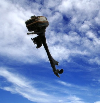

I am not an expert on your outboard, but I am fairly certain that it is an ESKA outboard manufactured in 1974 for Sears in Canada. Rated at 5hp, it is an air-cooled motor; however, if it is similar to some I have worked on in the past, there is still a water pump impeller in the lower end that pushes water to the bottom of the powerhead to condense gases and to keep heat from building up under the top cowlings.
The last company that I dealt with that had manuals and parts for the ESKA outboard was Certified Parts Corporation in Janesville, Wisconsin. Perhaps they can help you out. This forum is probably not the best source for information on the ESKA outboard because nobody that I know collects the Tecumseh powered air-cooled motors from ESKA. I actually am guilty of having an "ESKA Toss" many years ago at a Lake Catherine wet meet because it was the only motor that would not anger one of our members when we threw one into the lake (not to worry, we had a rope on each motor and did not leave them in the lake). I had the opportunity to work on a number of these motors in the late 1990’s when I was laid off and needed some income to stay afloat (pun not intended). The one thing I recall is that the little motors ran well when they ran, but when they stopped, it was easier to take them to the scrap yard than it was to repair them. Even their carburetors were strange with a little balloon for a fuel pump. When that pops, the motor will no longer run from an external gas tank. If a new one is inserted at the incorrect angle, it still will not run.

May 20, 2017 at 3:13 am #58020May 20, 2017 at 7:59 pm #58065Some single-cylinder air cooled Sears outboards are Clintons. The relationship between Eska and Clinton isn’t totally straightforward, from what I know, but in general Eska used Tecumseh engines and Clinton made their own.
