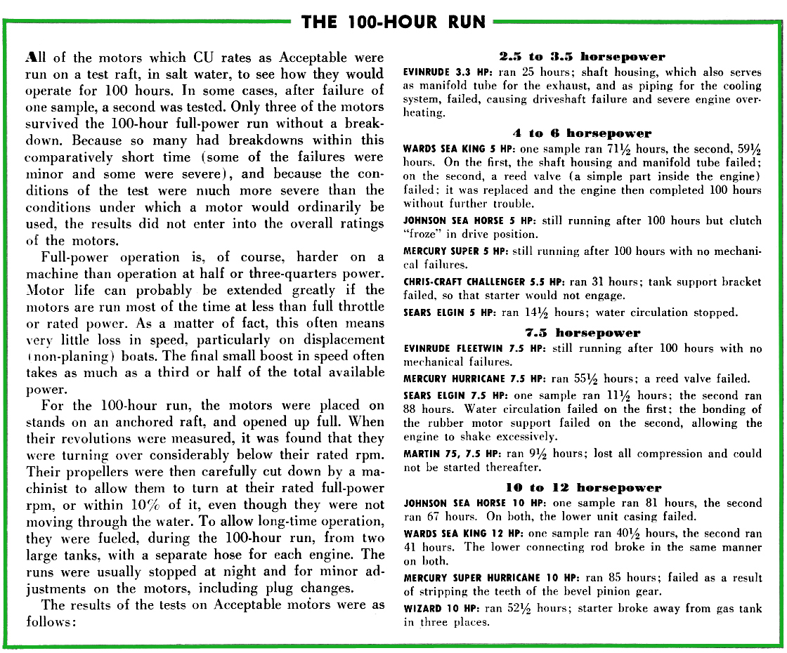

            #25923
              This is how Consumers Union did it …
              #25932
                Interesting that in spite of all that grief and failures, all were rated "Acceptable". I guess people didn’t expect much in those days?? But congrats to the three that made it for 100 hours. Not surprisingly, Johnson and Merc 5hp and Evinrude 7.5.
                #25948
                  It looks like the TN and Fleetwin were at the top of their class along with the little Merc!
                  That would be a great job running motors at full throttle all day long and not having to pay the repair bill when they break! How do I apply? :mrgreen:
                  #25958
                    Knowing what I know about Mercury Super Fives and their fragile lower units, I am very surprised at its making it past 100 hours. I’m pleased, but surprised. Then again, I am just as surprised that the Fleetwin didn’t throw a rod…..
