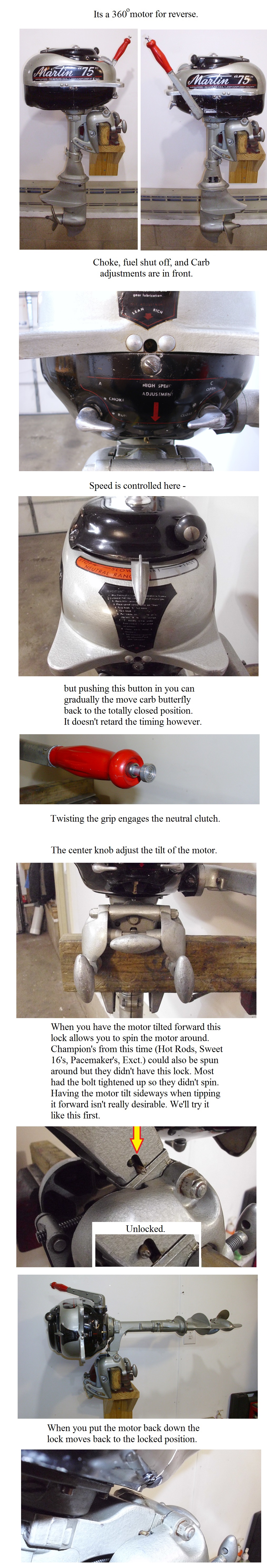

      Did 3 motors this winter. I take lots of
      pictures but have a hard time getting
      my self to go through them all to post.
      This is the motor that needed the least
      so the fewest pictures. While I was
      painting something else red I gave the
      mag. lever a shot. I don’t think its
      suppose to be painted but I couldn’t help
      myself. The rest of the motor just got a
      cleaning. Tried to video it running in
      pond-o-plastic Wednesday but the wind
      was blowing so hard you can barely hear
      it. Yesterday was a better day.

            Not much of a Merc fan, but I’ve had a few. This one looks GREAT. Good work & looks like you started with a good specimen. I love the red lever. Matches with the red insignia on the front of the cowling. COOL!

              lever turned out good. looks to be a low hour motor. they run real good and surprisingly strong for a 7.5

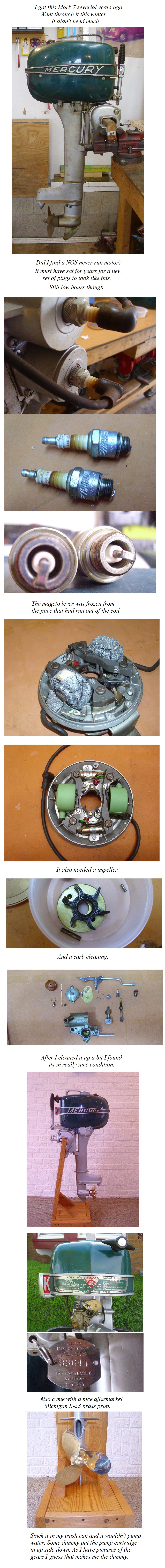

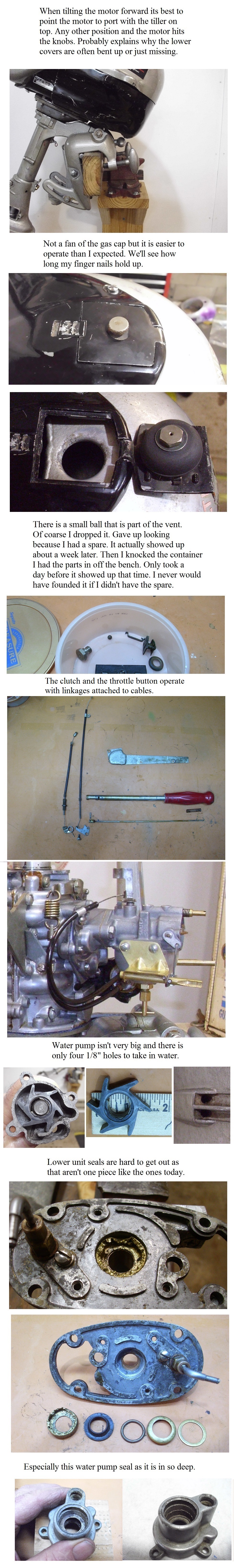

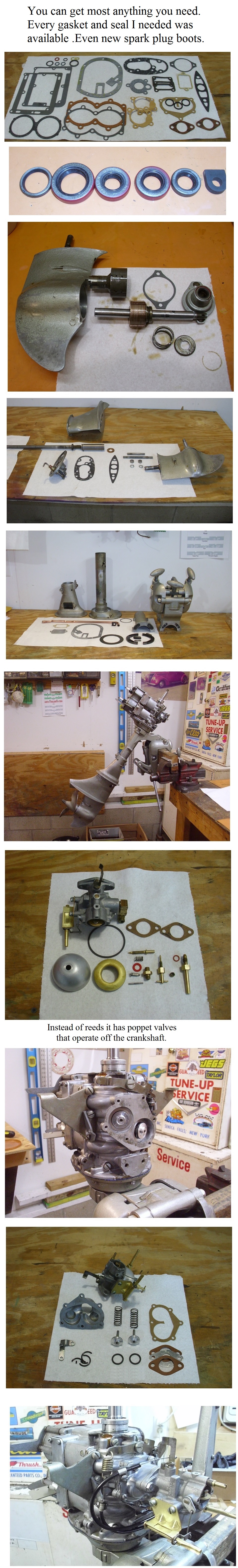

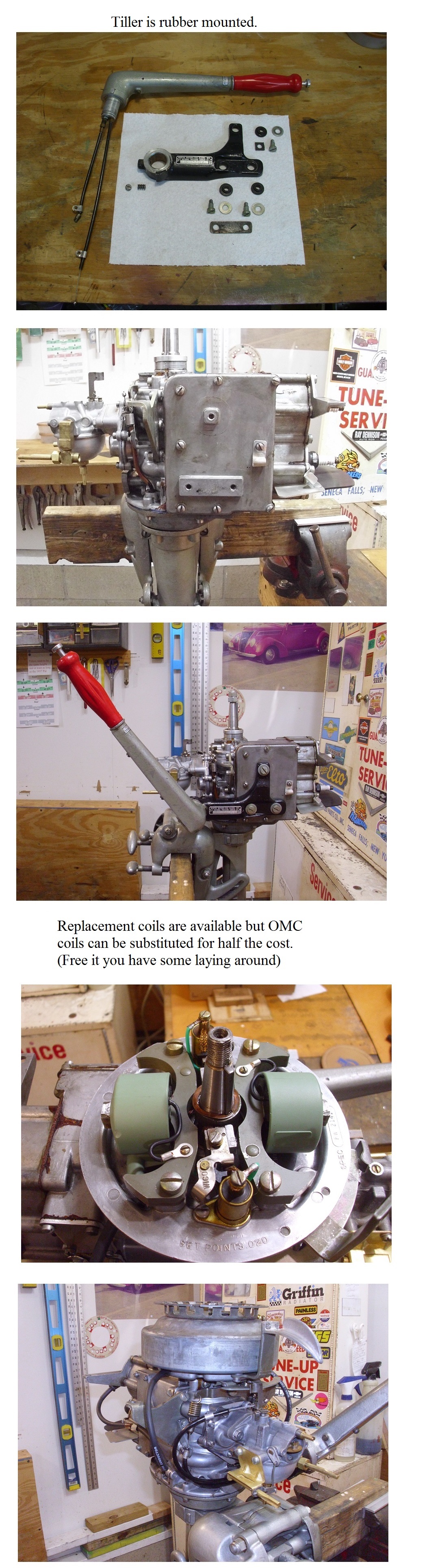

                        I was also messing with a Martin 75 Twist shift.
                        More out of curiosity to learn about new things
                        that got me to start on this motor as I don’t really
                        find it visually appealing. I got it in a "take one –
                        take them all" deal. The motor was beat up with
                        damaged and missing parts.
                        twostroke was a
                        big help in getting some of the missing parts I
                        needed and with the advice from members it runs
                        again. Here are some pictures.
                        I really don’t find the motor much to look at.
                        Its not as nice as the Mark-7.
                        I had some paint to use up.
