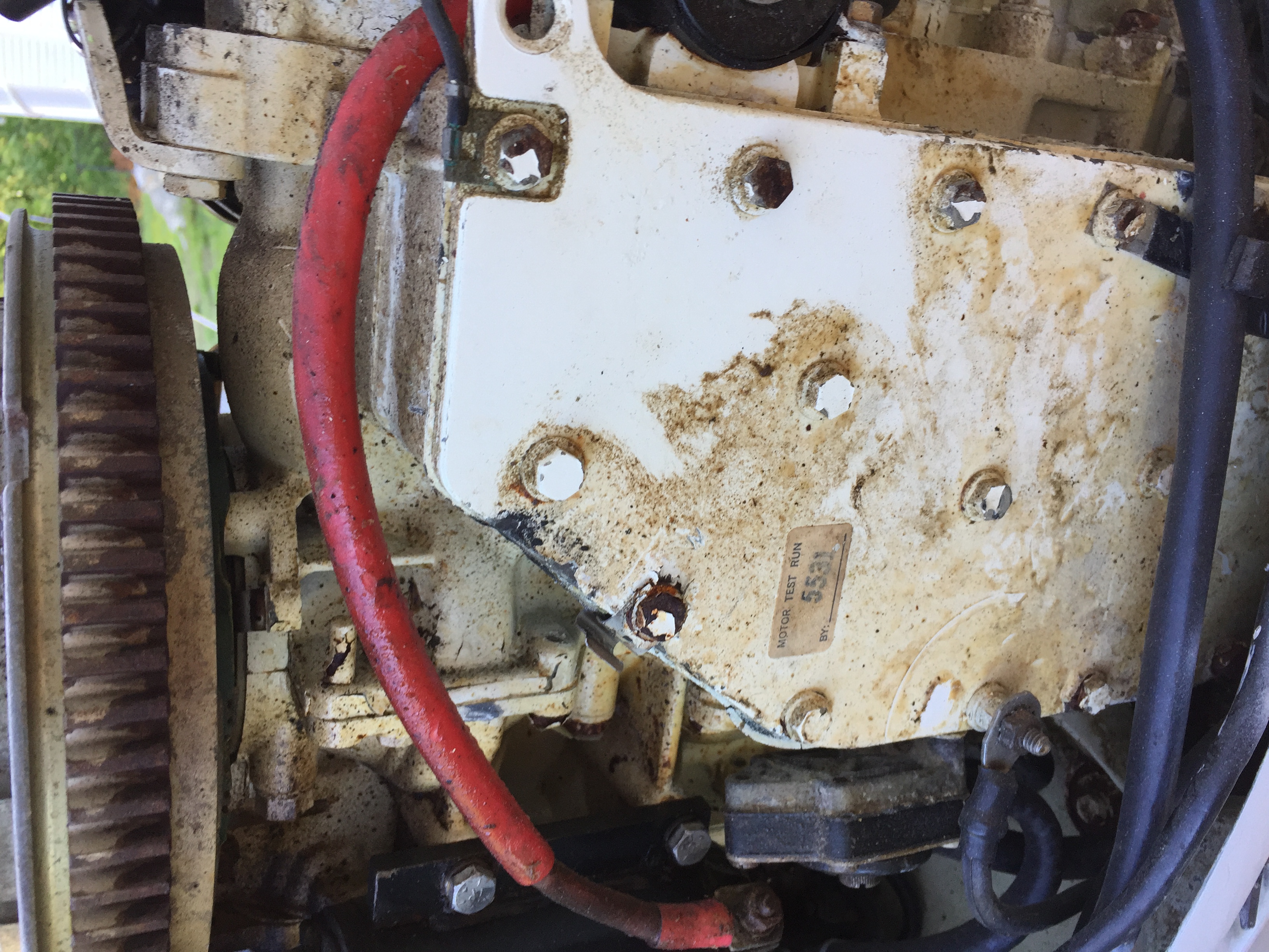

      Over the years I have run into 4 or 5 motors that have been covered in a “goop.”
      The stuff has the consistency of glue and it’s always the powerhead and components some prior owner has sprayed them down with to protect from corrosion. It doesnt wipe off easily but it does a good job of keeping everything loose and protecting from salt and corrosion.
      What is this stuff? I wiped some off the exhaust bypass cover to show the difference. This 1983 70hp Johnson was a lightly used salt motor and you wouldn’t have known it had lived its life on the back of a Boston whaler on the ocean year after year, unless you saw the few barnacles on the trim pin holes. Everything else on the motor came apart like butter.

        Looks to me like a marine corrosion inhibitor spray, like those manufactured by CRC or Corrosion X. I use this stuff on my boat trailer hubs in the salt and it leaves that same brown gooey appearance. They do work good at keeping the salt demon away.

          mercury was anti corrosion spray.

            BRP still makes one by the same name as Merc. #777193 Anti Corrosion Spray. Stuff is almost like a light parrifin wax when it dries. Messy!

              Yep, –just like Dan says. I’ve use that stuff on the galvanized tank on my Chris Craft in lieu of painting it like the factory did..I also sprayed another Chris Craft engine I did 20 years ago after I painted it. Engine still looks perfect!

                I thought they called it Cosmoline.
                Used it in industrial machine shops to coat the metal from corrosion.
