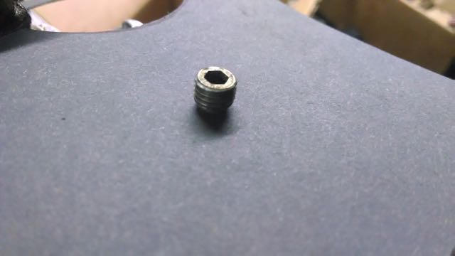

      I put my Johnson J 65 back together and found this piece left over.
      I took the motor apart a year ago. I don’t remember where that piece came from. Was this part of the gear case?

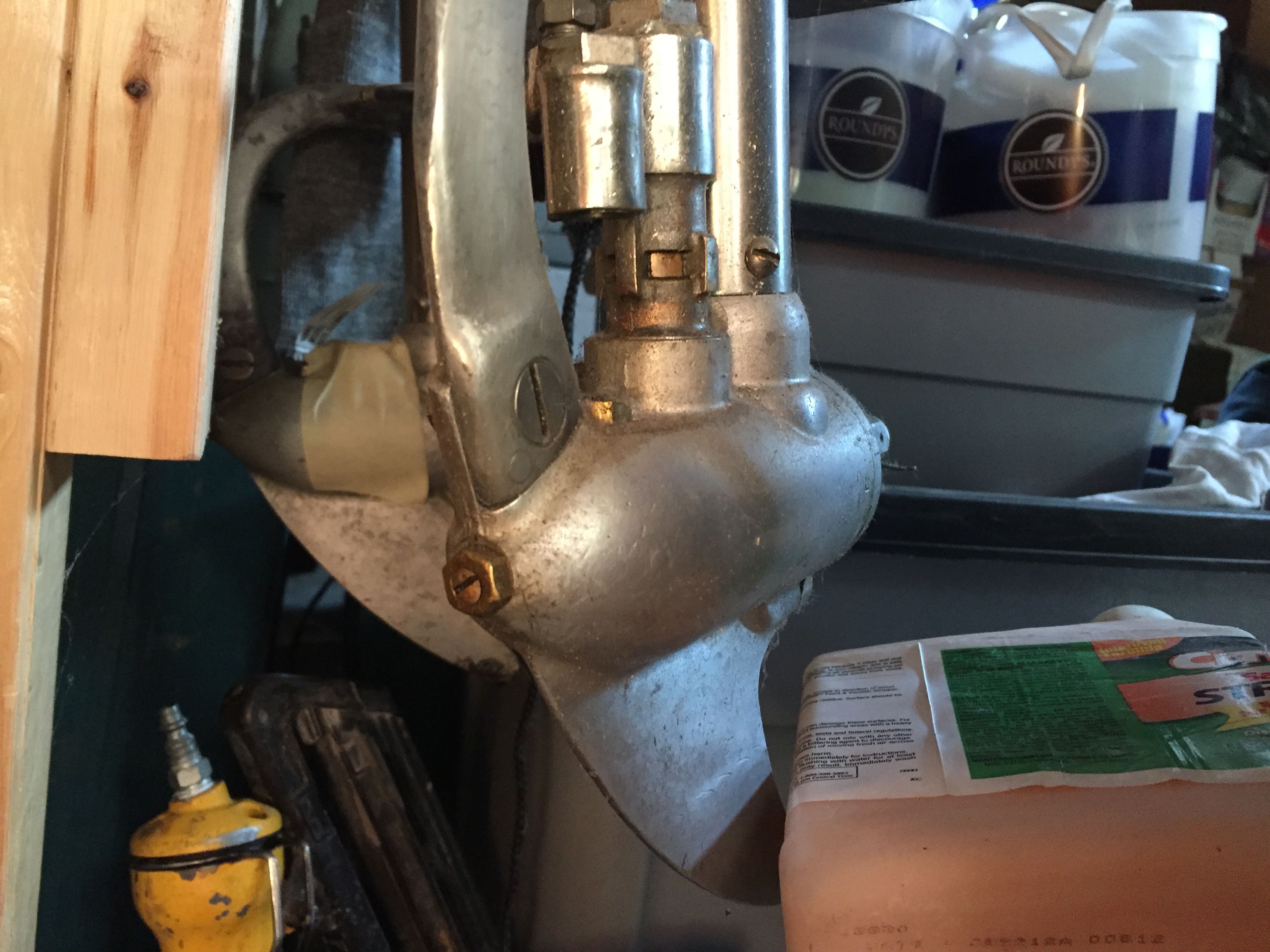

      Do I have that set screw in the front of the gear case right? I think it’s meant to adjust the prop shaft and gears, but it’s not very streamlined, is it?
      Should there be a washer at the base of the water pump? There’s a set screw that holds that assembly there but it’s not snug up to the gear case.
      If you’ve followed me this far, the J 65 is supposed to use a Champion C7 spark plug but they are discontinued. Champion suggests that D16 is a replacement. Is that right?

            No washer under water pump.Tubs is right about the set screw,nothing like that inside gear case.Screw in gear housing is for grease.Spark plug is right,but D9J is also listed.

              There weren’t any allen head set screws in that motor originally.
              Could be a replacement or somehow got dropped in one
              of your parts containers when you weren’t looking?????

                  Looks like most of your questions have been answered but I’ll also add my 2 cents.
                  Forward gearcase adjusting screw just kinda’ hangs out there.
                  No washer under the water pump.
                  The set screw (stbd. side gearcase) that holds the water pump in place has a thin locknut that anchors that set screw
                  in place. Any gap between pump and case is just that, a gap. (the set screw into the pump case determines that) I’ve seen them
                  with gaps and no gaps. I checked with Bob Zipps on that.
                  My J – 65 runs very nicely all day long with a D – 9 plug.
                  (My gearcase has an Allen plug for greasing but I’m sure it’s not original)

                    That allen plug looks like it could be the filler plug on a bottle jack.

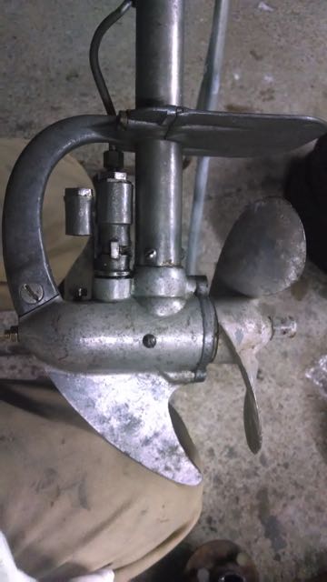

                    here’s a pic of the front of my j-65 gear case. let me know if you need any more.
                    scott
