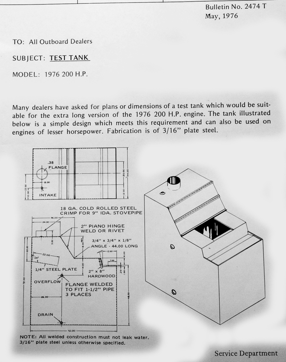

      Hey guys , I was considering building a tank . Are there any plans out there to get some idea on functional shapes.
      I hear they should have baffles of some sort . I will probably construct it with plywood and poly or epoxy .
      Anyone have experience with building one ?
      The goal is to have one large enough to run say up to a 50/60 hp if needed .
      But most importantly to keep the water inside the tank and not on my feet ..LOL!!!

            Thanks Garry ! Sorry about all your post disappearing .. That’s gotta be really aggravating …
            I like this design and could make it or something close to it ..And not too awful heavy when empty .. I will probably use plywood ..If I go poly resin glassed then I will roll a few coats of gellcoat inside .
            If I go epoxy then I will have to just paint it .. Thinking I should build a base so I could roll an engine hoist under it for larger motors ..

                I have a nice big plastic bin that I use now but my Speeditwin will empty it out pretty quick .I even made a nice cover for the top that surrounded the motor foot but it still emptied pretty fast … That’s why I want something to divert the flow to keep it in the tank . That’s what the slanted baffle should do ..
                I also like the chimney of sorts on the design Garry posted .. Might help divert some of the exhaust fumes ..

                  This is from a 1947 service manual – anything over 8 horse power really needs a test wheel.

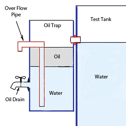

                  I used an oil trap to help keep the oil out of the environment.
