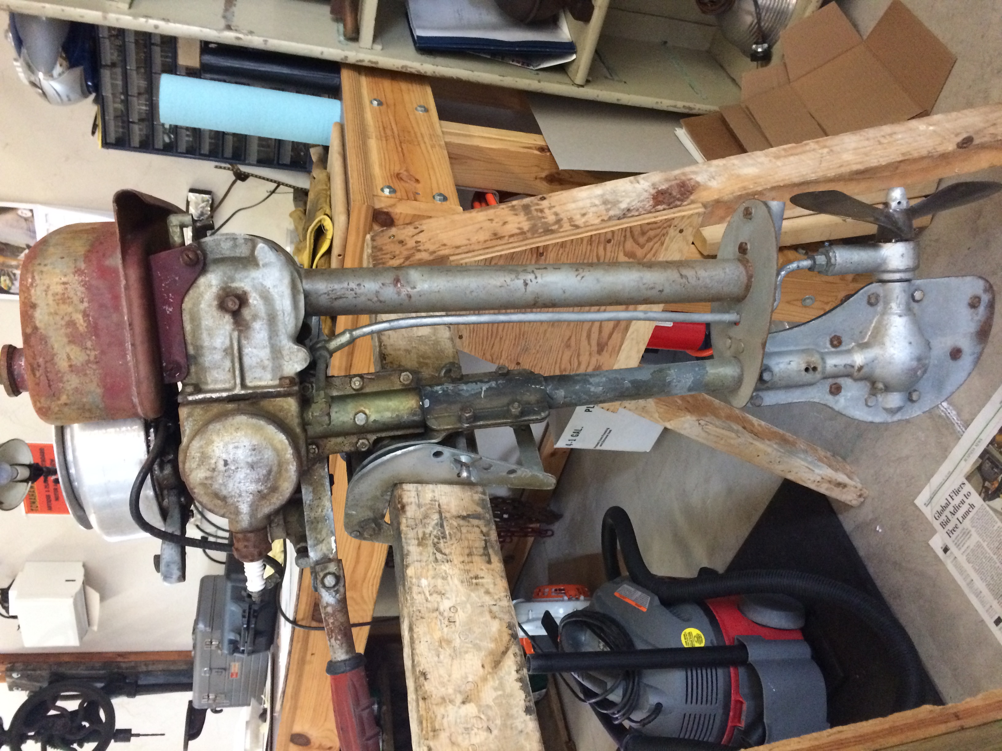

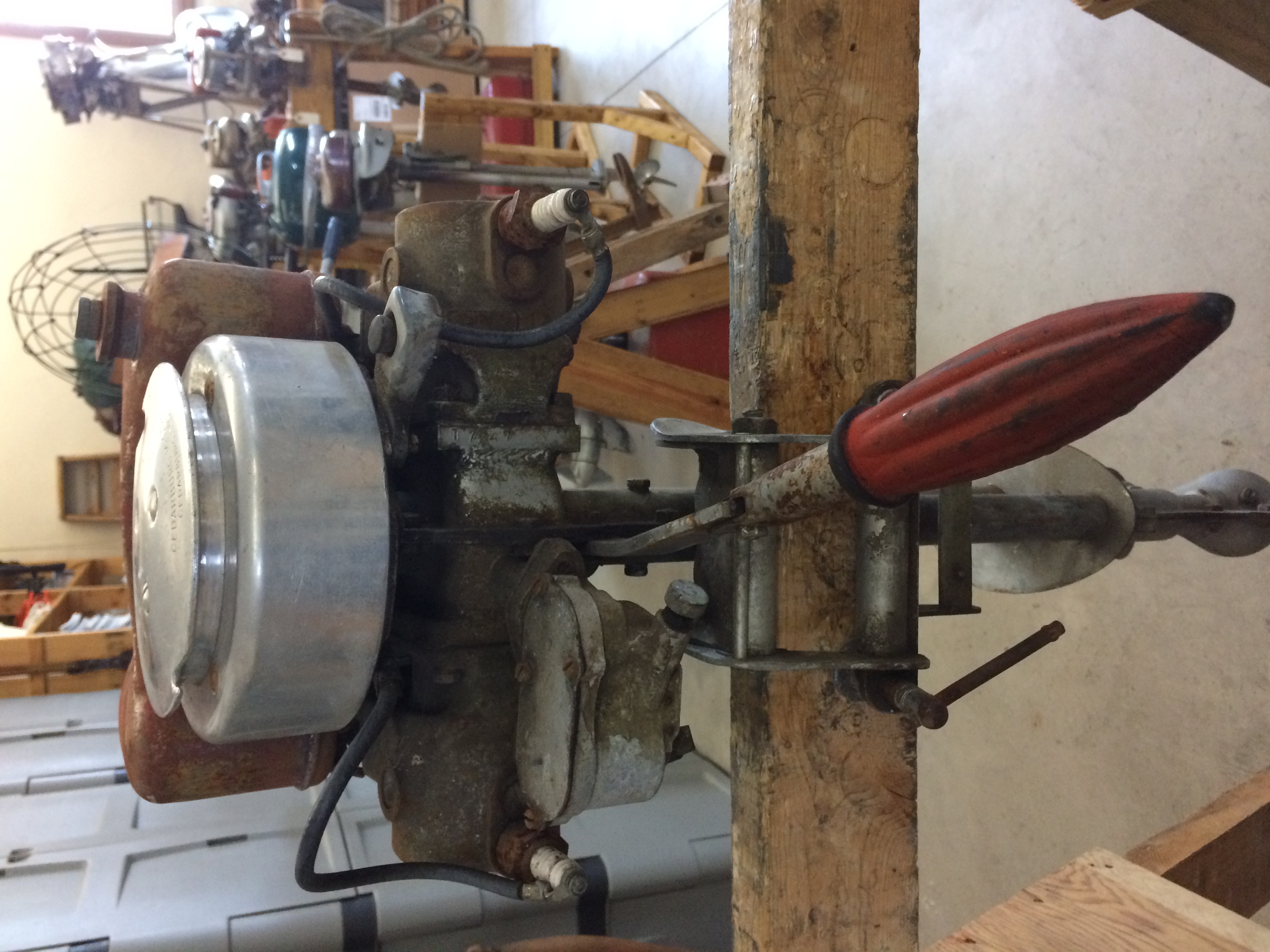

I purchased a Thor last night. I think it is a 1936-37. S/n T-7347, it is a 2 Cyl.
The only info I can find was a paragraph in the Old Outboard Book stating it is somewhat rare.
It is complete and in good condition. The tank is rusted and has a dent

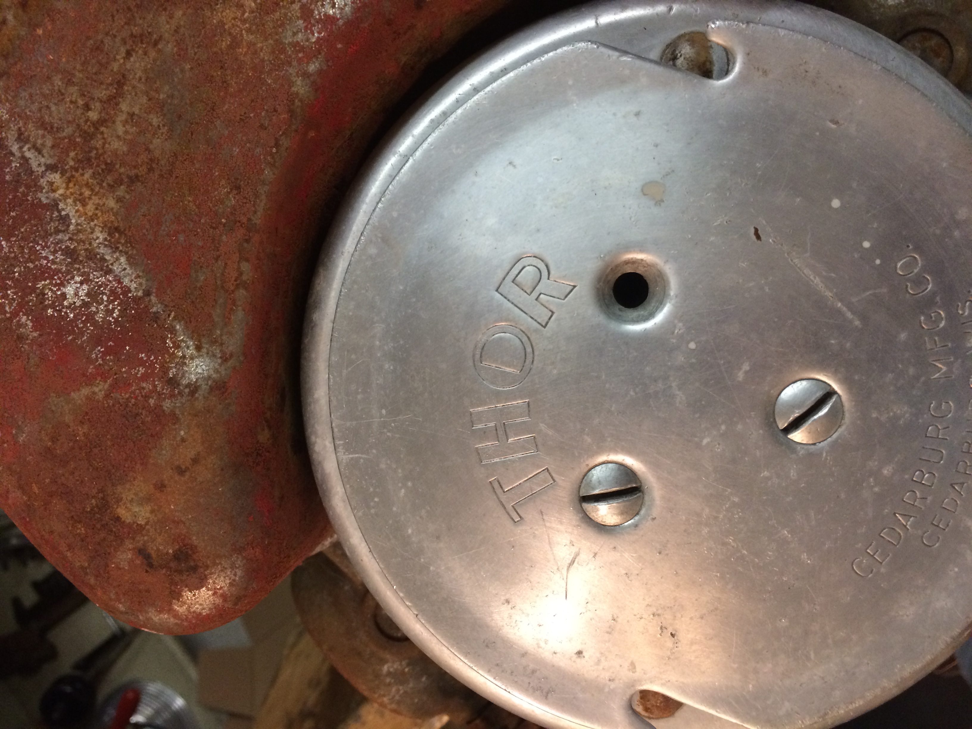

If anybody has information or comments I would be interested. The flywheel is stamped Thor and Cedarburg Mfg Co. I think that is before Kiekhaefer purchased them?
I am curious if it is rare?

The tanks are sheet metal, and prone to rust. They are also thin-walled stampings, so prone to dents and dings.
Your motor is indeed pre-Kiekhaefer. He took the Cedarburg Manufacturing Company over in early 1939. Some early motors used a lower unit with an angled profile on the leading edge, others were rounded like yours. I’m not positive when or why they installed one style or the other.
Thor outboards are built primarily out of steel stampings, which was Thorwald Hansen’s specialty. The rebuildable or replaceable bearing inserts (especially those in the powerhead) are prone to wear, and if the upper crankcase bearing gets worn out, these motors will not start easily or run properly. You can check the clearance by pulling the flywheel from one side to the other to verify if there is side wobble present or not. If you can see or hear the crankshaft clanking back and forth in the bearing, she likely needs some rehab work before it can be run.
I’m not certain that your Thor has the correct carburetor on it. At the very least, I do not recall ever seeing a carb like that on any Thor but somebody else might be able to chime in on that.
They were supplied with Eisemann and American Bosch magnetos, I think yours has the A-B type on it, just like the last of the small Caille single cylinder models used until they were discontinued in 1935.

December 30, 2016 at 10:08 pm #49959Thank you for the information. i have never seen a 2 cyl Thor so I am pretty excited. I was very surprised how heavy it is. The steel stamping explain that. The carb did jump out at me, it looks out of place but I am not sure. Need to see a few more photos.

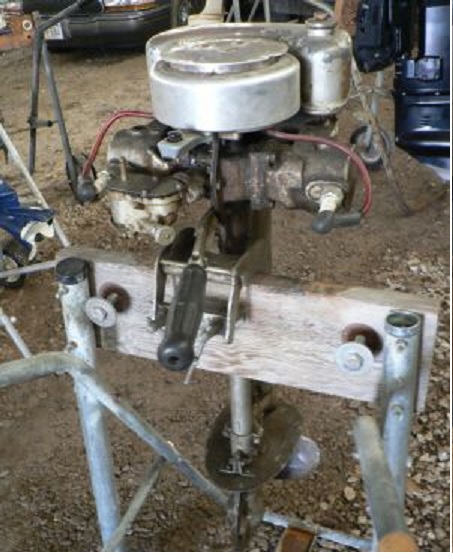

December 31, 2016 at 5:35 pm #50016December 31, 2016 at 6:22 pm #50021Thanks for the photo. It seems everything is correct. Just need to repair or find a new tank.
December 31, 2016 at 8:58 pm #50033The pre Kiekhaefer Thors used mixing valves. That’s why some of the first Kiekhaefer ’39 motors came with carbs while some were still using up the old stock of mixing valves. The rounded skeg appeared in ’38.
December 31, 2016 at 10:05 pm #50041Thank you for the information. So is my motor a 1938 with a mixing valve?
December 31, 2016 at 10:30 pm #50045Yes, your motor falls into the 1938 serial number range. In the photo it looks like your motor does have a carb but it could have been installed at a later date.
