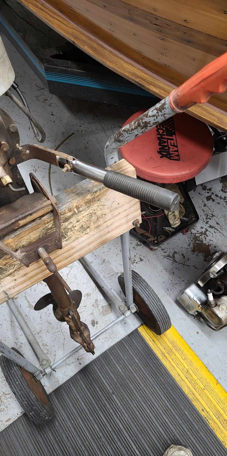

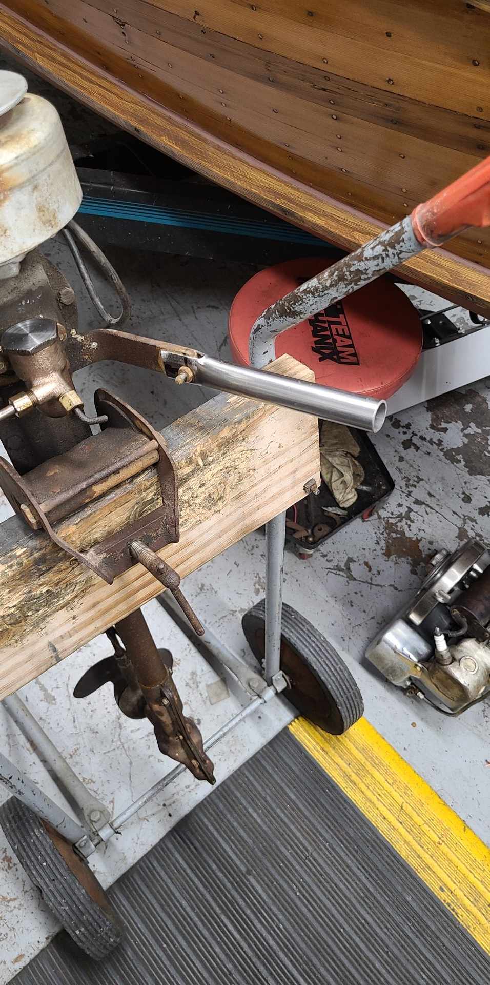

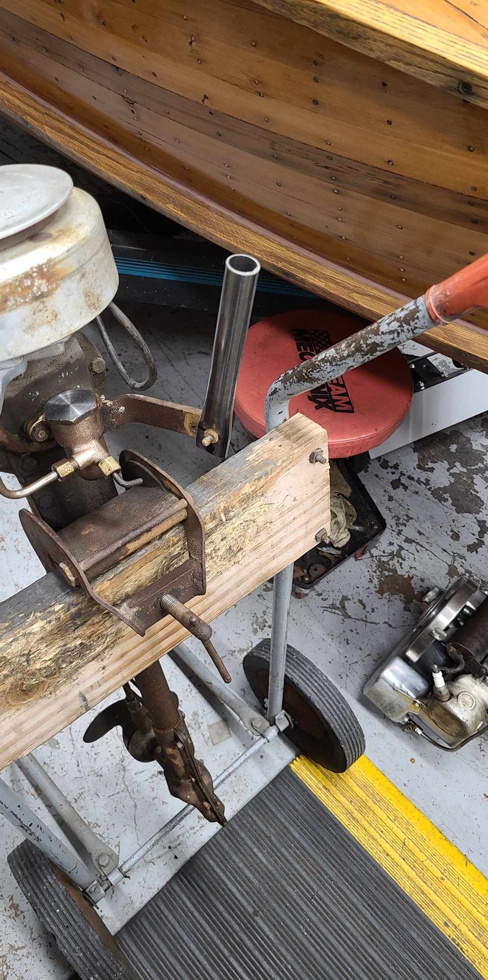

        Its a piece of tubing. 7/8|” diameter, I think. Cut to length, drill a hole for the pivot bolt, grind the bottom off so that the tube has an open side, then squash it in a vise to close it down to where its open enough to fit over the mounting stub.
        Thor-handle-1
        Thor-handle-2
        Thor-handle-3
        Put a grip on it if desired. This took me about 10 minutes to make from start to finish. Easy peasy.
