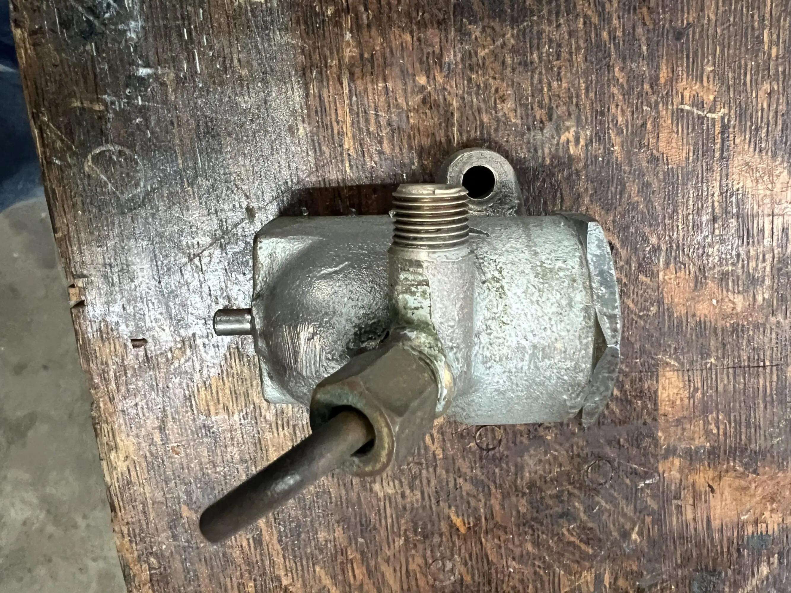

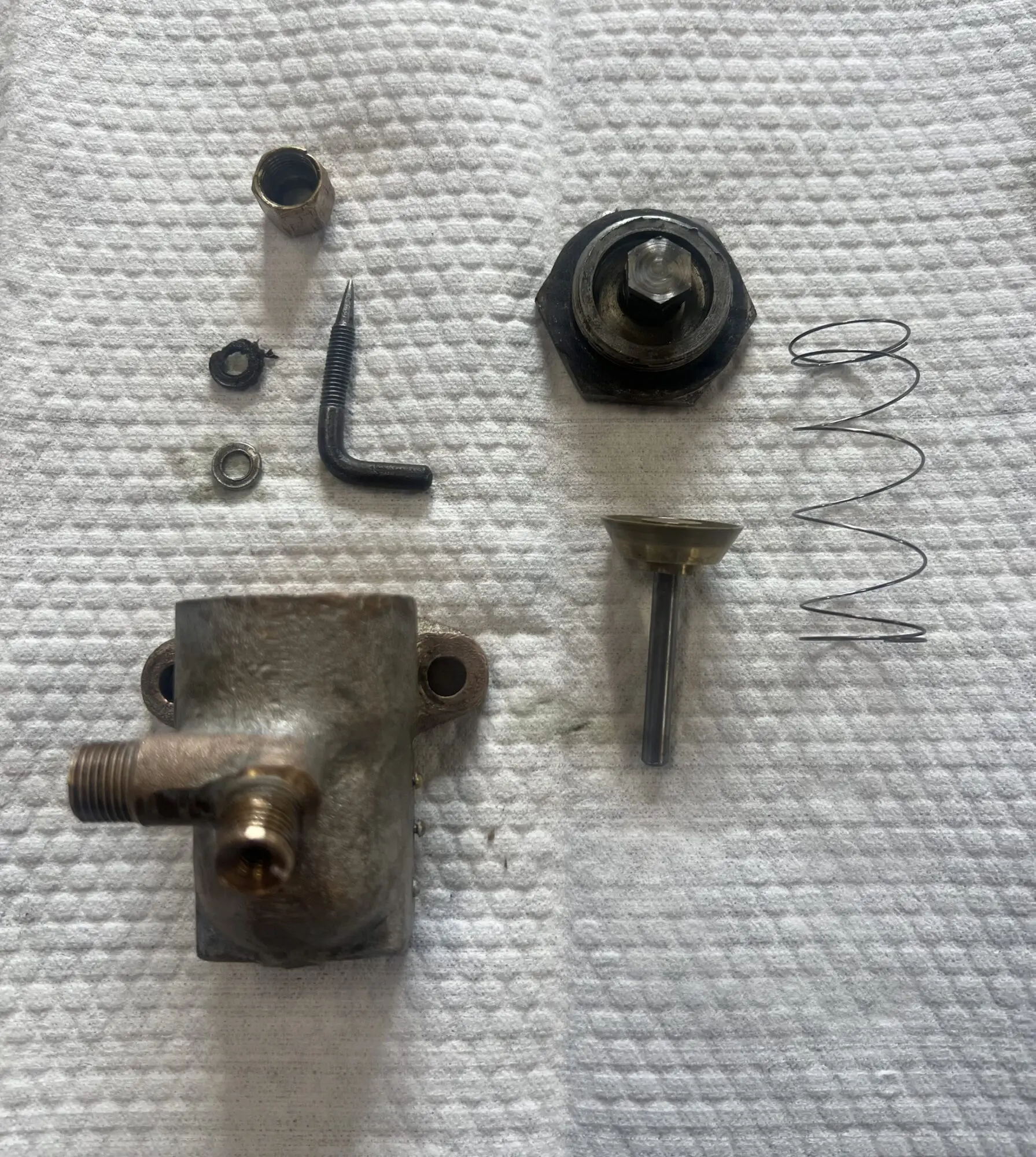

February 16, 2026 at 9:57 am #304698This old thing is leaking just about everywhere! I sealed the tank that was leaking at the seams. I need to make a new fuel line and it’s leaking around the adjustment needle to boot! The threads for the neeedle’s compression nut are buggered up a little, so I need to parse out what the thread count and pitch is there on the mixing valve. The packing around the needle, in said compression nut is also shot…any suggestions for a replacement? I was thinking of trying to make a new one out of a thin chunk of leather…
February 16, 2026 at 10:24 am #304699Take some yellow thread tape, it is for fuel.
About 3 inches long and roll it so that you end up with a 3 inch long piece, then lay it in the packing nut, cut it o the length you need.http://www.richardsoutboardtools.com
classicomctools@gmail.com1 user thanked author for this post.
February 20, 2026 at 2:31 pm #304891I tried making a washer, out of a little twisted yellow teflon tape, but the thickness of the tape – which wasn’t very much – and the backing steel washer, put the compression nut right in the middle of the buggered up threads around the adjustment needle. Retapping the 7/16-24 threads didn’t help. So, I did away with both washers and wrapped a little of the teflon around the threads of the needle itself. The tape holds the needle from vibrating loose and now the compression nut can reach some better threads farther up the way. Best part is there wasn’t a giant puddle of gas underneath the old THOR this morning! Seemed to run okay too, for a few seconds. I’ll dunk it in some water, when the glacier recedes!
