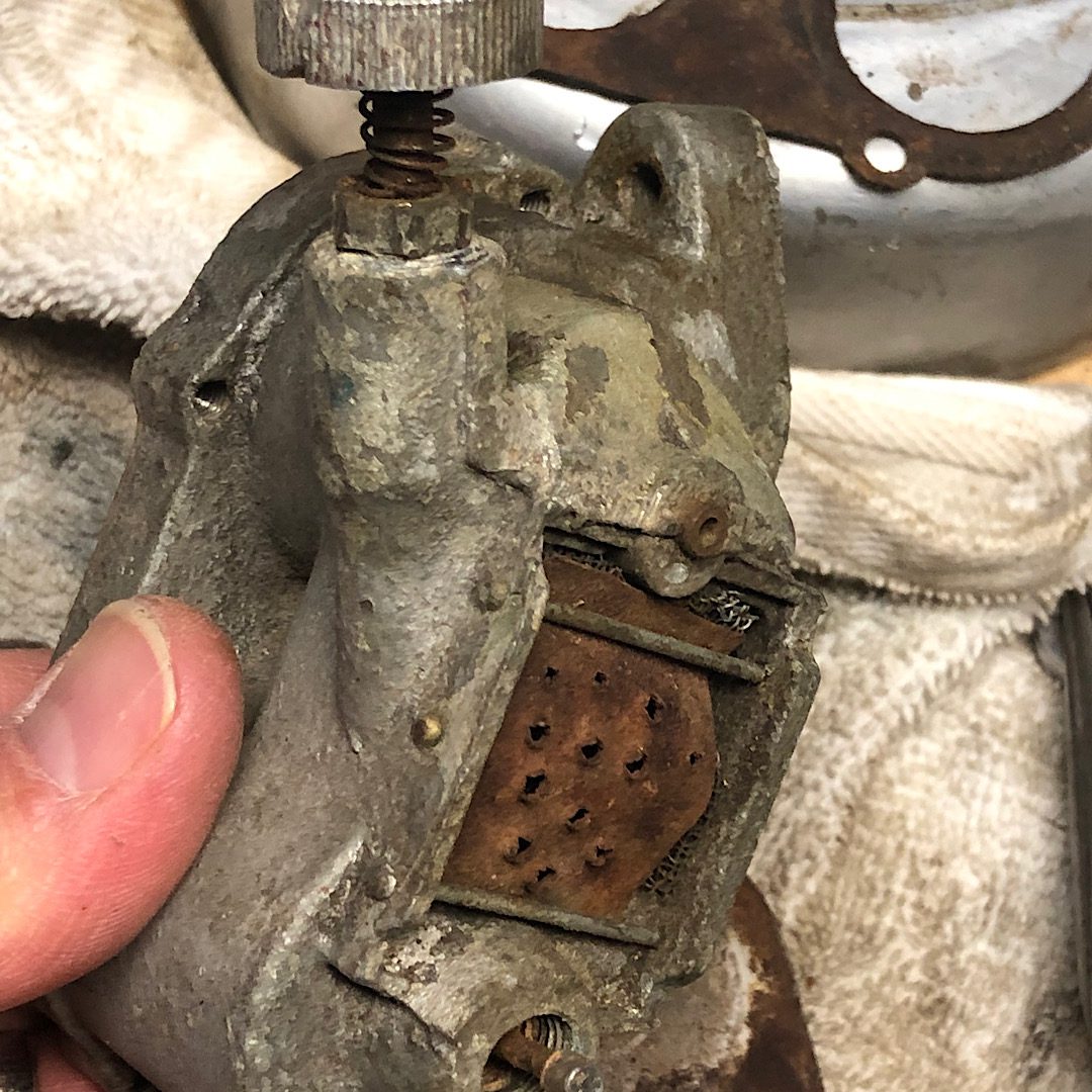

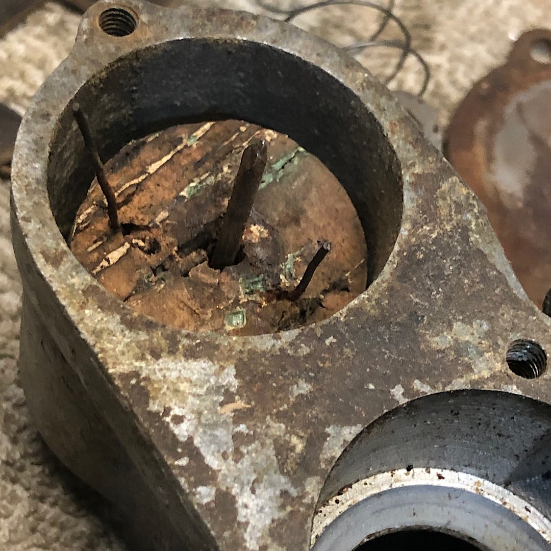

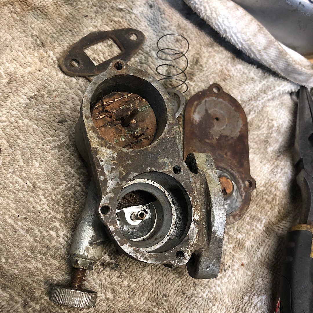

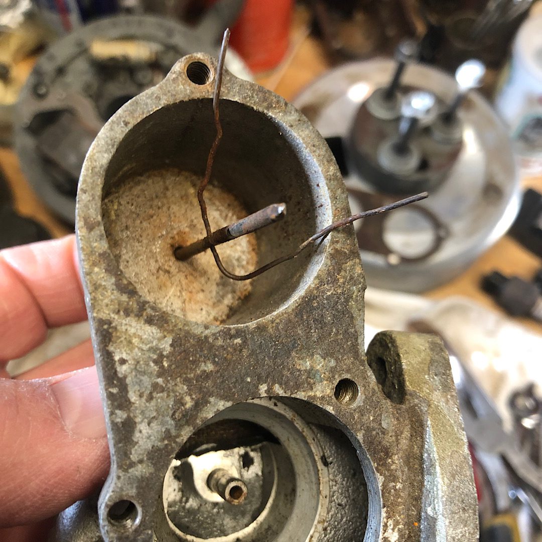

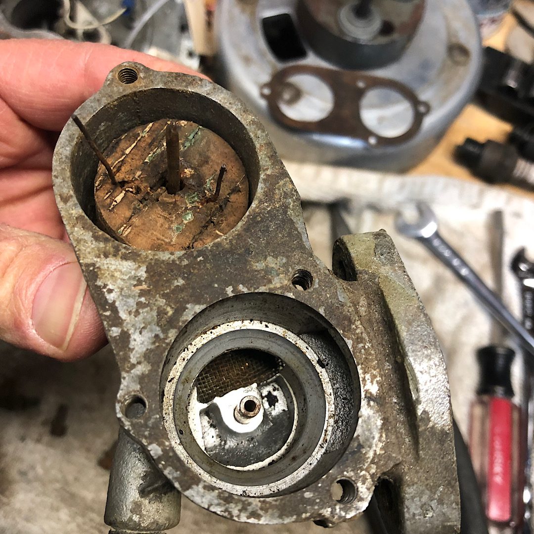

      On this Thor twin poppet valve carb I can’t see how to remove  the pin from the cork float. No tiny spring clips like on many models but there is a wire (see photos) running through the cork. Maybe it twists around the bottom of the float pin? Don’t want to manhandle anything and cause damage.
      Anybody been here before?
      Any advice welcome! And thank-you!
      Scott

        It looks like someone made a float pin out of a 12d nail,
        and put a loop of bailing wire through the cork, and perhaps
        twisted the cork so the wire wrapped around the float pin.
        Just a guess, but I’d did it out by any means possible and
        start over fresh. I’d be surprised if that’s an original setup!

          Thanks Buc! I think we’re on the right track with that. I believe it’s a nail too. The function of the pin is to rise with the cork float as fuel enters the bottom of the bowl and seal it to prevent flooding, correct? I wonder if this homeade pin is doing the job. I guess I’ll find out arter I get it cleaned and rebuilt.

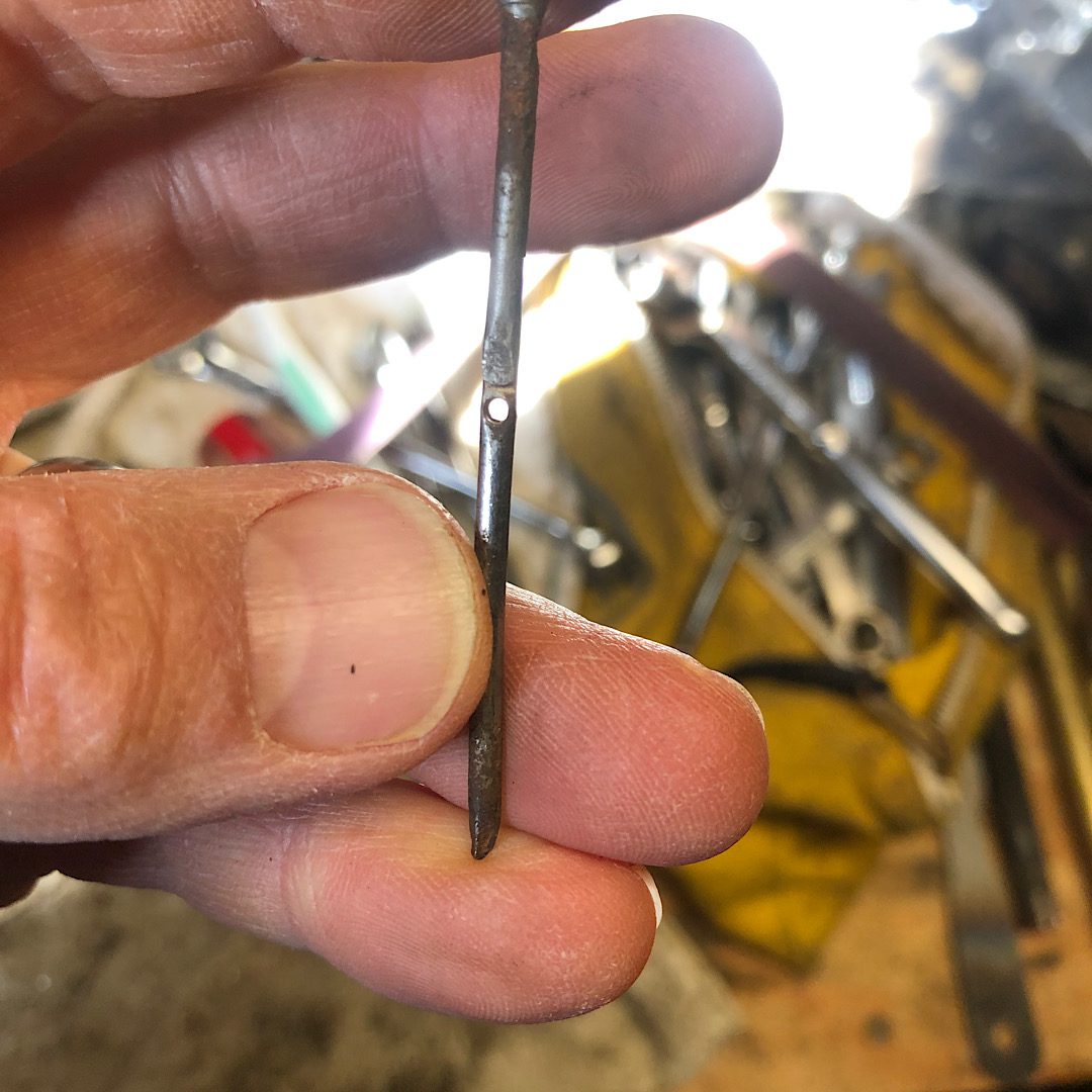

            There is no way that was working. Its
            often a challenge to get the right parts to
            seal good enough so the curb doesn’t run
            over. With luck the seat isn’t damaged.
            PM me your address and I’ll send you a
            float pin and a couple clips to position
            the cork you can try.

                  Great picture Tubs. I may have a spare gloat pin in my parts stash. What motor is the pin from that you had in mind?
                  And I agree. The PO flattened the nail and drilled a hole to route the wire. Pretty ingenious but that’s probably why the motor got parked. 5F54077D-88B6-4891-BACD-A13D90930452

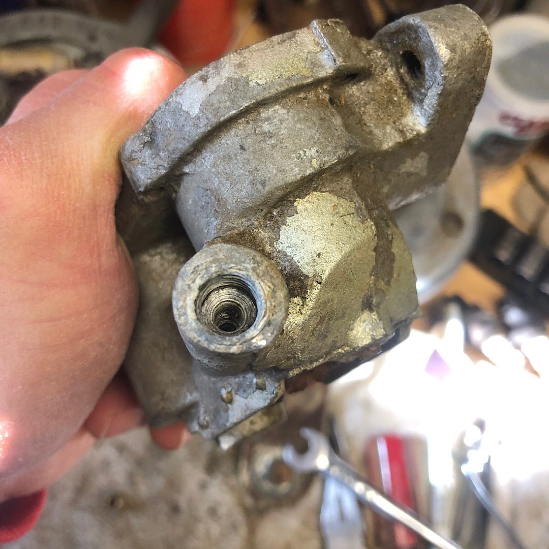

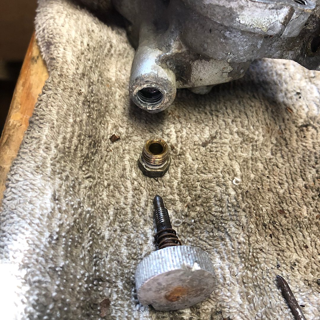

                      Here is a picture of the seat. Please let me know your thoughts. Looks normal to my untrained eye.

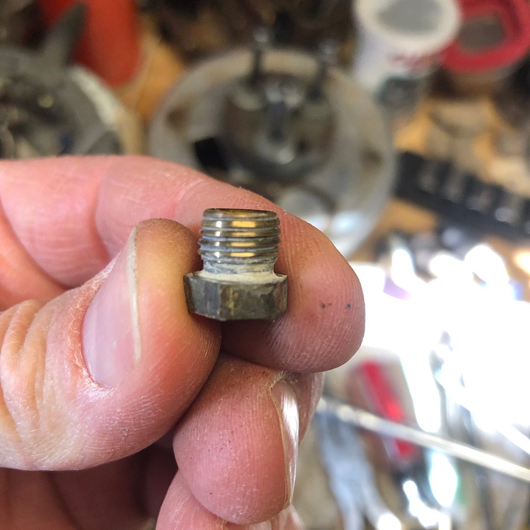

                      Another concern is the packing nut for the adjustment needle. It looks like the seat in the carb body would require a tapered packing nut. The nut I have is not tapered however. Do you think it is supposed to be? B750421A-B07B-4024-9272-CA09740EEC5A

                        Seat looks OK in your picture. When you get
                        the needle spin it in the seat with some tooth
                        paste keeping it aligned as it is when the float
                        bowl cover is on. If you want to try a polish rub
                        some between your fingers to be sure there isn’t
                        any grit. No mail today. I’ll get it out tomorrow..
                        Packing nut looks OK to me. It looks to have
                        the same taper inside as the carb body. Tightening
                        will push the packing around the shaft of the needle.
