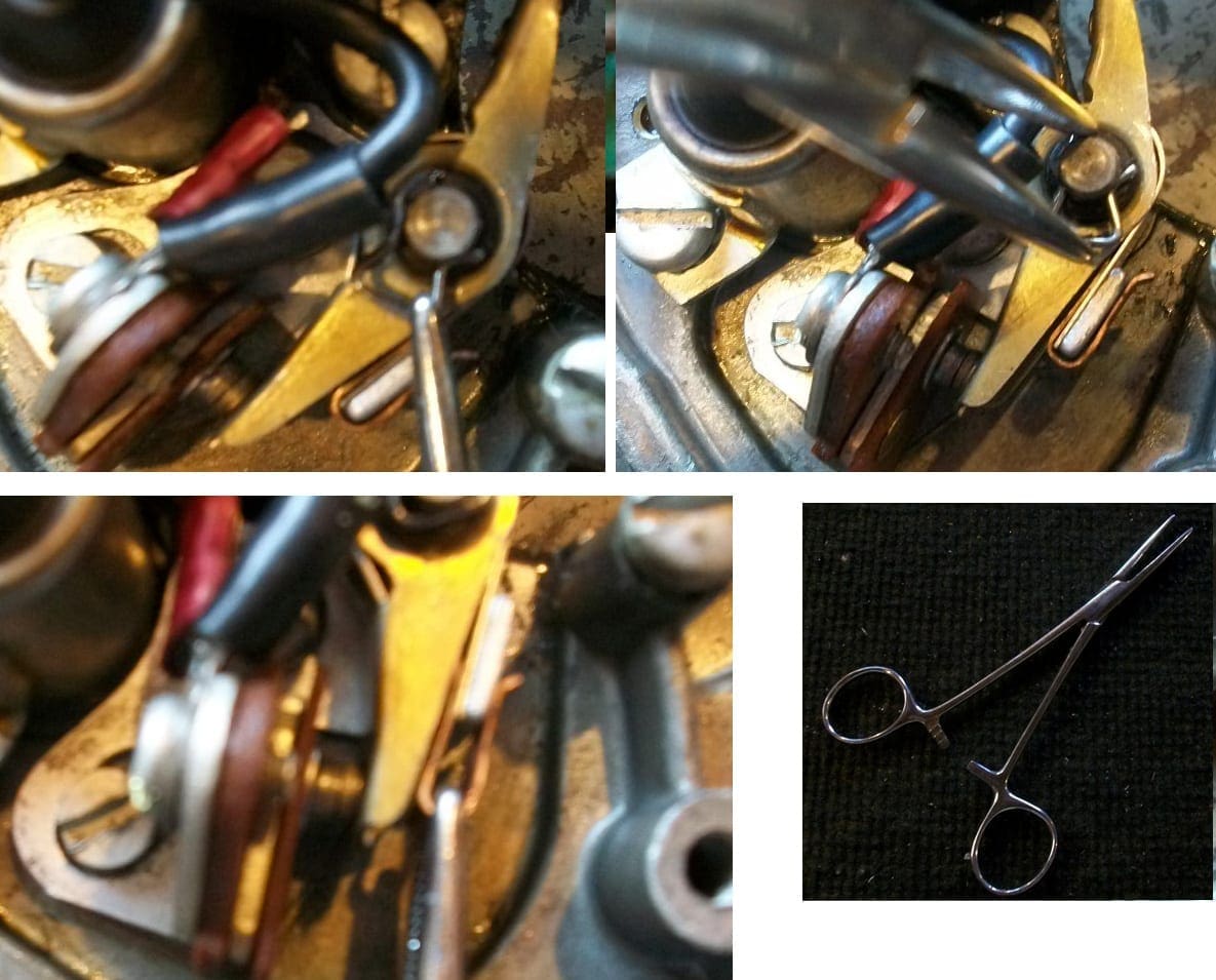

        You betcha. Forceps?, hemostats? Whatever the docs call them.
        Forceps
