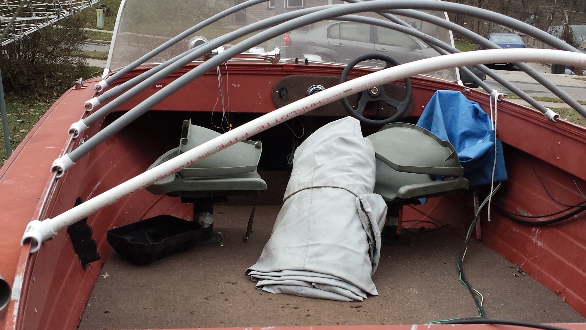

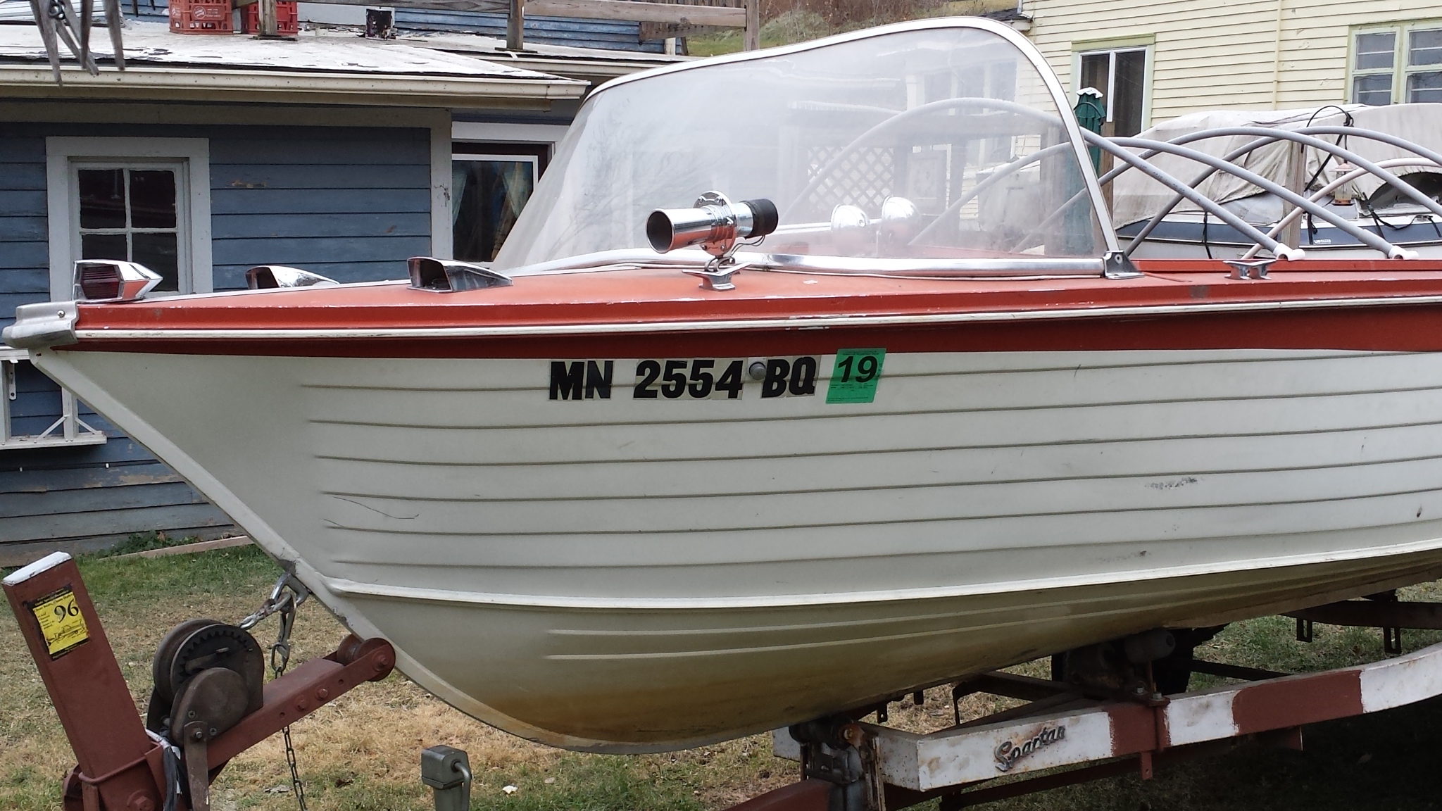

      It’s a heavy welded hull. Paperwork says it weights 800 pounds, which makes it about as heavy as a glass boat of the same size and really heavy for a 16 ft aluminum boat. There are few structural rivets in it except for around the transom and splash pan. It had a built-in tank in the bow. Tank is gone but fittings are still there.

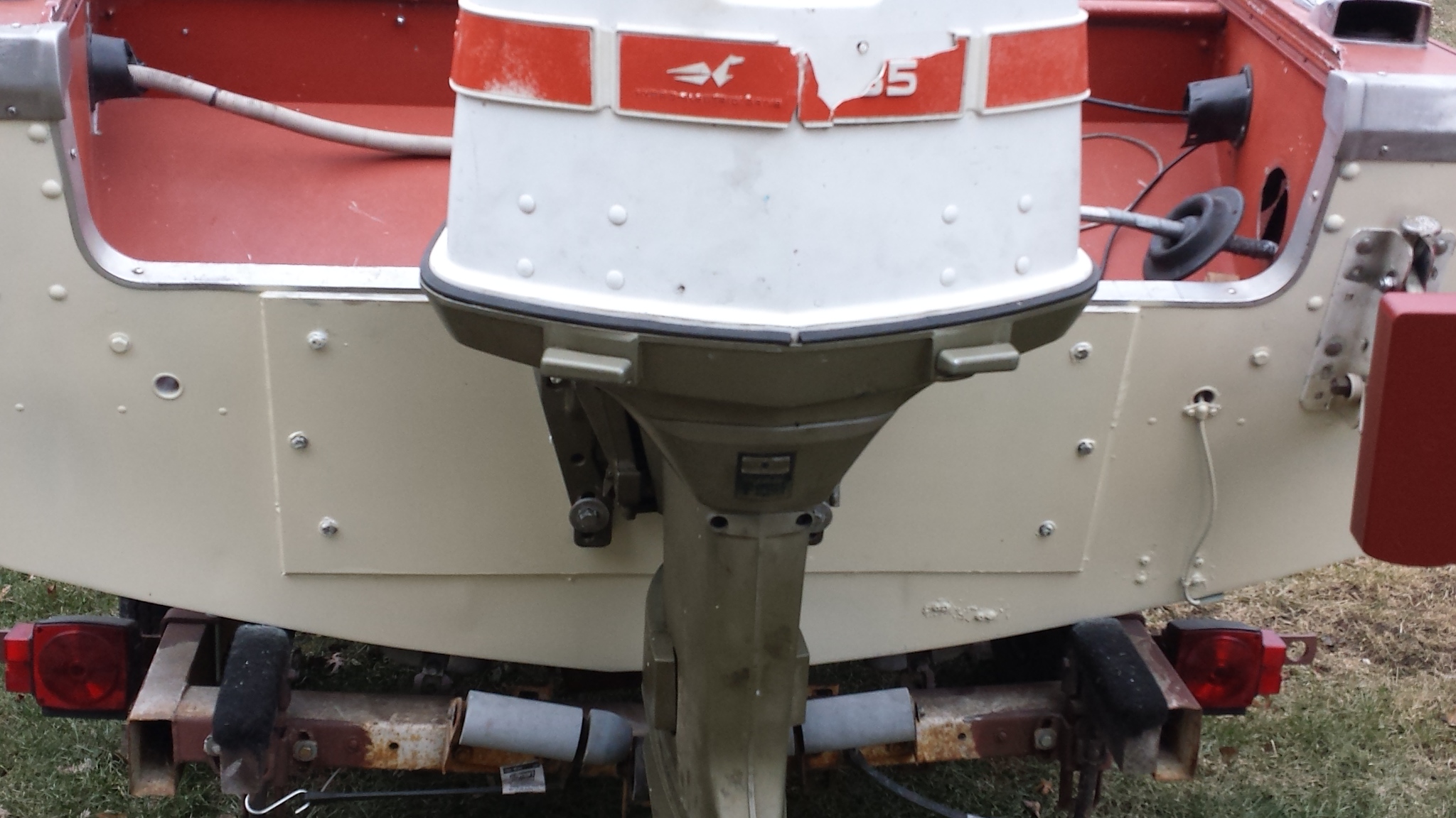

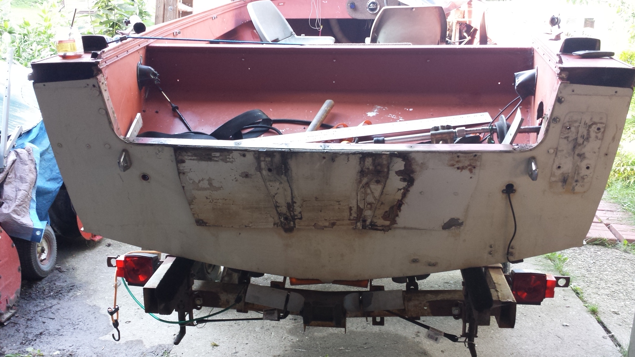

      The transom was damaged, and the design is odd, with just one wooden piece about 5 inches deep running across just below the cutout. I ended up putting a piece of 1/4" aluminum plate on the outside and it seems pretty solid.

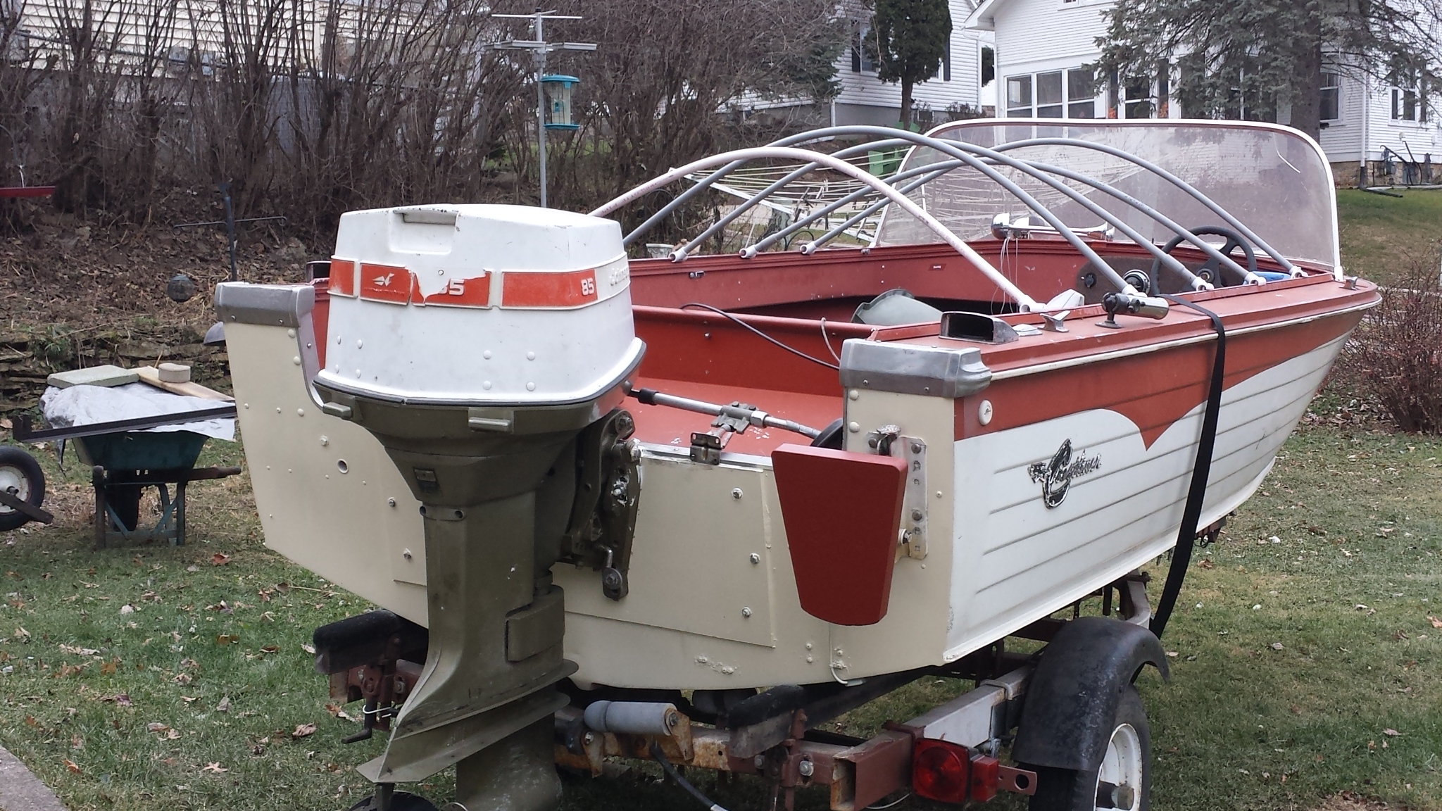

      I’m having some second thoughts about this hull, wondering it if’s too heavy to perform well with a 55 hp motor. It’s rated at 100 hp max and came with the 85 hp V4 shown in some of the pics. (For sure it’s too heavy to move around the yard by hand!)

        It might be heavy, but it looks like a solid/stable performer to me…
        It will perform great with the 85hp also, nice job repairing the transom…
