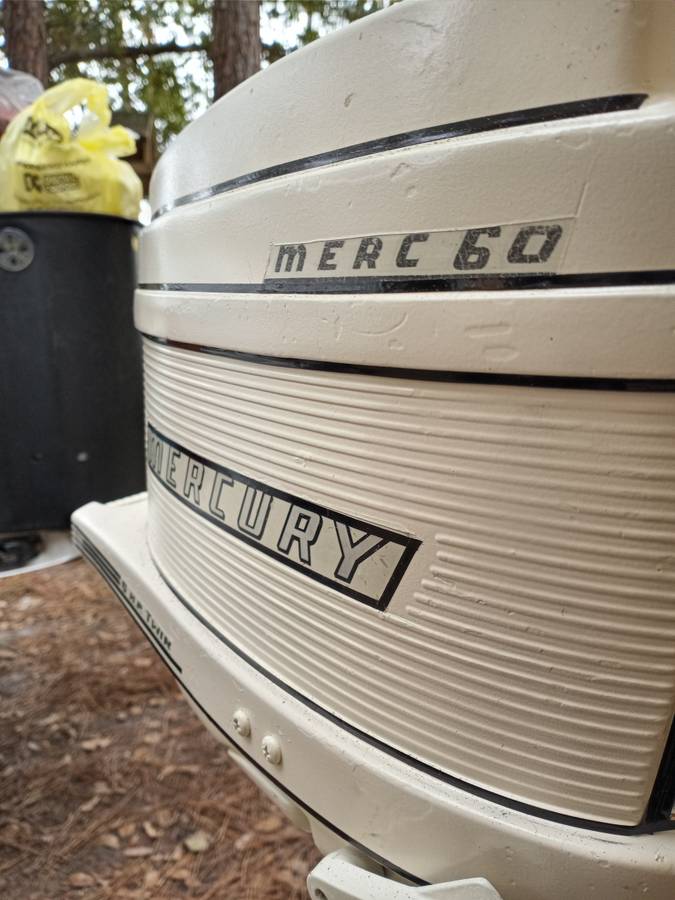

            The motor looks to have been re-painted. I bit too white? Quality of the paint will be hard to evaluate until you at least see it first-hand. Even then it will be a while before you realize how durable the finish will be.
            When you check the lower; also be suspicious of fresh oil. Sometimes people put fresh oil in prior to a sale so it will look god and perhaps conceal a leak.
            Maybe someone else will give you compression numbers to look for.
            Someone put a lot of work into it. I would ask who did the work and what mechanical work was done…..

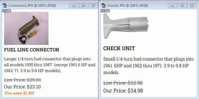

              comes with fuel tank and connector…?? if it is the small Merc fuel connector they are expensive…to some extent
              In Canada that hose connector has a asking price of $138 and taxes…on Amazon.ca !!
              I ordered it from Amazon.com $58 CDN incl shipping
              tank and a hose & connector if not supplied ………. would set you back another 100$U$ +
              $475 US means 600$ CDN & it means to much for me 🙁
              update: yep white originaly…. the small fuel connector was used up to 9.8s if I am not wrong

                This motor has a fuel pump right ? So no pressure tank ..
                I’m only guessing but it should have the same fuel connector as my 62 450 Merc ?
                #251803
                CHUCK
                  Yes it has a fuel pump. I think however that the fuel connector is different (smaller) than on your 450 unless someone has made modifications.
                  The smaller motors of that vintage used a smaller diameter connector. They are available or you can modify the 6HP to use another connector; at least until you fine the correct parts.

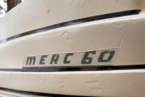

                  His pictures are of sufficient resolution to see that the paint work is kind of sloppy. He didn’t sand the nicks and scratches very well….and of course the color is wrong. Too bad.

                    Merc 60 side logo…. strange… number 0 is..a smaller size than the # 6 almost looks…….. fabricated and stuck on the side.
                    why would one paint it the wrong white color …even without doing some bondo on the deeper scratches…?

                      OK, well it is obviously repainted, and not a real great job. I would be hesitant to spent that kind of money on an engine with a quick paint job and little else. There were no pictures of under the hood or explanations of repair work performed, which makes me think there was very little done to it. I am no expert on the old Mercs for sure, perhaps someone that is will chime in. Jacksonville is near the ocean, so I would doubt that the engine has only been used in fresh water….

                        All good points .
                        No way I would have left those dings and dents and paint over them .. .
