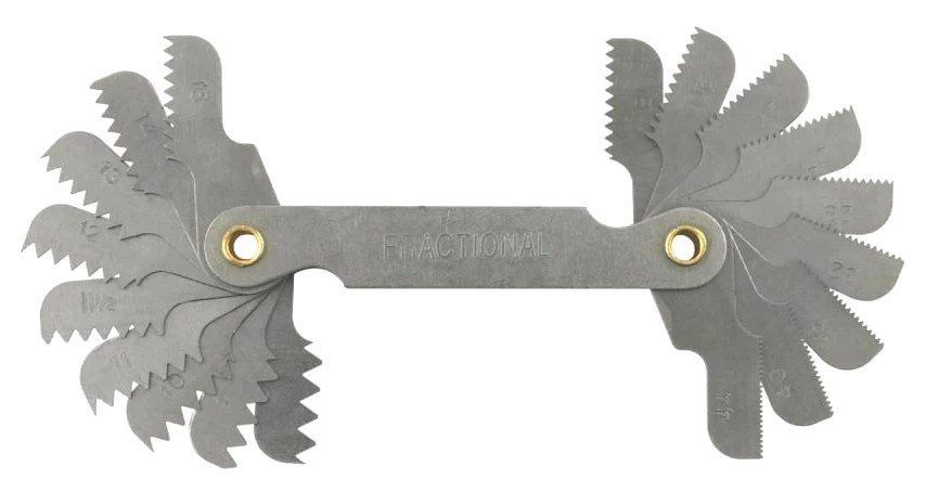

          Steve D
            A thread gauge tool like this has come in handy for me a number of times.
            thread-gauge

              joecb
                I think that it’s time to post the chart again. The old ASME screw thread standards.  Use caution when encountering a thread that appears to be a 1/4 inch, note on the chart that there are three screw sizes that are real close to 1/4 inch…. some unusual thread pitches also. A micrometer and thread pitch gage is your friend.
                Joe B
