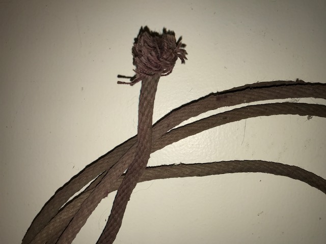

      I had my father’s 1940 Century Whirlwind restored and need to figure out some of the details to complete the project. The tiller rope (correct term?) was still on the boat when I pulled it out of the barn but being over 60 years old and not completely protected by the elements, it’s a little worn. In other words, I would depend on it to do its job for very long. Anyway, I was wondering if anybody could point me in the direction of a source for a replacement. See the picture. It was obviously red when new and it appears to have some sort of wire running through it because it holds it’s shape when you bend it. Does this look or sound familiar to anybody? Please let me know. Thank you very much for your help.

        Yes but the newer stuff is much better I would use that.
        #72371
          If you care about originality, that stuff is still made, though we quit using it many moons ago. https://www.mcmaster.com/#wire-core-rope/=1bxegkt
          Better is the clear plastic-covered stuff. You can get that anywhere, like Home Depot, Lowes. Ace Hardware, etc

            Awesome! I’m probably going to go the original route. Your help is very much appreciated!

              Interesting, I didn’t know that they still made the wire core cotton rope. However the McMaster listing does not specify the wire material, got to assume hat it is steel. If remember correctly the old stuff had a rust proof bronze wire core.
                Joe B
                That was my thought too. What’s the wire core made of? High quality clothesline used to have a bronze core and didn’t stretch much if any.
                Some very stretch-resistant synthetic lines are made for sailboat running rigging. I wonder how these would do as tiller rope?
