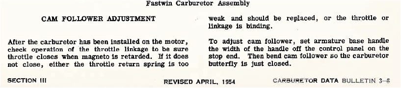

      1952 Evinrude 14hp Fastwin, Tillotson carb. How do you sync this motor? I see no way to adjust the throttle cam. Thanks as always.

        I found this in the ’54 Service Manual.
        Fastwin-Carb
        #204752
        jerryswiss
          Ha, thanks for that. Now can someone translate.
