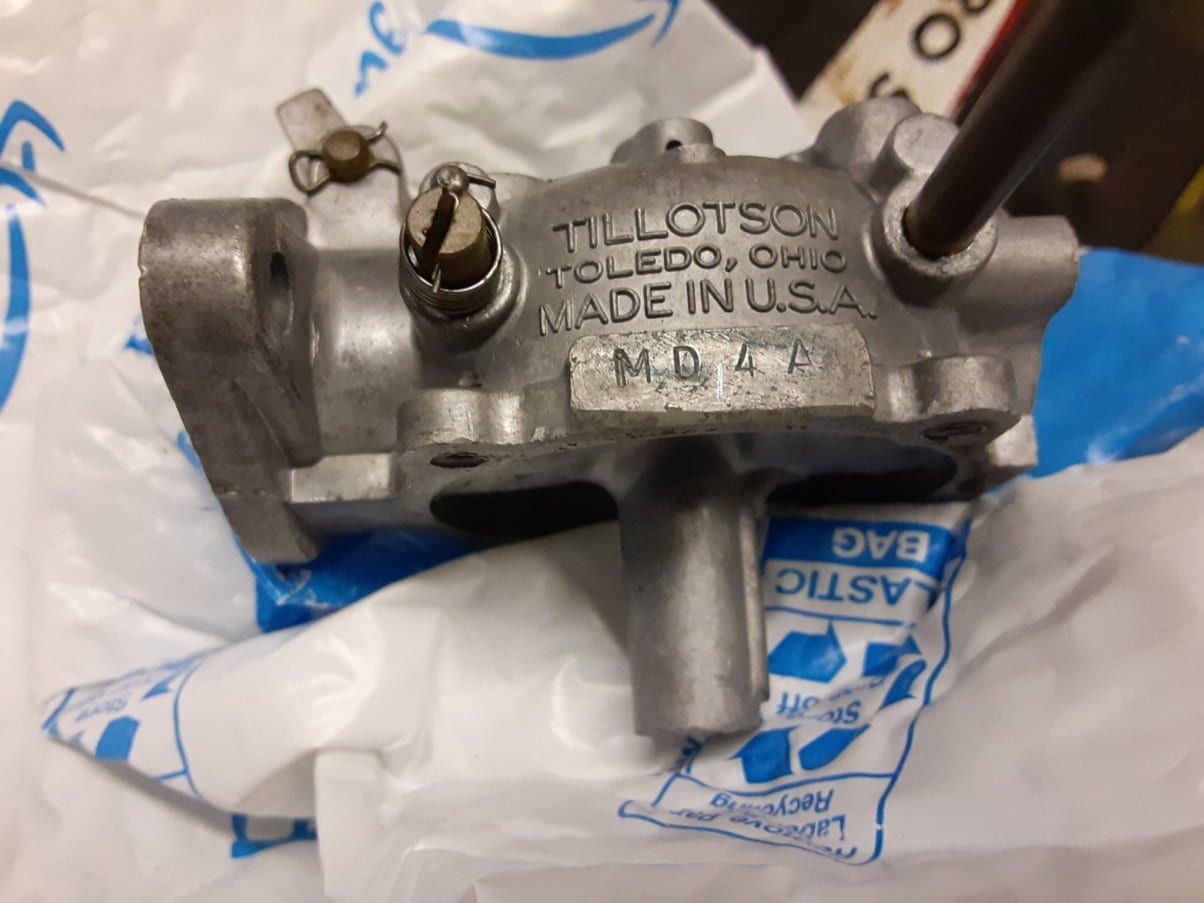

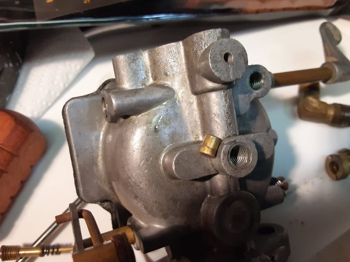

      Does anybody have a diagram of this carb? This part fell out and I don’t know what it is for and if I am missing a spring. I think it went in this hole but not sure.
      Thanks Ralph

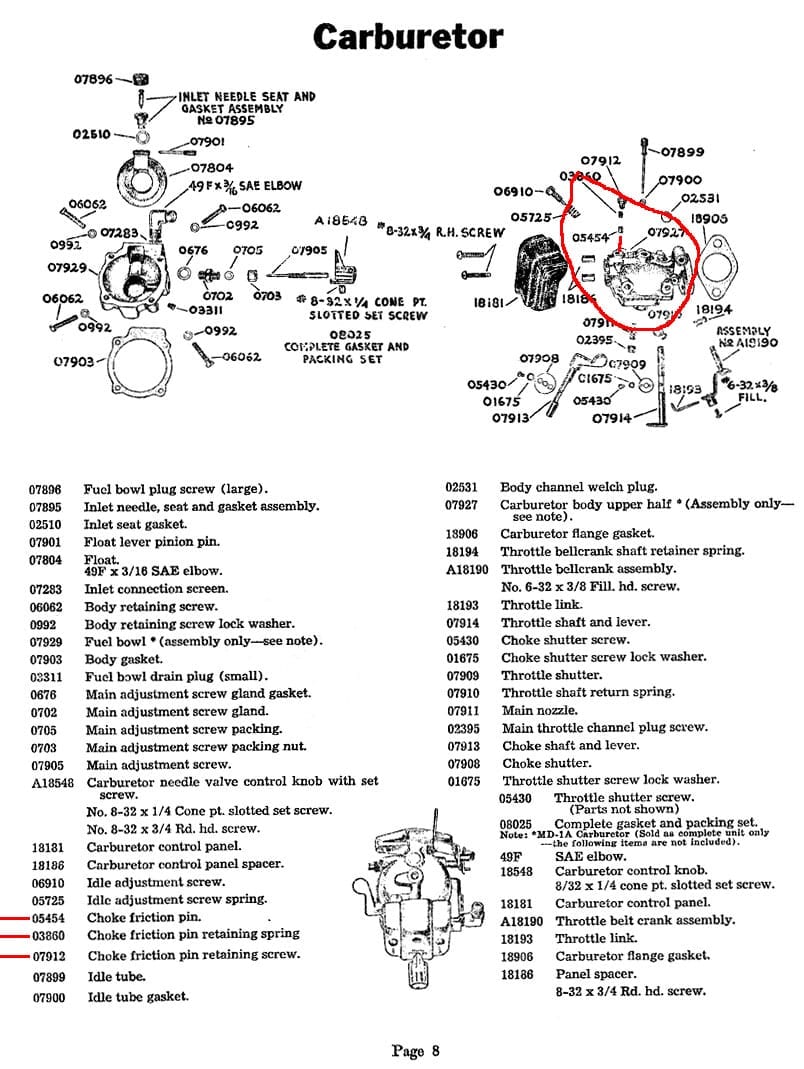

        Choke friction pin
        NOTE—this is 1.25hp Elgin carb

        #216382
        seahuntboater
          Thanks Frank. I will double check if the spring is in there. Guess I could make a spring with the idea being to just keep choke in place.
