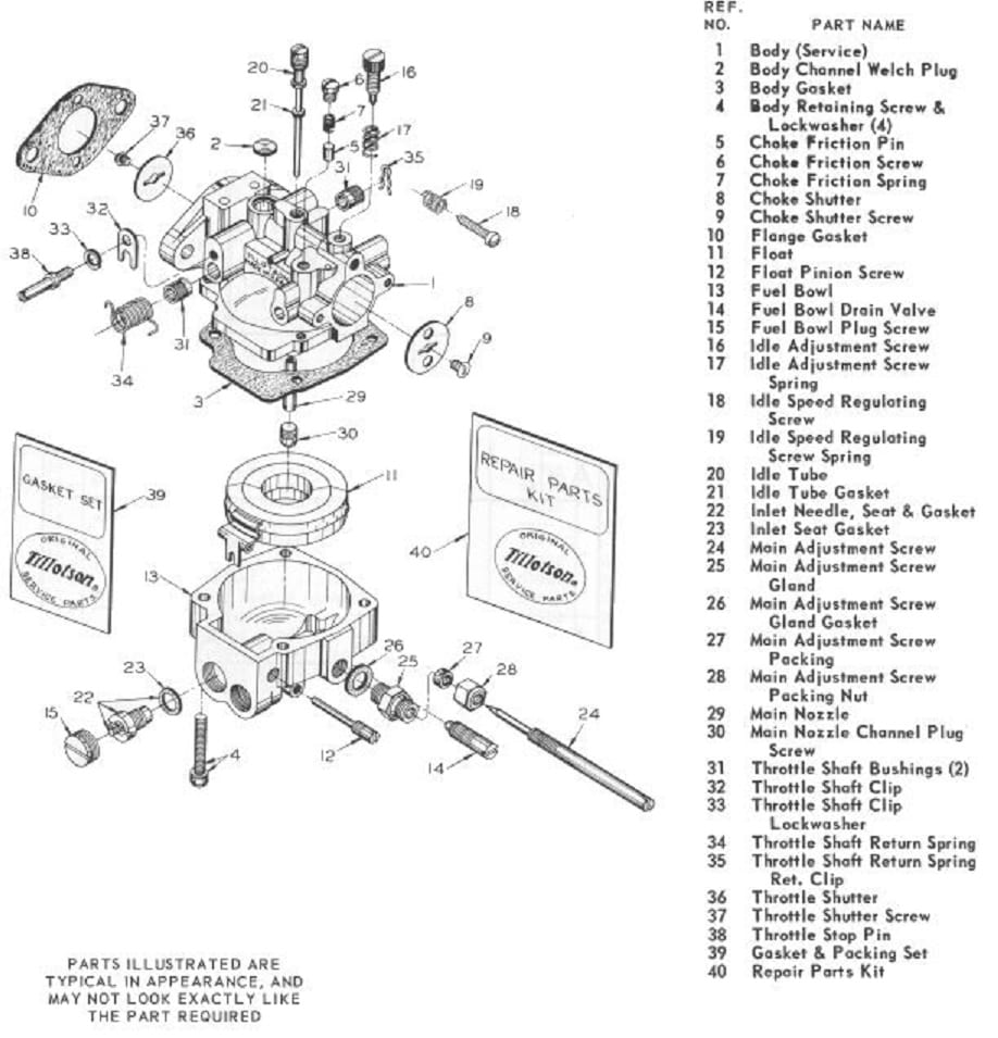

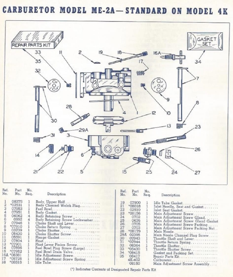

      I worked to get my grandfather’s ’45 or ’46 Champion Outboard running and was successful however after many attempts at working on the carburetor I am not sure that I have all of the gaskets required for the ME1A carburetor. Does anyone happen to have a digital copy of the parts list that they would be willing to send me? I would really appreciate it. You can see an example of the page I need at this link:

        This one is filed as for a 1947 2J Champion. It doesn’t say the carb model number.
        What model Champion do you have?
        Champion-2J-Carburator-1947

          This is a Tillotson ME-2A, which is also listed on the EBay kit.
          Tillotson-ME-2A-diagram
          #241790
            Looks like the single cylinder Champions used the ME-1A
            Tillotson-Outboard-Motors-Carburetor-Applications-and-Descriptions

              Thank you very much Buccaneer! It is a 1J and now I can tell that I may be missing the inlet seat gasket.
