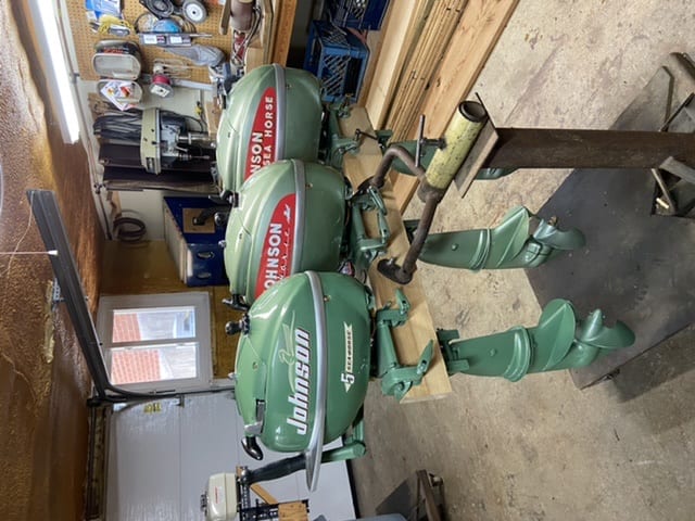

          Boonie
            I paint them.

            #229365
              super nice !! not like mine in the shed which I refurbished but…never used
