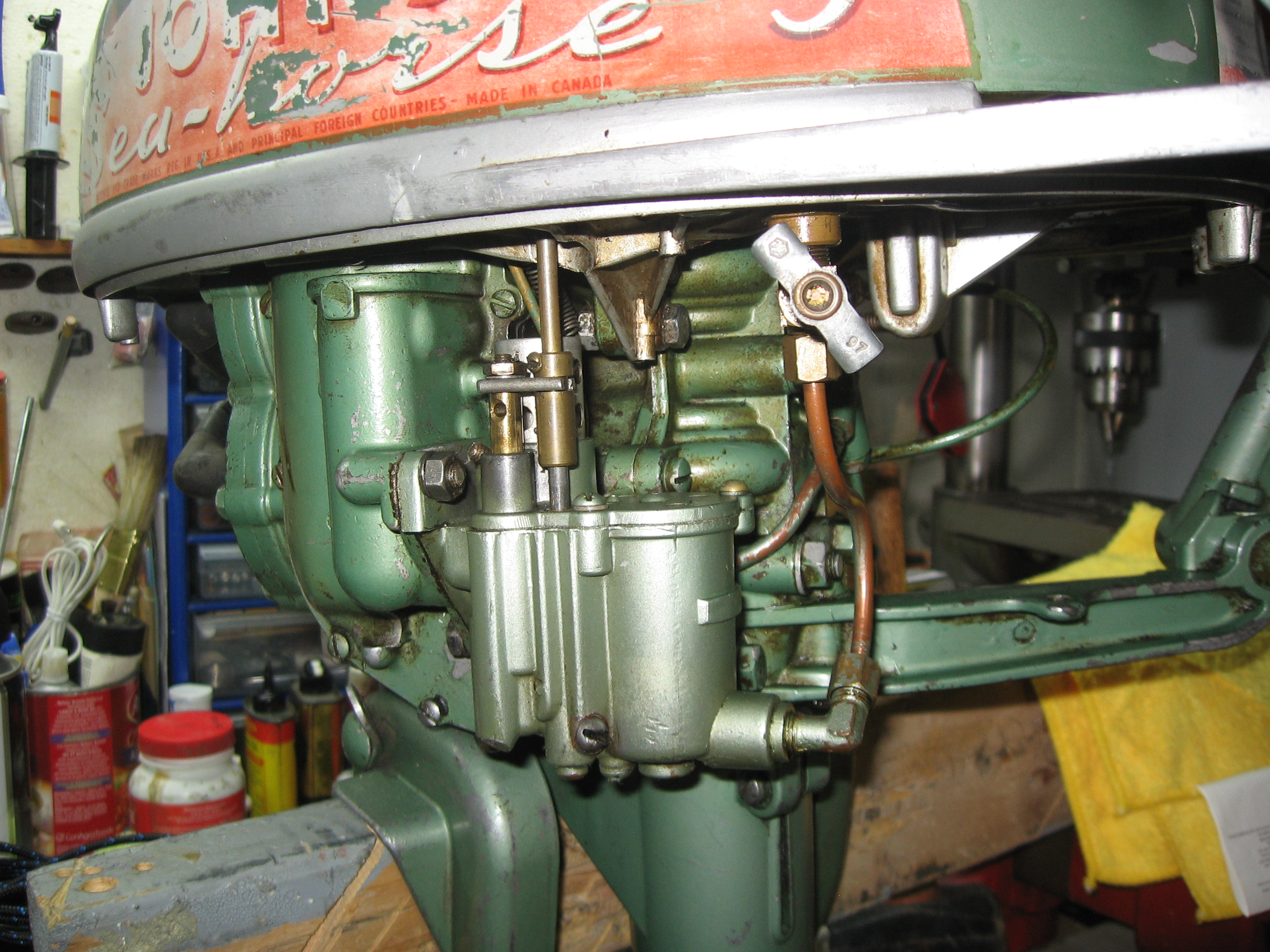

      the carb adjustment and primer plunger is attached to the carb with a small screw just next to the nut
      I assume the plunger rod should simply pull out/up to allow it’s removal when you remove the tank but it is not.
      at this stage I do not want to damage anything but it doesn’t is there a trick to this plunger rod disconnection from the carb body /primer ?
      thanks
      #69249
        Easy–remove the nut. You can stick something through the hole to prevent the plunger from rotating as you do, if necessary.
        #69256
          good point I assumed the vertical shaft would have just pulled out but removing that side nut will do if the whole thing can be pulled up with the tank
          the fuel valve T handle also need to be taken out to snake it up trough the frame supporting the thank . I disconnected the neutral shift cable
          next step is changing plug wires and points …points may still be good if not to pitted….or worn on the rub block
          we’ll see as I work myself in this oldy.
          thanks
          UPDATE….. the nut did it fine Frank…… fuel tank is off ! digging in 🙂
