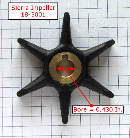

      will the sierra 18-3001 fit directly as a replacement to the original 375688 prop ???
      I have a spare JW impeller on hand.. would that fit a TN 27??
      #70048
        The new impellers thickness and diameter are the same as the original but the TN shafts were slightly larger in diameter than the later small OMC motors. If the impellers bore is honed out a bit, it will fit right in.

          Slight typo there I think. The TN shafts are larger, not smaller than the 3, 5.5, 7.5. So, bore the impeller out to fit a TN-xx.
          #70051
            great I’ll test this out with my spare impeller for a JW

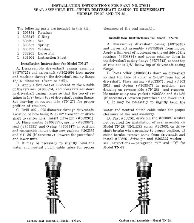

              I saved this in my files from a long ago post,
              regarding TN-28’s. Are they they same as the TN-27’s?
              Also, a page regarding the carbon seals.
              #70056
                thanks… saw that article in the Johnson maintenance bible… i’ll measure my tn27 shaft and drill the impeller out
                thanks

                  #70058
                    All TN’s are same size. I’m thinking the shaft is 0.437" but could be wrong. Now I gotta go out and measure one. A few years ago, I tooled up to bore those things to sell, but discovered that another club member was already doing it. So I didn’t go into competition with him. Now I don’t remember who it was.
