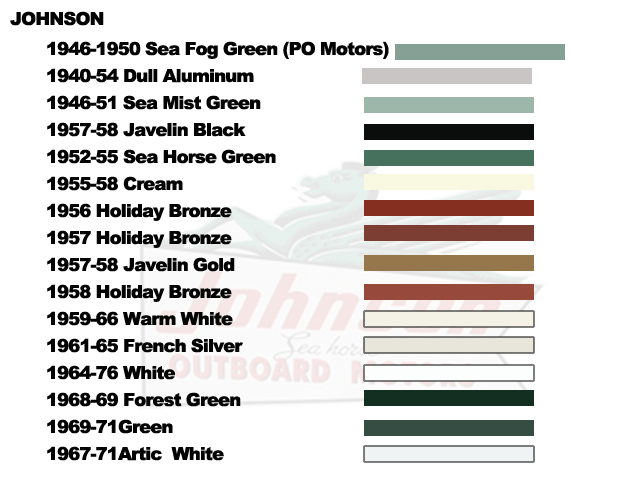

        This is all I have – sorry . . . 😎

          Thanks Garry But I don’t see mine listed

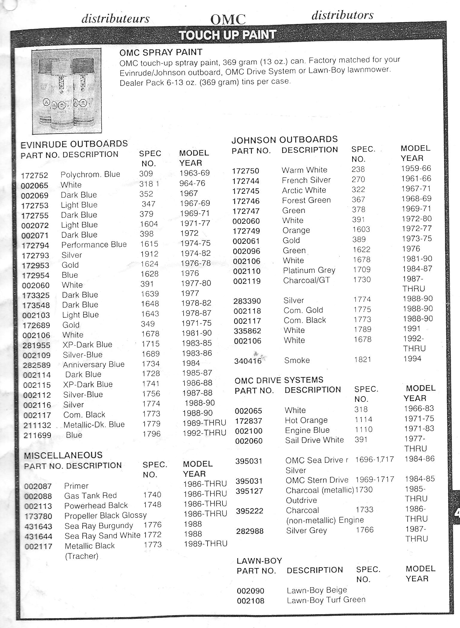

              According to an older copy of OMC Parts & Accessory Catalog the touch up paint you seek is Anniversary Gold. Original #172691 SS to #771251. It is available at MarineEngine.com among other places. OMC color code is 72GJ1 & engineering spec is 389, but no PPG code is given for you to have any mixed. Hope that helps.

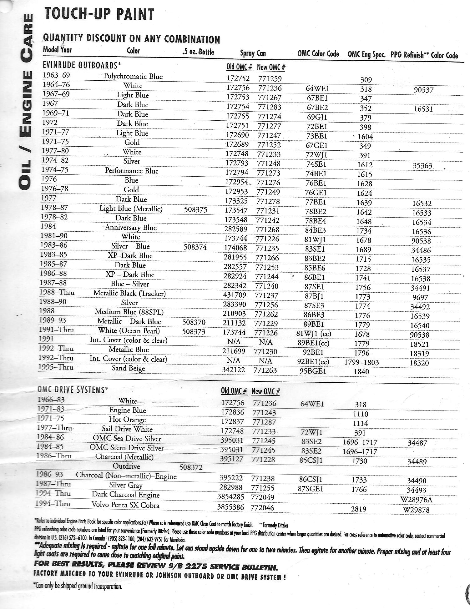

                  I’m pretty sure Dan is right, that green might be referred to as a gold and I had that color custom matched in base/clear several years ago. If I look around, I think the can with the formula on it may still be here.
                  OMC paint codes.
