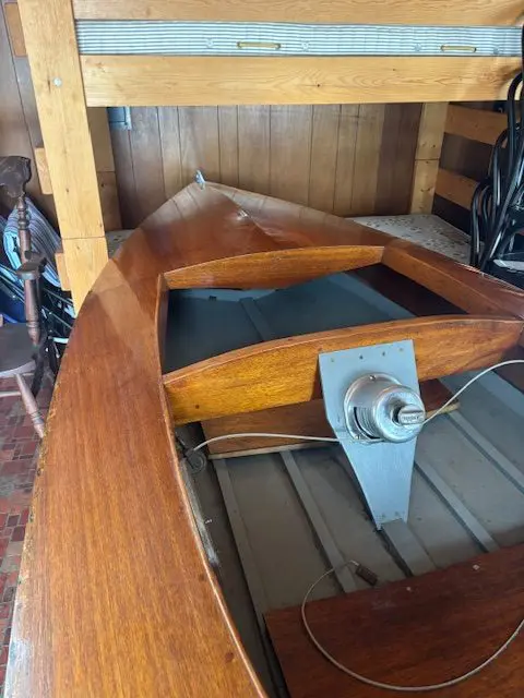

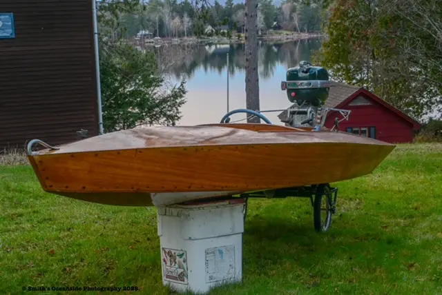

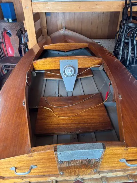

      I recently got a trailer for my 11′ Blue Streak, a B-Stock Utility Runabout.
      It is mahogany plywood over a frame. It stays inside over the snowy winters, but has to be outside in the summers.
      I understand that the wood has to breathe, so I’m wondering good, safe, covering options for the summer and occasional rain. Also wondering how to keep the boat protected while trailering, as I tow it with my sedan.
      I personally am used to towing F/G sailboats, and other larger boats, but I’d like to be as careful as I can with this one.
      Any help would be awesome, thank you!
      Photos of boat below.
