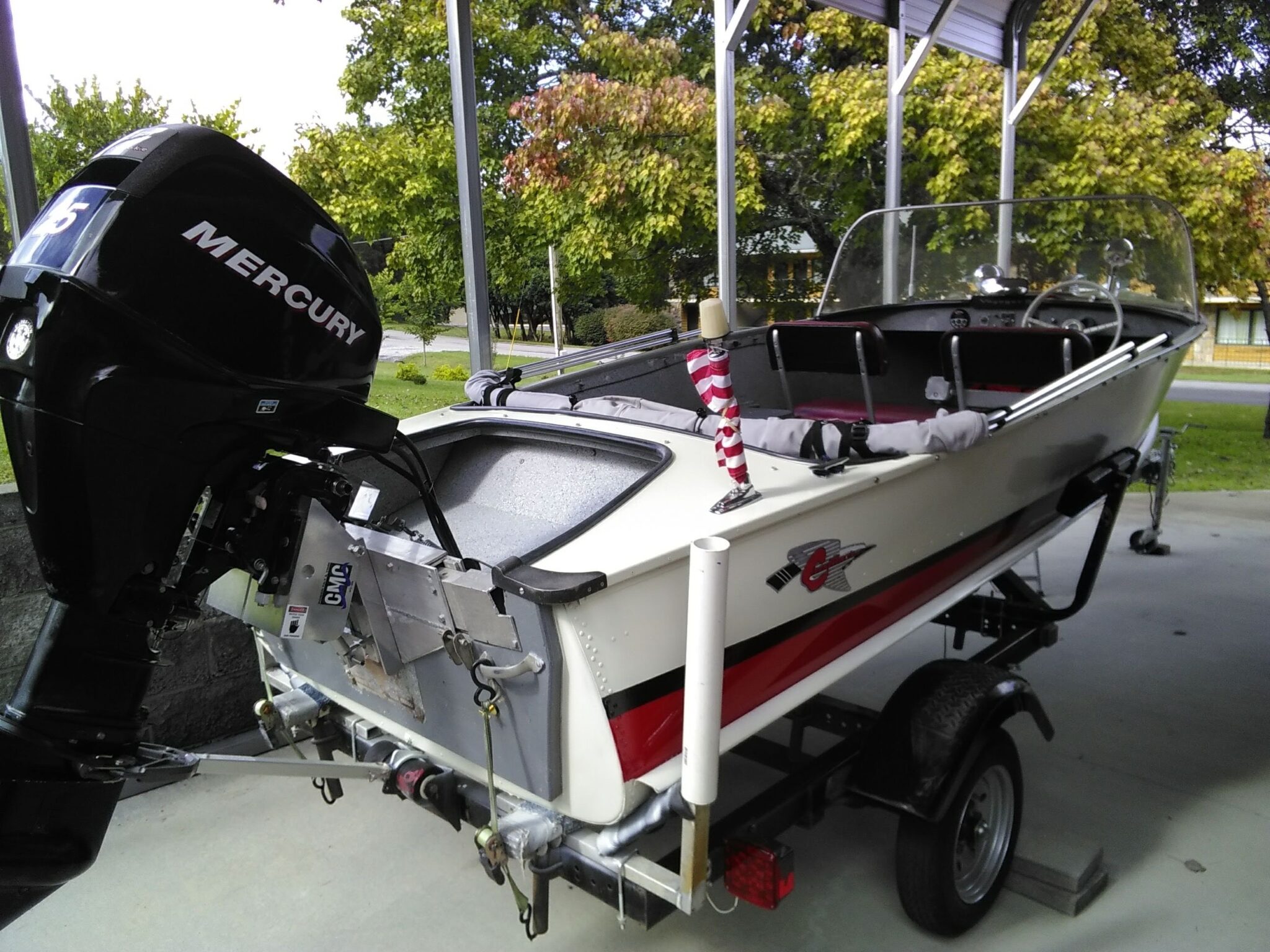

March 19, 2022 at 8:40 pm #256506Yes, Transom saver rod, is the way to go. I use one on my (heavy) 1961 75 Evinrude and also on my 1957 35hp Evinrude. Both set-up have the butt end of the rod fixed to the trailer rear cross member.

March 19, 2022 at 8:42 pm #256507Yes, use a transom saver support bracket.

A tilt lock is going to stress the transom, especially on
some of the roads to some back water launch’s.
I use a motor toter even with my 3hp Johnson.
I figure the farther I can get the skeg from the black top
the better.
