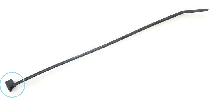

        I have found that 7" or larger zip ties do not make a good seal; it is better to use twisted wire (improvised) or the proper size full circle clamp. I haven’t tried 4" zip ties.

          In all honesty, if I come across an outboard with that stuff on it, I replace it with the black gates hose. I just don’t like it, mainly because it seems to harden with age. As far as using tie wraps on hose, there are specially made one for clamping fuel hose. These are regular wire ties with special built in "hook" that wraps around the hose. McMaster car has them. Mercury and BRP also offers them.

                  As for zip ties, I don’t think the regular ones pull down well at the seam. But little gear clamps don’t either–they go into a "D" shape. Can use special hose clamp zip ties or put a little piece of aluminum sheet, etc, under the joint. In the end, there’s a lot to be said for old-fashioned metal spring clamps. JMO.

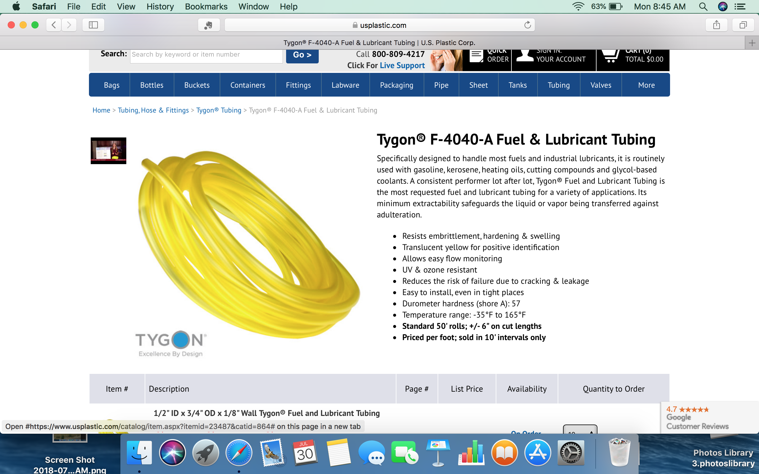

                    Tygon is the brand name for the plastic hose that seems to be the most common hose used on chainsaws,weedeaters etc.
                    I repaired 2 used weedeaters and a leaf blower given to me that the hoses were cracked on. That is all that was wrong with them.
                    In this US Plastics/Tygon attachment, there is no mention of being compatible with Ethanol fuel, which these days is a must.
                    So it seems like this type of hose needs replacing every few years, thats the way it is.

                      The Tygon hose is ethanol resistant. It has to be because it is used on chainsaws, etc. That said, I just don’t like to see it on outboards—"just because". Yeah, I use it on my chainsaws and weedeater because they use such tiny hose there is no alternative.

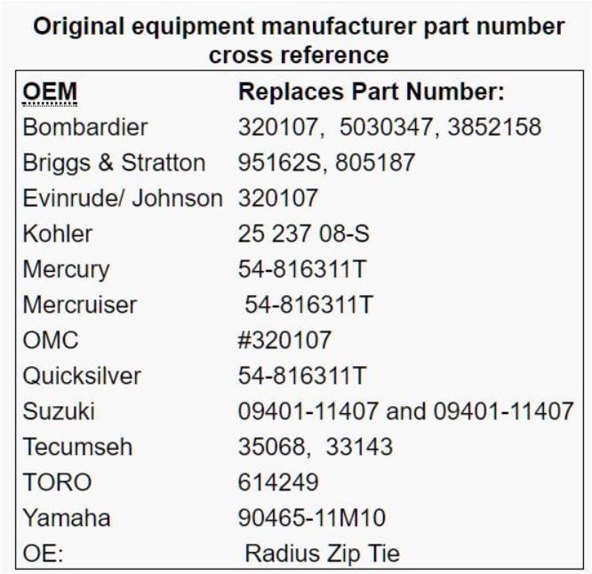

                        Tygon is the way to go and I use it if I don’t have any proper fuel line on hand. Green Line also makes fuel and oil rated clear tubing which works great. To cinch the ends down, you want the tie straps with the curved ends on them. 320107 is the OMC/BRP P/N but here’s a list of other manufacturers part numbers.
