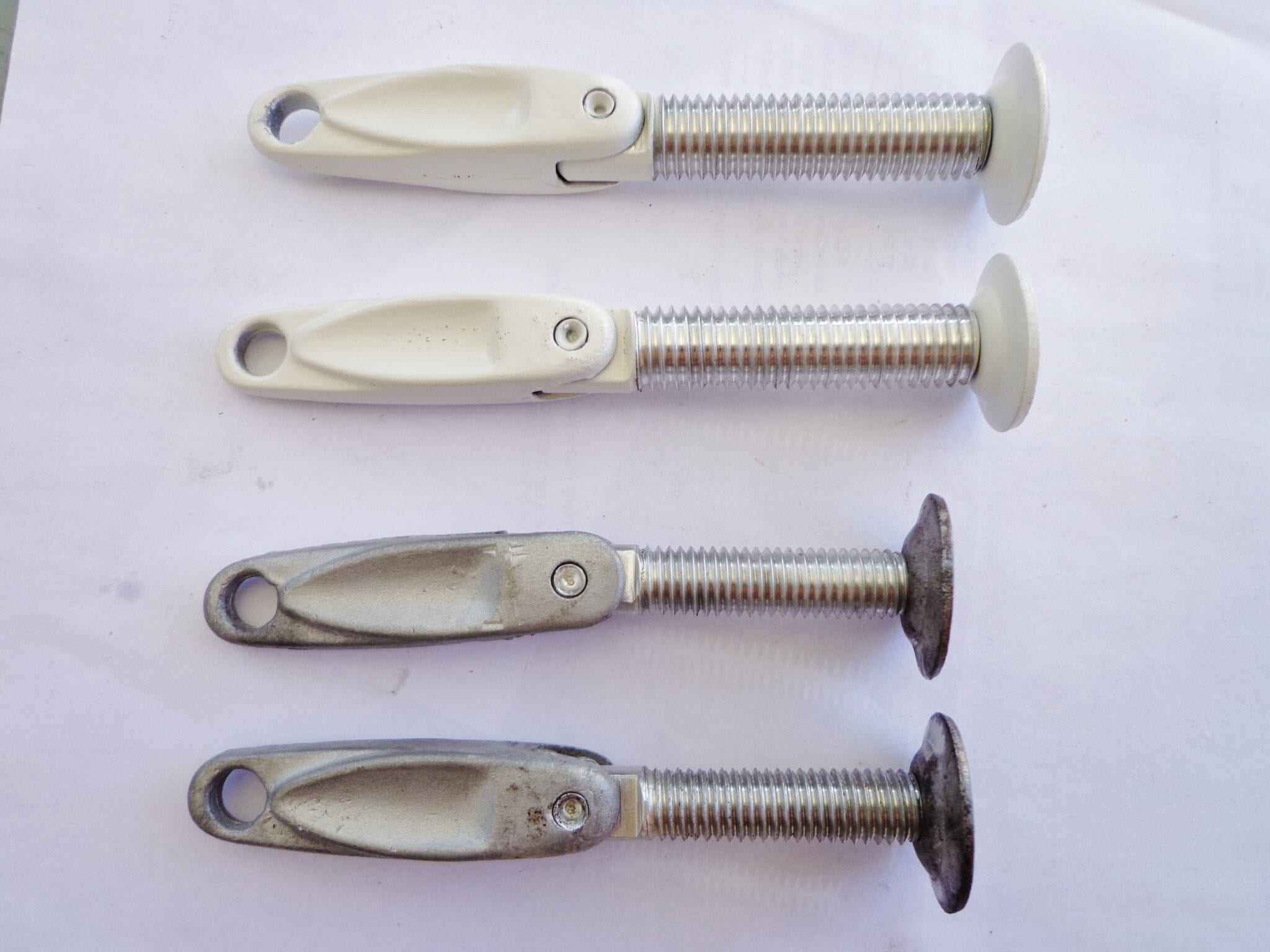

      One of my transom clamp handles on my JW 15 is missing. I do have a spare. Is there any special trick to remove the pin on the transom clamp handle or can it just be punched out? TIA
      Dan
      #238210
        The original aluminum pin has been swaged or peened at the factory so the end will have to be drilled out a bit before driving it out. You don’t want to drill the hole oversize or you might have a problem with the new pin. For pins, I use 3/16″ aluminum rod and center drill the ends before using a center punch to spread the ends a bit. I’ve also used epoxy to hold them in place.
