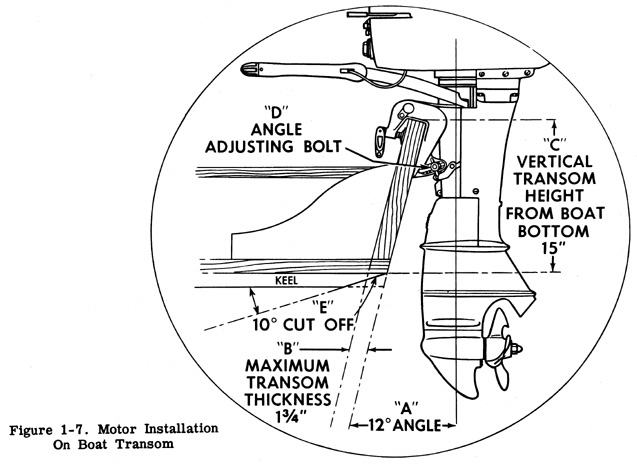

      Absent information for a specific motor,is there a rule of thumb for determining transom height on really old ones?
      #14930
        15in short shaft 20in long shaft.. keep the cavitation plate near the bottom of the boat.
        #14936
          The "standard" transom was at a 12 degree angle so it measures more than the 15 or 20 inches given as standard.
