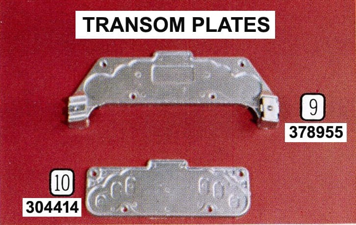

              #196634
                Problem was solved a few hundred moons ago.
                Transom-Plates
                #196674
                  somebody modified my non-registered patent 🙁
