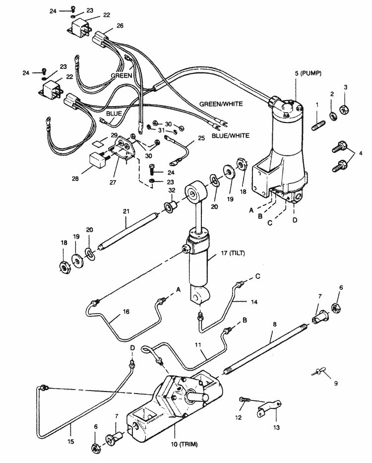

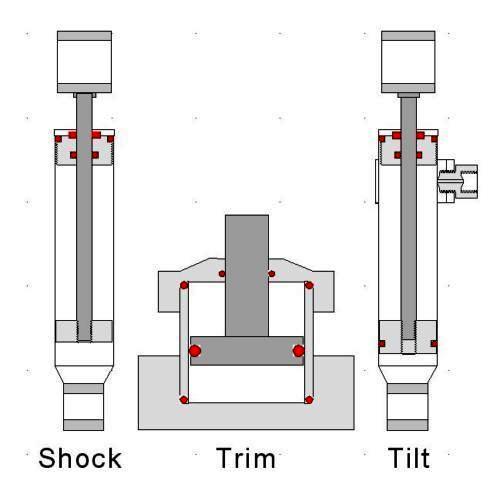

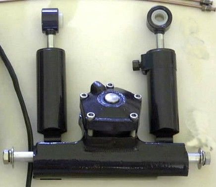

      Having problem with neighbors trim and tilt.
      The trim is ok
      But the tilt has leak down(The engine does go up and down)(no leaks)
      We replaced the O rings
      https://www.ebay.com/itm/Rebuild-kit-Chrysler-Force-Power-Trim-and-Tilt-cylinder-seal-kit-/223084687339?oid=332385204119
      Still has leak down
      Can it be the pump?
      #80986
      kerry
        Been quite a while, but I believe the manifold at the bottom of the pump, where the A-B-C lines are attatched, have O-rings inside. One might be failing.
