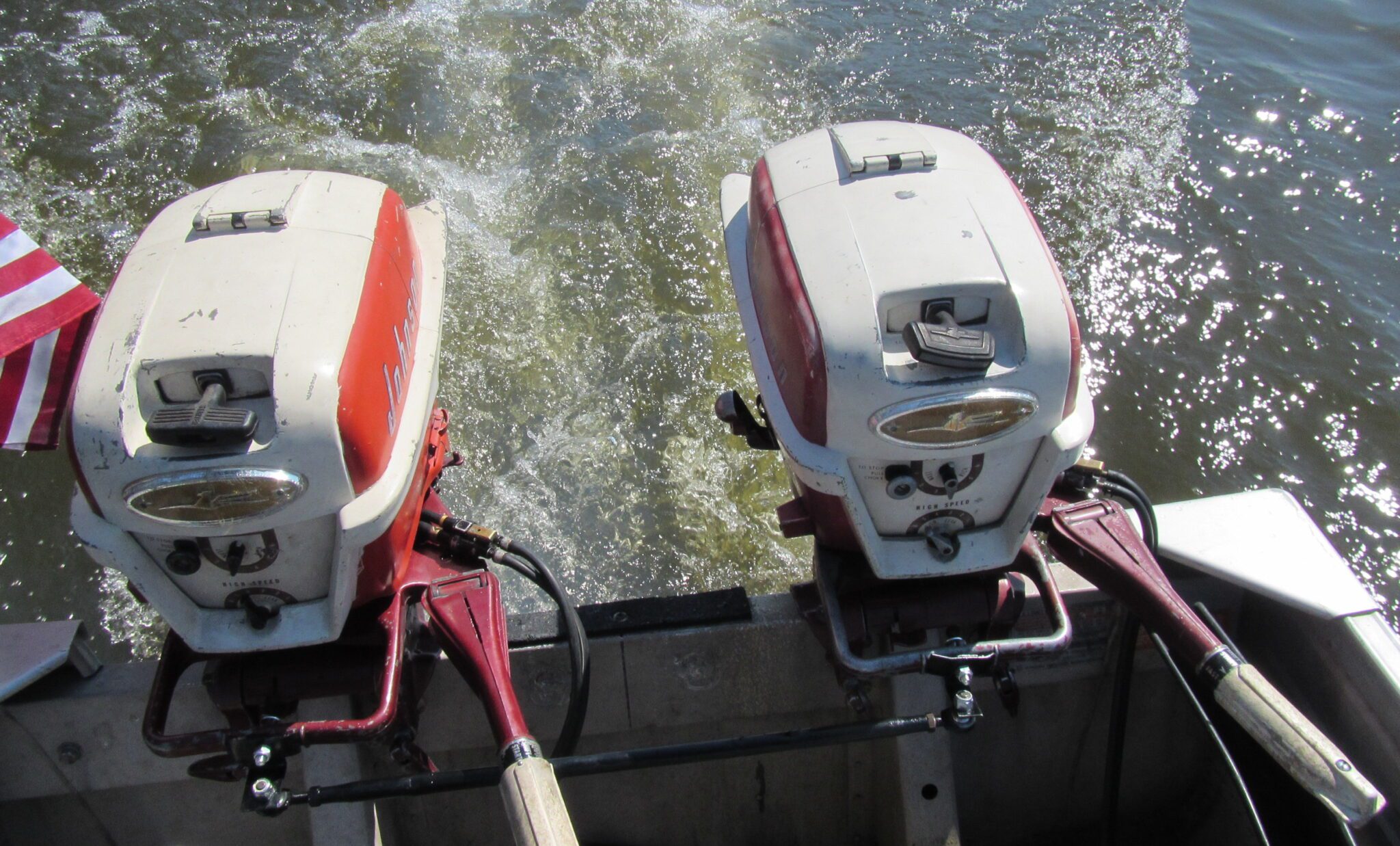

August 10, 2022 at 7:56 pm #264210Here are a couple that were fun to run. It helps to get across the lake a little quicker. Mine is on the port side and the starboard motor belongs to my brother. Really liked running these two little bubblers. Really quiet and they got plenty of attention! They might pull a light weight skier, if they could pop out of the water quick.
dale
file=”IMG_0005-001.JPG”]
