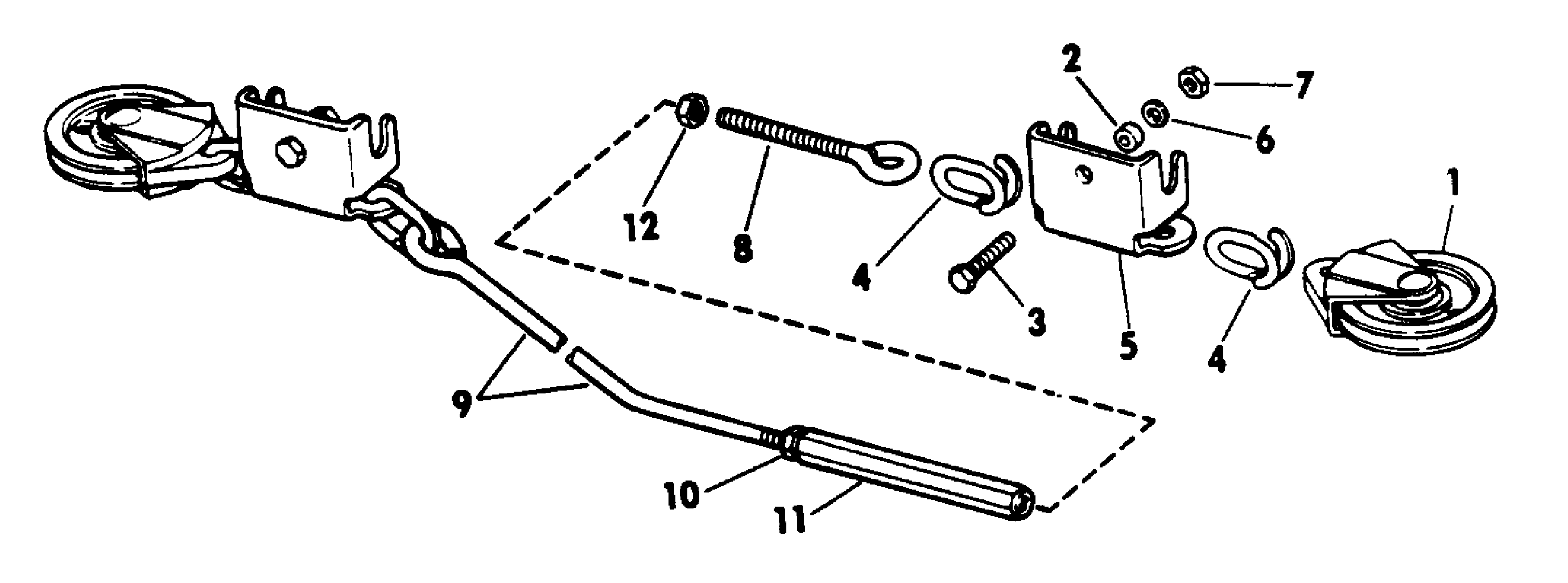

          Anyhow, I’m posting this tie bar kit so you can see the concept. It is for rope and pulley systems so won’t work on your Teleflex push-pull. But notice the bend in the tie bar. That is the secret to allow the moors to tilt individually. Having said that, I gotta tell you that making it work correctly with push-pull will be a nightmare with a single engine, much less with duals. Yeah, you can make it work, but you won’t like it —at least most people won’t. The geometry and rod travel is all wrong.
          Dual-engine-steering-tie-bar-kit
