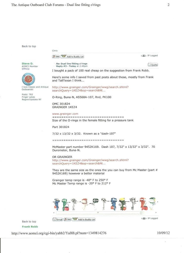

I need to replace the "O" rings on a two line fuel system. I have the old "O" ring removed. It came out in pieces. What is the proper size "O" ring to use as a replacement.
Thanks
John
You will want to buy the real BRP Orings. Do NOT buy the cheapo ones from Sierra. They don’t fit right and tend to leak the day you put them in. Buy these, BRP part # 0301824 Part # 2 in diagram http://www.marineengine.com/newparts/pa … OMC0301824 http://www.marineengine.com/parts/evinr … L-TANK.gif
