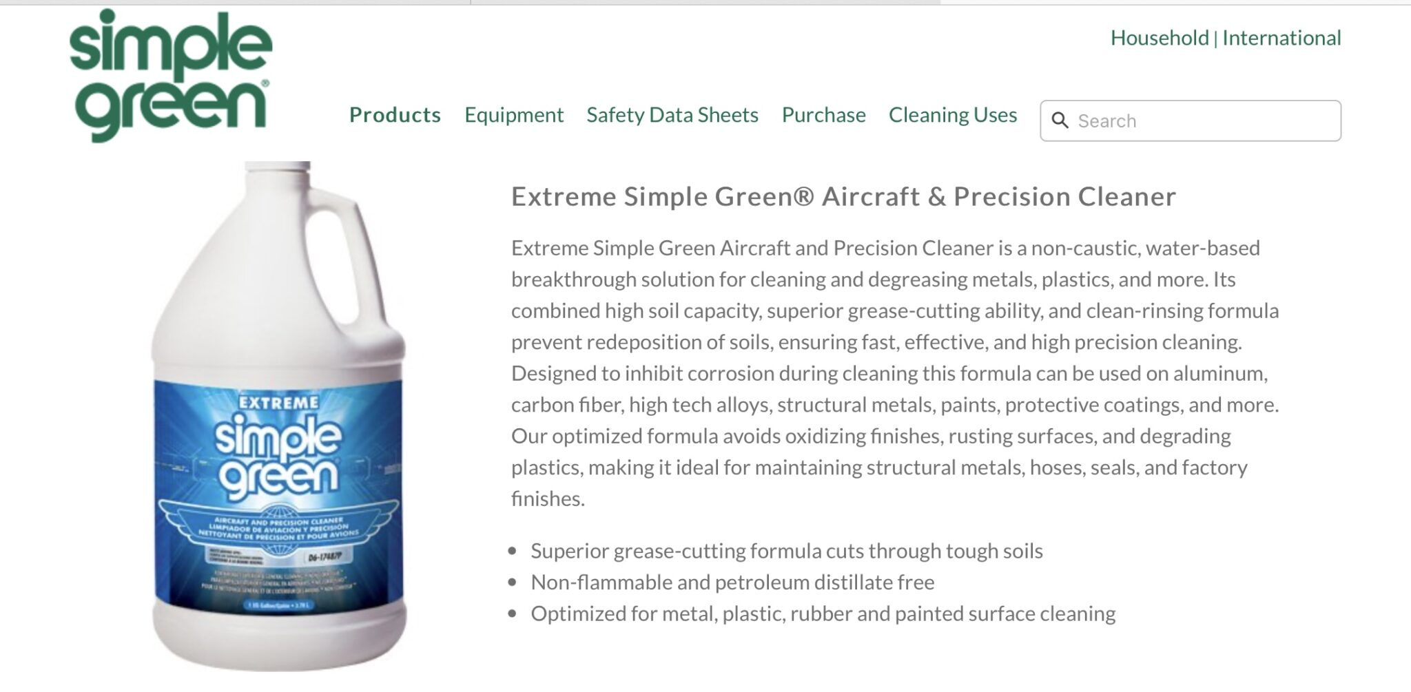

      bob-d
        Randy, this is what I use. Works great. 50/50 with water.
        Bob D

            Rusted Junk
              Extreme Simple Green is all I use, works nicely on carburetors.
              #245690
              Randy in Tampa
                Hey Rusty,
                Just out of curiosity does it remove stains from oxidation on the aluminum? Thanks
                Rotary valve Johnson’s Rule!
                #245757
                Rusted Junk
                  Randy,
                  I don’t think so, it will remove oxidation. The carburetors come out really clean but I would not call it stain free, I mix it 1 part Simple Green to 3 parts water or a little less sometimes. About a 30 minutes in the Ultra Sonic does a nice job.
