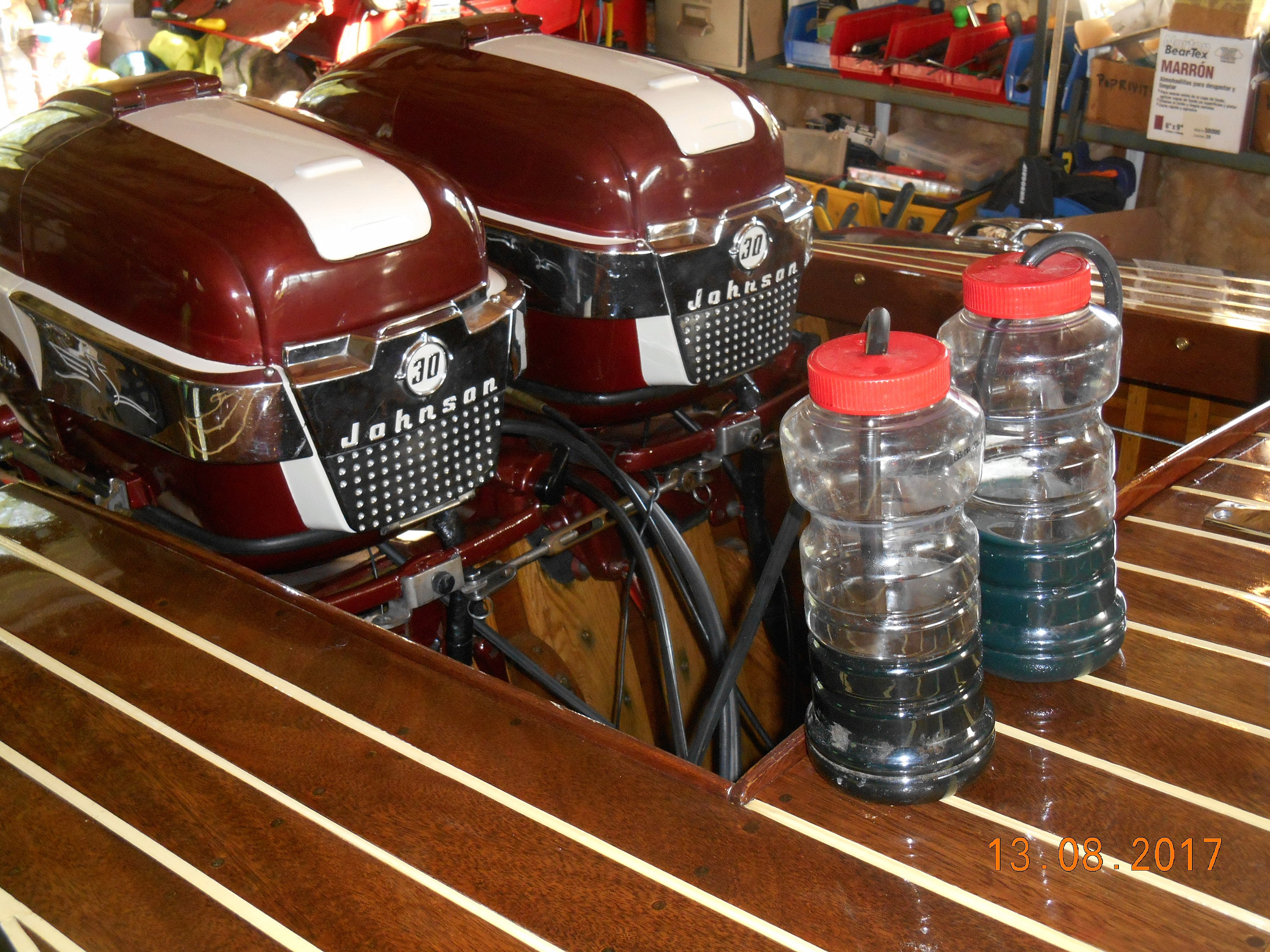

      Last weekend I had the twin Javelins out for a Sunday Cruise an a beautiful day.
      I have rigged up hoses from the case drain covers to these bottles, and blocked the exit into the exhaust stream.
      A sturdier collection container, possibly vented overboard will follow.
      The run was about 1.5h total running time, with a good combination of conditions,
      about 50% slow speed "putting" and the rest at higher RPM. Motors were running very smoothly, starting and stopping at friends docks etc.
      Fuel consumption for the day was about 2.5 gal each.
      I was a bit surprised by the volume collected, about 16 oz for each engine.
      The captured fuel was nice and clear, and looked very re-usable.
      Next run, I will try to keep the RPM’s up a little more, and see how that effects the collection efforts.
      It felt really nice NOT to leave a rainbow sheen when stopping at other peoples docks, and for not spitting fuel into our crystal clear lake.

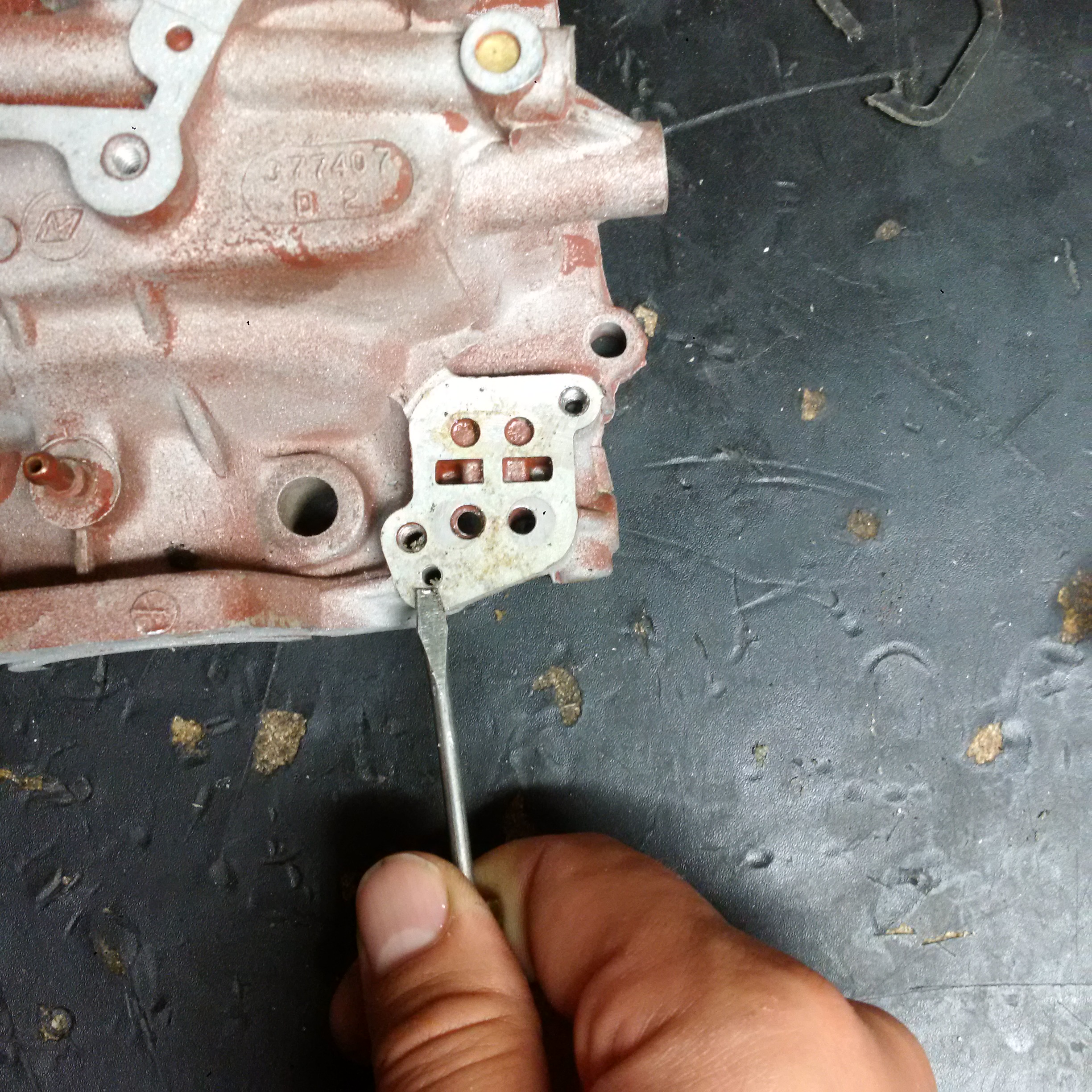

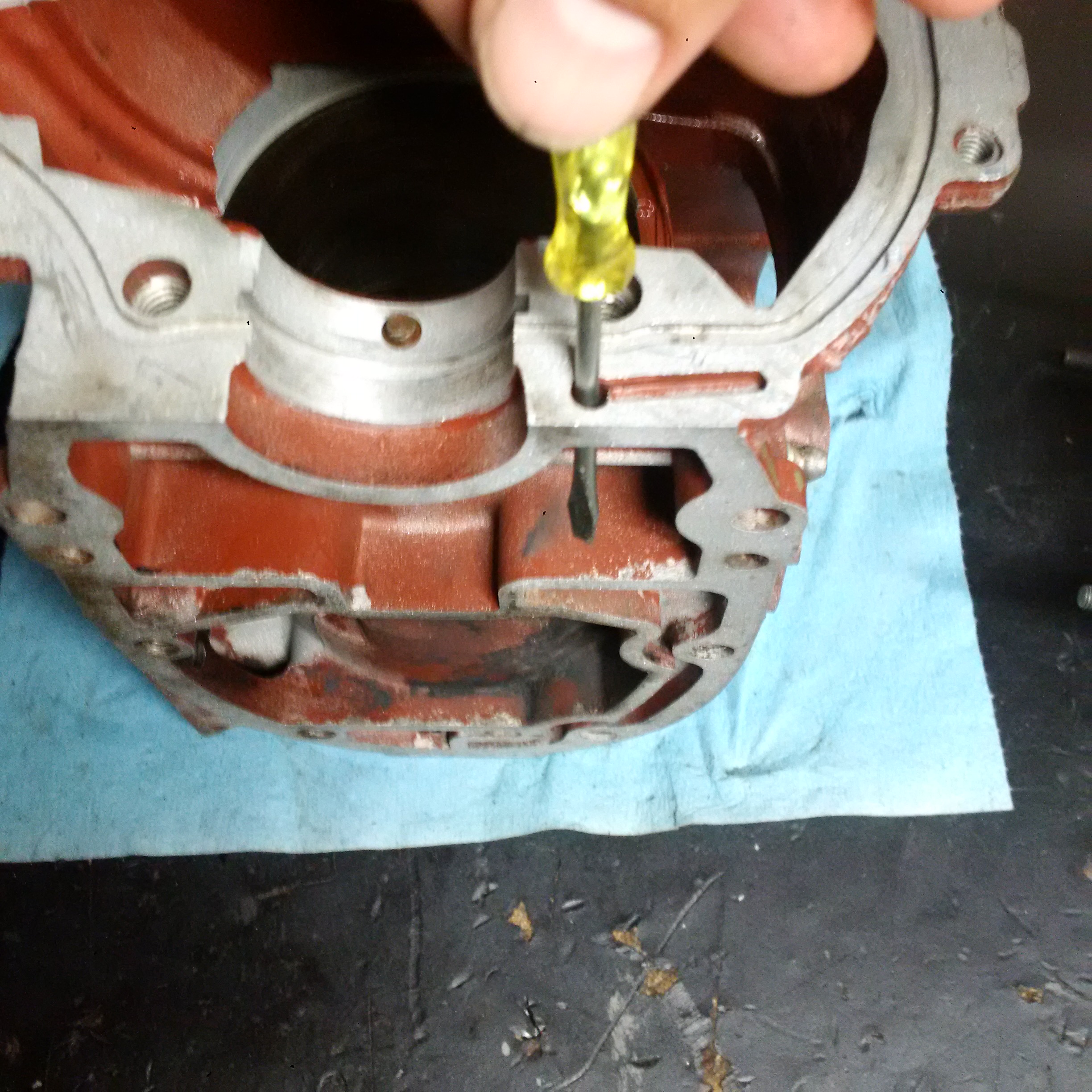

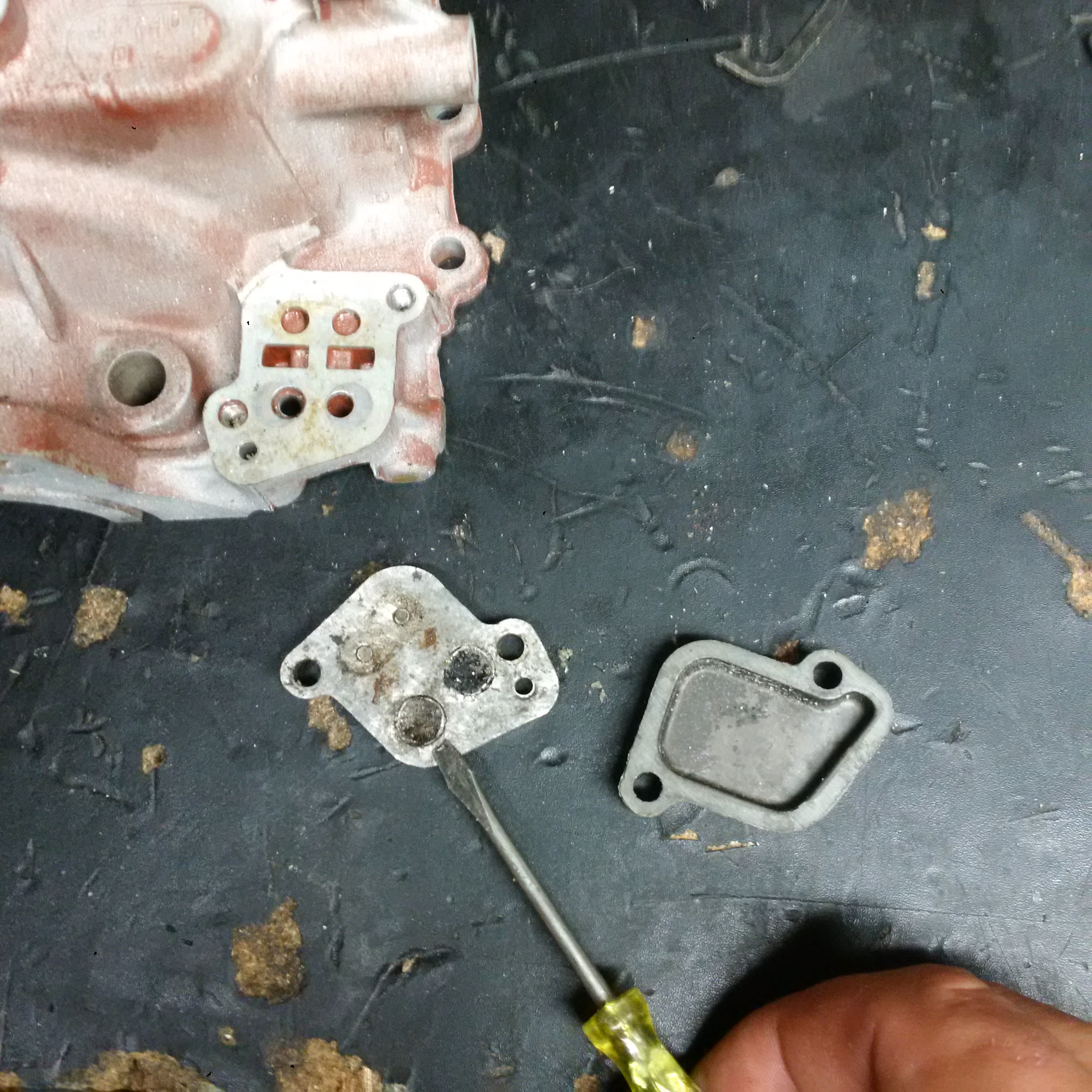

                  I too have done this on many motors for many people.
                  I took pictures on a 40hp powerhead I just rebuilt.
                  Pictures show the cover that you tap and install a barb on, the drain hole you plug up, and the routing that excess fuel/oil mixture normally makes into the mixture of spent cooling water and then into the lake.
                  I don’t get a ton at WOT< but at idle the 35/40hp motors dump quite a bit out of them.
                  I installed a fuel pump on a couple different motors, but kept the 2 line system. The old AIR line I transformed into the new FUEL RETURN line from the barb. I then drilled/tapped a vent system onto the pressure tank. From initial glance, appears completely bone stock. Unless you look closely!

                    chris-p
                      ALso, in my last picture, you can see how badly plugged the screens normally are. Very few mechanics take this apart to clean during a tune up. This should be done every few years or it will start to affect your idle with the puddling fuel/oil mixture that cannot properly drain.
