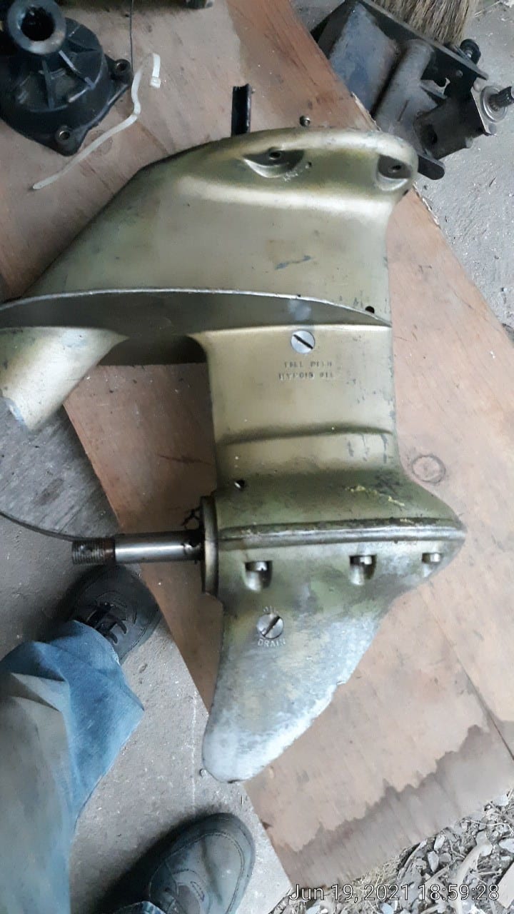

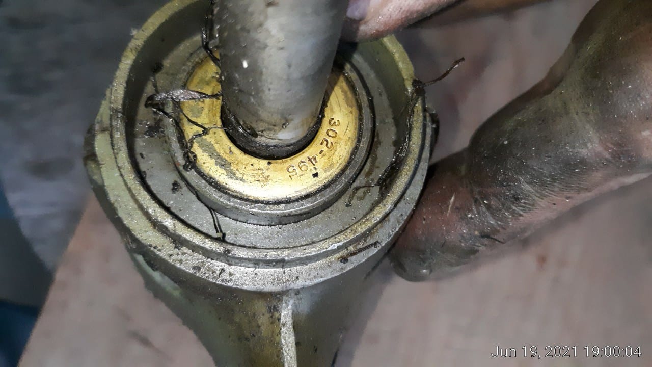

      I found this lower unit in my storage… I think it’s a johnson… the only identifying marks area 302-495 on one of the Seals.
      a quick search of google says 302-495 is a FD-10 S 15hp seal. but It might be in error.
      anyone Thats correct ?

        302495 seals are listed to fit ’51 to early ’57 10-18 horse motors but the gearcase shown looks more like a 5.5 or 7.5 four bolt style one from that era which take a 303345 seal. Maybe the carrier has been modified to accept the seal? Also, what’s that triangle shaped piece sticking out of the shift rod bushing?
        #240770

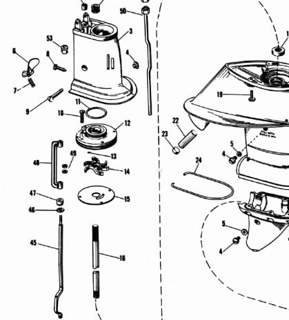

          Shift rod part, Early QD and Fastwins
          qd
          #240774
            Thanks Frank. The shift rod was the giveaway!

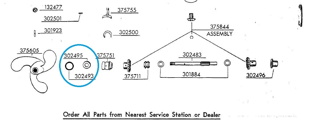

            And here’s that prop shaft seal in the QD-12 QD-13 parts book.
