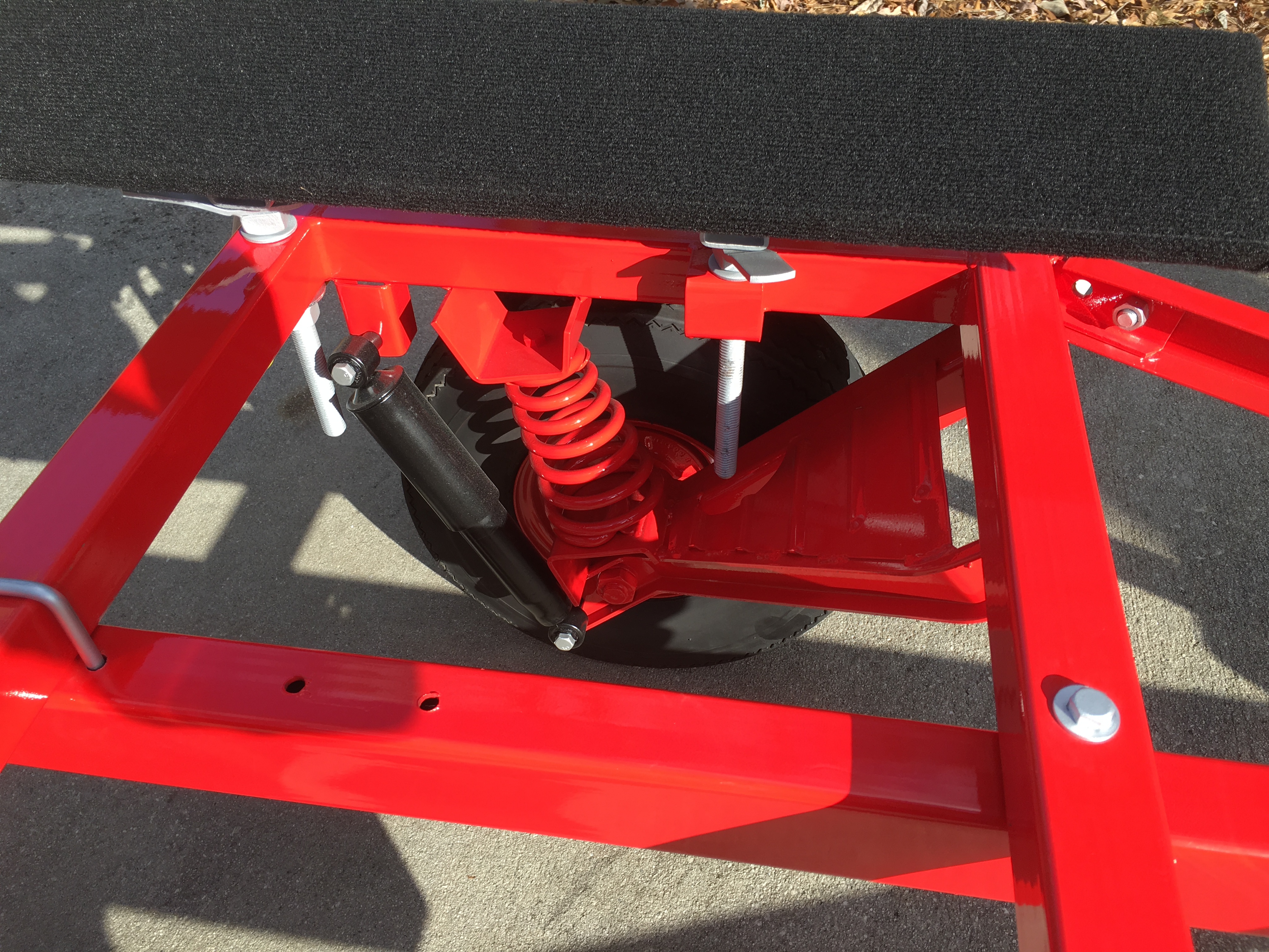

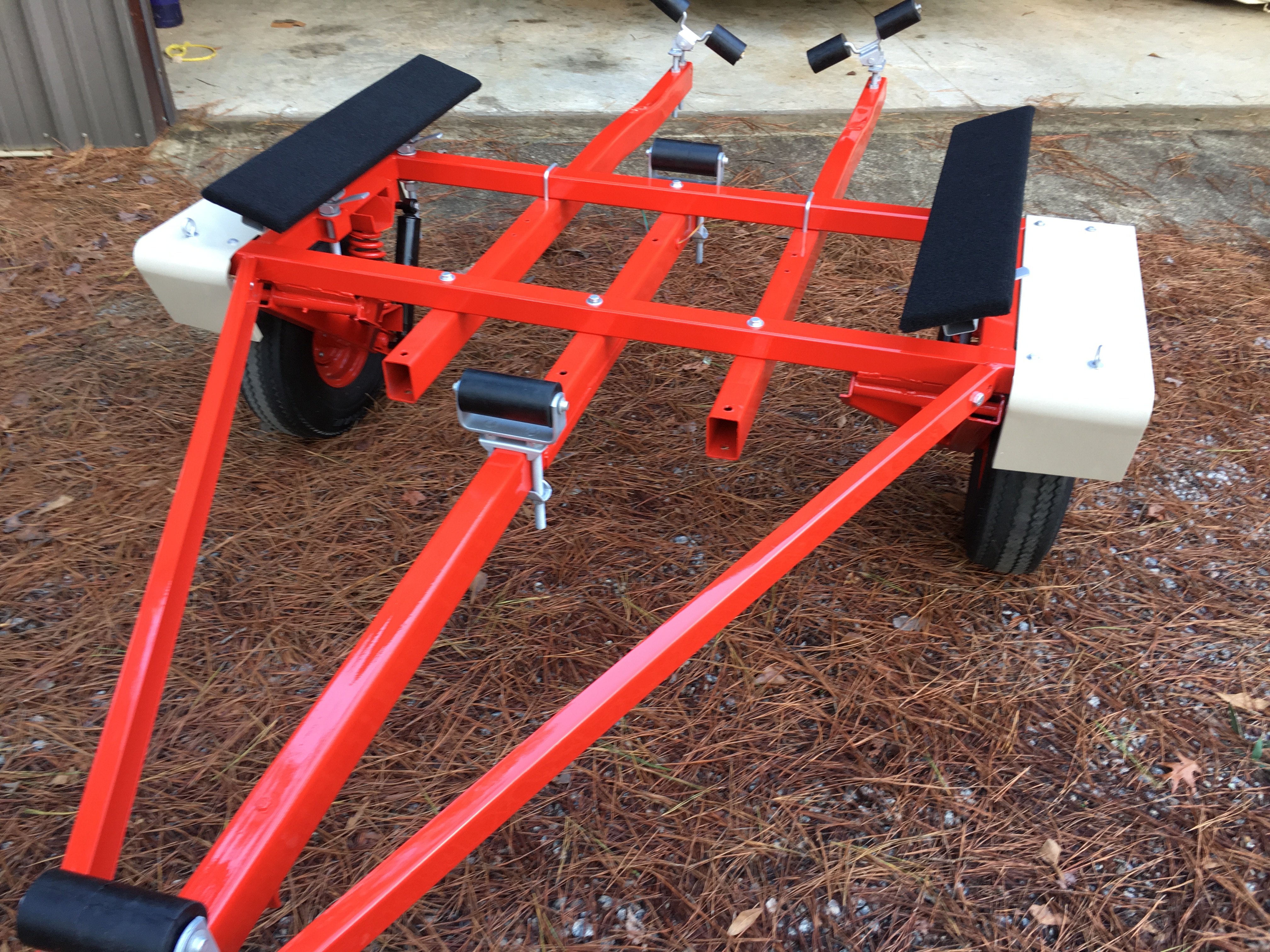

      The pictured trailer carried my 1965 Larson All American 16.6 when I bought the rig. The trailer has a trailing arm suspension with coil springs and shocks. Very impressive. The boat was bought in MI. Can someone tell me the manufacturer? Model number?

            Thanks Guys for your input. I don’t think this is a TeeNee unless someone changed the fenders. Every TeeNee I have seen on line has rounded fenders that look nothing like mine. See picture.

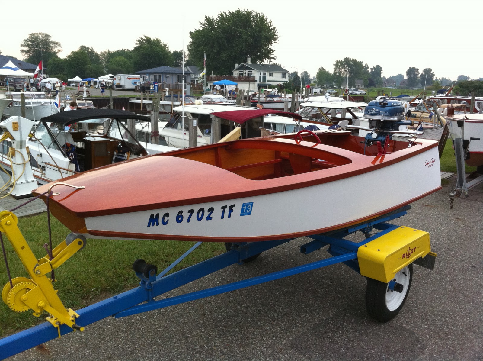

              That boat hauler is a CrisCraft kit trailer. I think they called it Anchor or Aloy. Do a search for CrisCraft boat trailer and you will find one. I wanted to post a picture but my computer abilities are not so good today!
