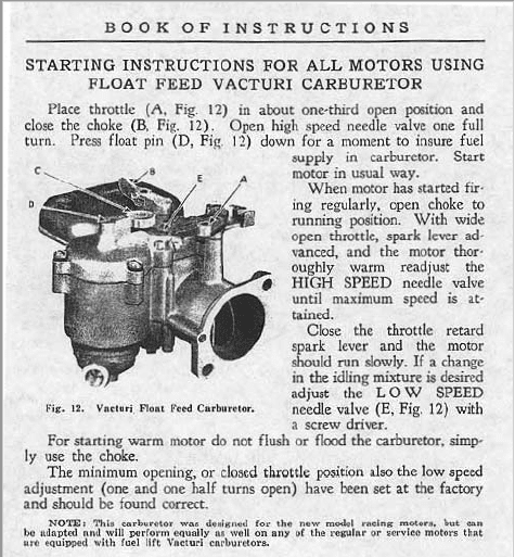

              WAYNE
                Vacturi 500 was designed for the Johnson race motors. Its a little newer than the Vacturi Lincoln described in his excellent video. Here is what the Johnson service manual has to say about the Vacturi 500.
                Vacturi-500
                Wayne

                    smokeonthewater
                      Thanks for the carb settings, Wayne!
                      It seems I am getting somewhere now.
                      The motor now starts quickly on choke, and runs, but seems to bog after I open the choke and then throttle. At least I’m not seeing a tidal wave of fuel Anymore when it shuts off.
                      It almost acts as if it is / was starving and flooding at the same time as a result of using the choke. It seems the choke can really draw some fuel!!
