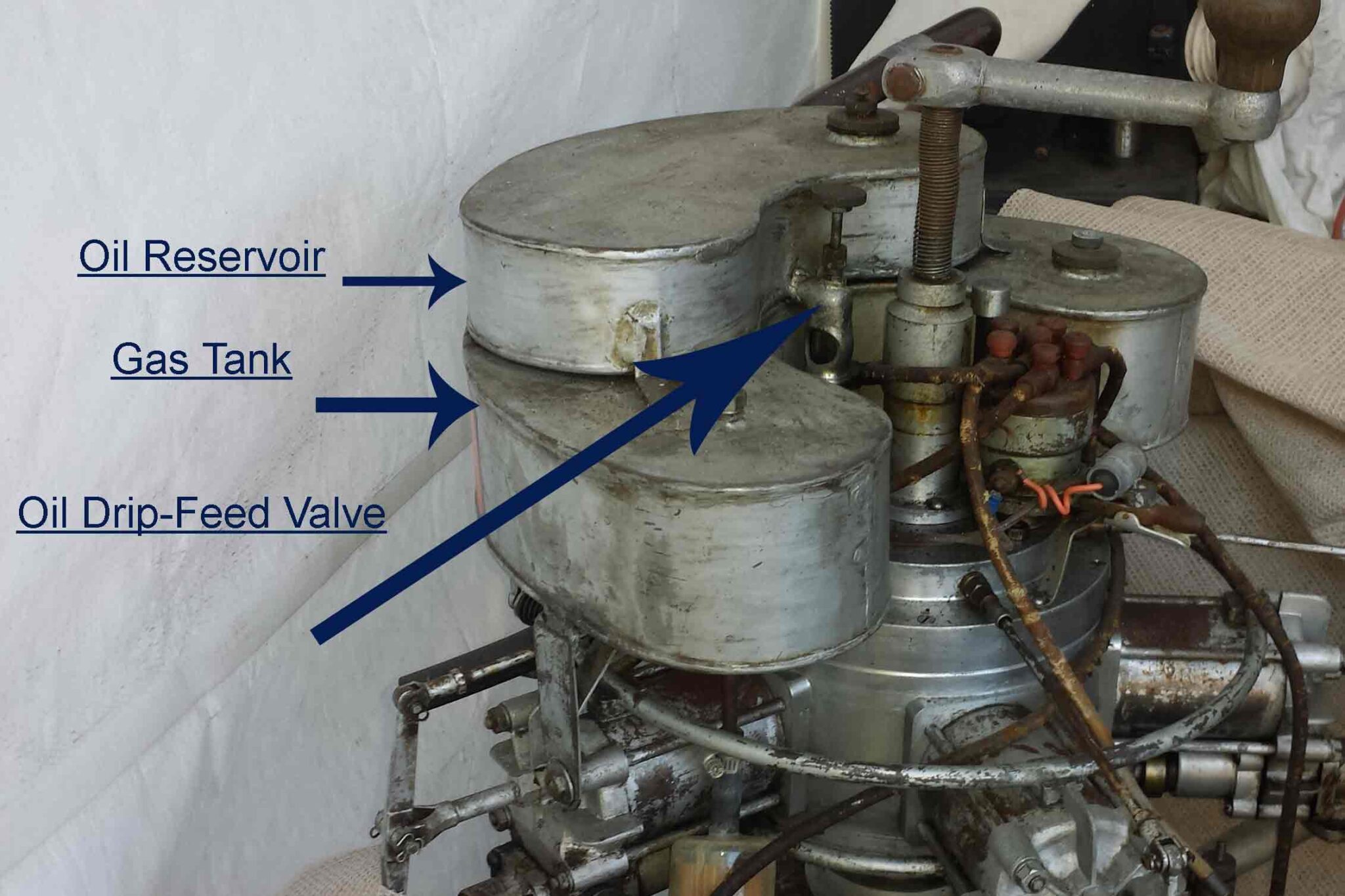

                  I wonder how they lubricate these motors. Is there an oil pump or would they mix oil in the fuel?
                  #252855
                  CHUCK
                    This engine uses a drip-feed directly into the crankcase. in addition to oil in the fuel.
                    Oil-System
