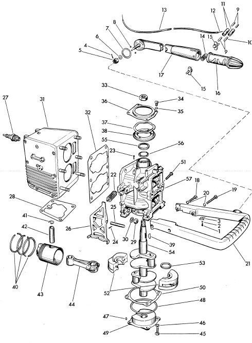

              #23642
                Here’s an exploded view of a 12D10 powerhead and you can see the one piece cylinder and head is wedge shaped. The later models were a totally different design and had a removable cylinder head.
                #23655
                1957evinrude
                  Yes I can see much different than mine. My engine is very similar to the 15 and the 18s even the l/u is seems Identical to the 18. Maybe they would interchange. Very interesting.
